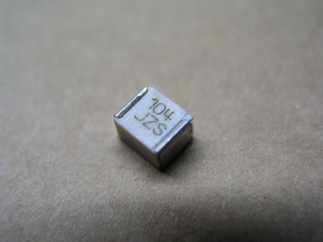

Hi all,
let me share a little opinions.
I also design PCB for diyer kits.
recently I collect some capacitors sample for the supplier.
I had only 100pcs on hand but I test very good.
pls take a look for the decouple cap for my kits.
my PCB.
http://www.diyaudio.com/forums/showthread.php?s=&postid=437051#post437051
this is the spec of the new sample decouple caps.
very good in digital interface use.
http://www.evox-rifa.com/cap_catalog/smdfilmc/smc.pdf
photos of the cap.
thanks
thomas
