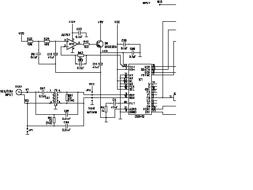

Hi All
Forgive my ignorance [yet again
], I have a couple of further questions.
Regarding decoupling caps on the 8412 etc.
The data sheet shows .1uf yet i often see some quite large[single] values used in its place.
Another question regarding ldo reg cap values.[I suppose
this is related in that the cap value effects both devices]
I have been investigating regs [especially those that are BIGGER than a grain of rice😡
] , for example Burr Brown Reg 103.
The data sheet states:
"None of the versions require an output capacitor for regulator
stability. The REG103 will accept any output capacitor
type less than 1µF. For capacitance values larger than 1µF,
the effective ESR should be greater than 0.1Ω. This minimum
ESR value includes parasitics such as printed circuit
board traces, solder joints, and sockets. A minimum 0.1µF
low ESR capacitor connected to the input supply voltage is
recommended."
Mmm ..how does one go about using such a device if the device it is supplying requires or benefits from a higher value[low esr type] cap?
I don't understand what your trying to say!
Check out the attachment
Hi jewilson
I can't even explain what I don't know correctly
I think I meant to say something like:
If I wished to use the mentioned regulator ,that I would be
unable to use it to supply my devices if I intend to use a bypass
cap that has a low esr with a value over 1uf, or instability could result.
Types such as OSCONs, Black Gates etc.?
Is the above the correct interpretation of below?
