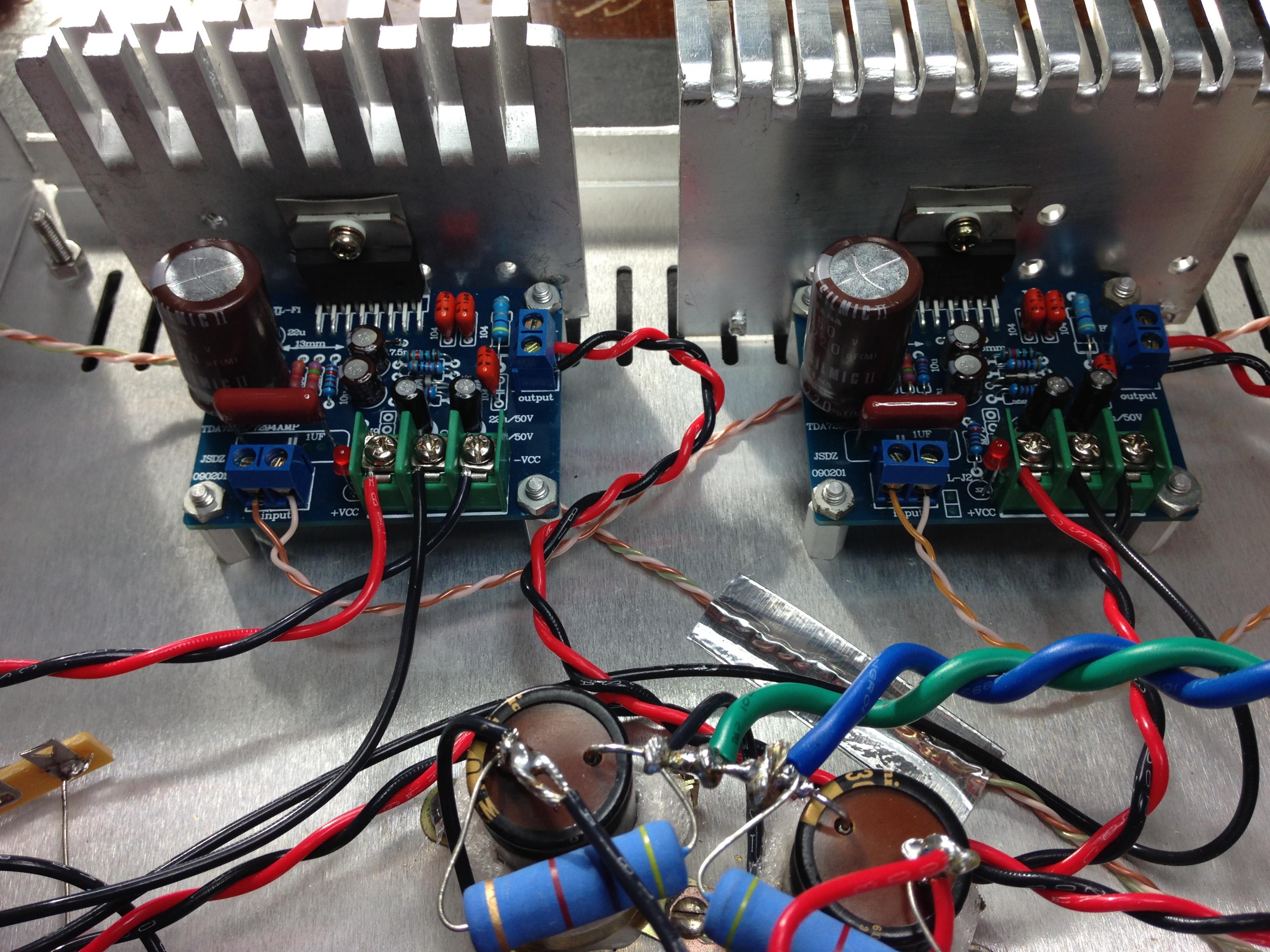

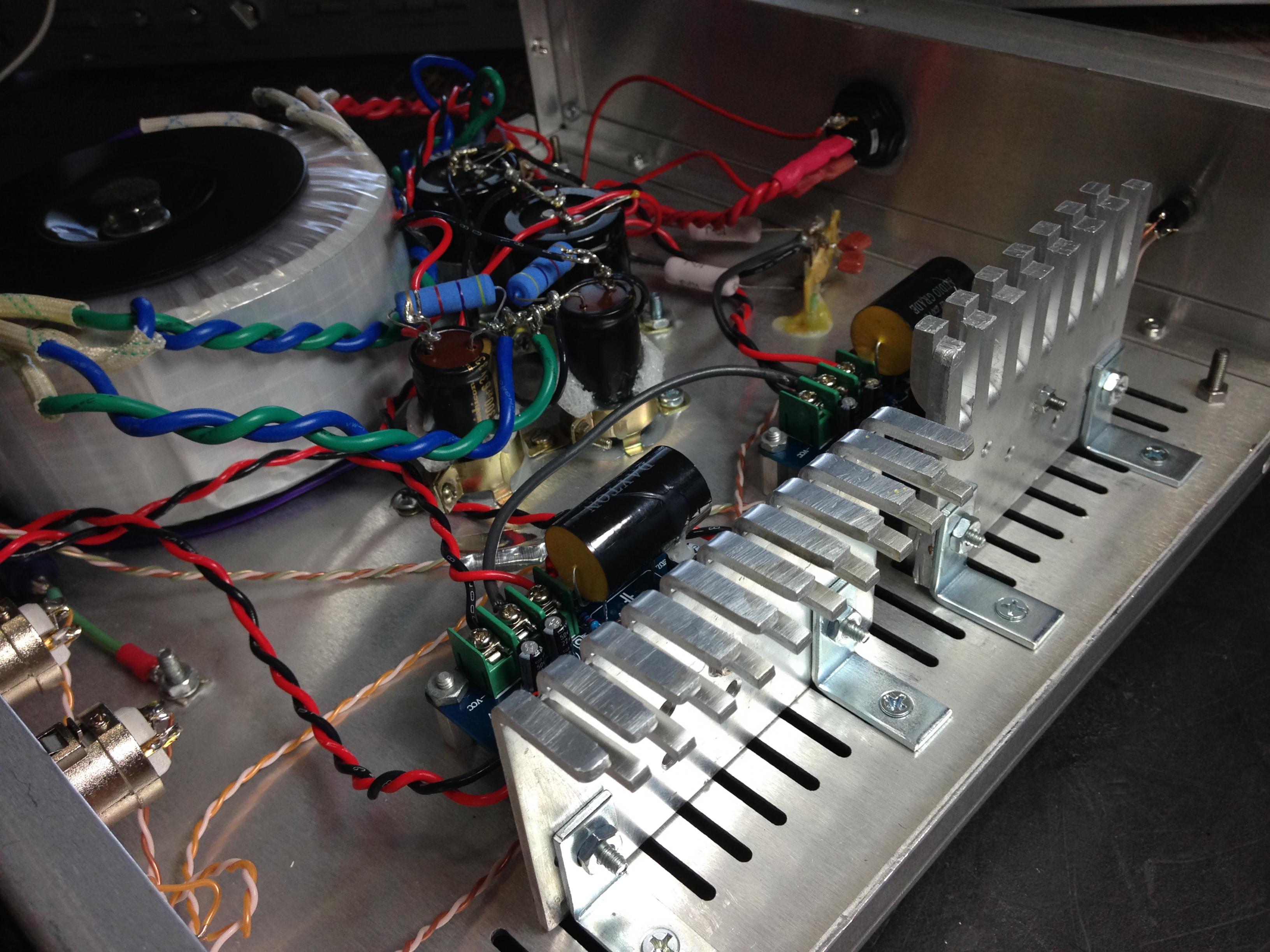

Finished TDA7294 number two. I did try the 1 uF input caps, and I only had Elna Silmic II in this rating and it sounded closed-in at the top. The Panasonic .47 uF Polypropylene went in as replacements and things opened up really nice. The bass is better than number one due to the beefier power supply. The 300VA transformer vaporized the 3 amp fuse I started with, even with an inrush current limiter in place. The power supply is derived from a carlosfm design. ...still need to clean up the wiring.

a 115Vac 300VA would probably need a T8A to start reliably direct online.
With a T3A you would need ~19r as the current limiter in the soft start.
It may even start on a T2.5A with that 18r to 20r of limiter and operate normally after it is bypassed.
see if you can run the "ground" wire from amp PCB to PCB via a short thick wire/strip.
The shorter the lower the inductance.
The thicker the lower the resistance.
A wide strip has lower inductance than a thick wire or group of wires.
Remember the flat wide "earth" straps often used to earth the automobile engine? H.Ott shows pics of something similar when "earthing" separate chassis to each other, specifically for this minimum impedance issue.
Each amp PCB needs to see minimum impedance to it's Main Audio Ground. This minimises the voltage drops for any shared currents using that common route.
a short low-z path also reduces EMI pickup since it is less of a "good" antenna.
another good EMI reduction practice is to keep low level signal lines away from other lines and when they must get near then have them cross at right angles or as nearly so as practicable.

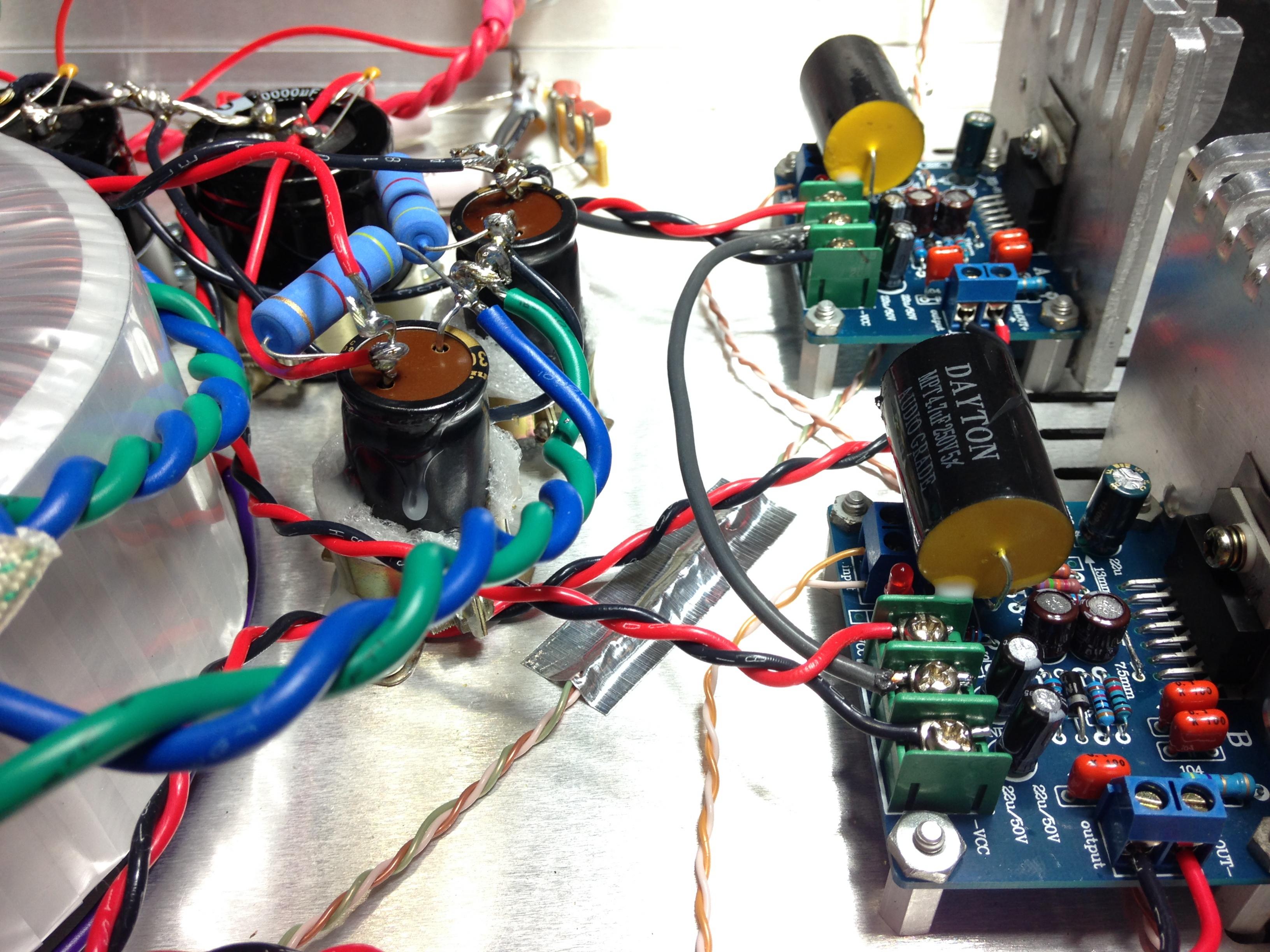

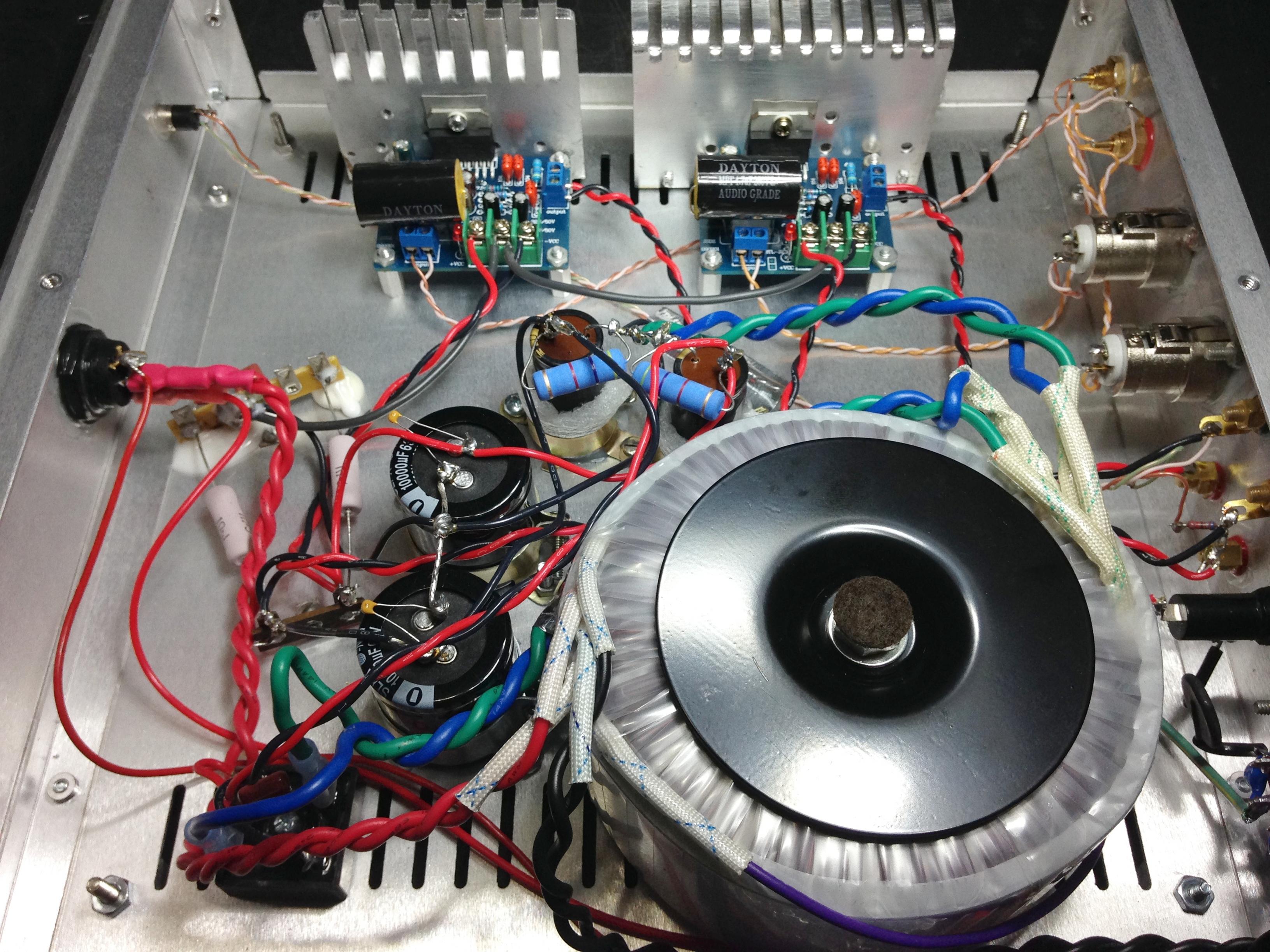

OK, here is the power supply wiring pictured, maybe it will make more sense. The ground taps are at the end of the PSU components, not sure if I should change anything,...? So far zero noise of any kind. Also, it is all silver in Teflon wire, so should be low resistance. I also have the standard radio filters on the AC line IEC connector (X/Y class caps).

For 0v and grounding purposes, perhaps it would be good to buy some green insulated wire with solid copper conductor inside?
I am game if it makes a difference, I do have some laying around. What is in there now is multi-strand silver plated copper, about 18 AWG Teflon insulated.

FWIW i use a 3.3 panasonic poly or 5.6 uf solen on the input, mounting them and the input jacks inside a small dedicated die cast aluminum box. without the box their physical size makes for some noise pickup.
that said, those long circuitous 0v and rail leads may be a culprit.
the silver may give you low R but not low-z (i think that is the basis for the suggestions from andrew and daniel).
for a board-mounted chip i'd generally shoot for a max of 3 inches total from the chip power pins to a large reservoir (10,000 uf or more per chip per rail) and a total path between the reservoir and the trafo (including the bridge) of 4 inches.
with careful layout this is doable by removing cap height as a factor -- horizontal cap mounting on the floor of the cabinet. with point-to-point, even shorter paths are doable.
you may or may not hear a difference depending on the music and the speakers. with good speakers the lowest octave of a 5-string or 6-string bass is to me _very_ noticeably better with the lowest notes clearly retaining string character rather than sounding more like a drum. to me it is worth the trouble but to others it may not be worthwhile.

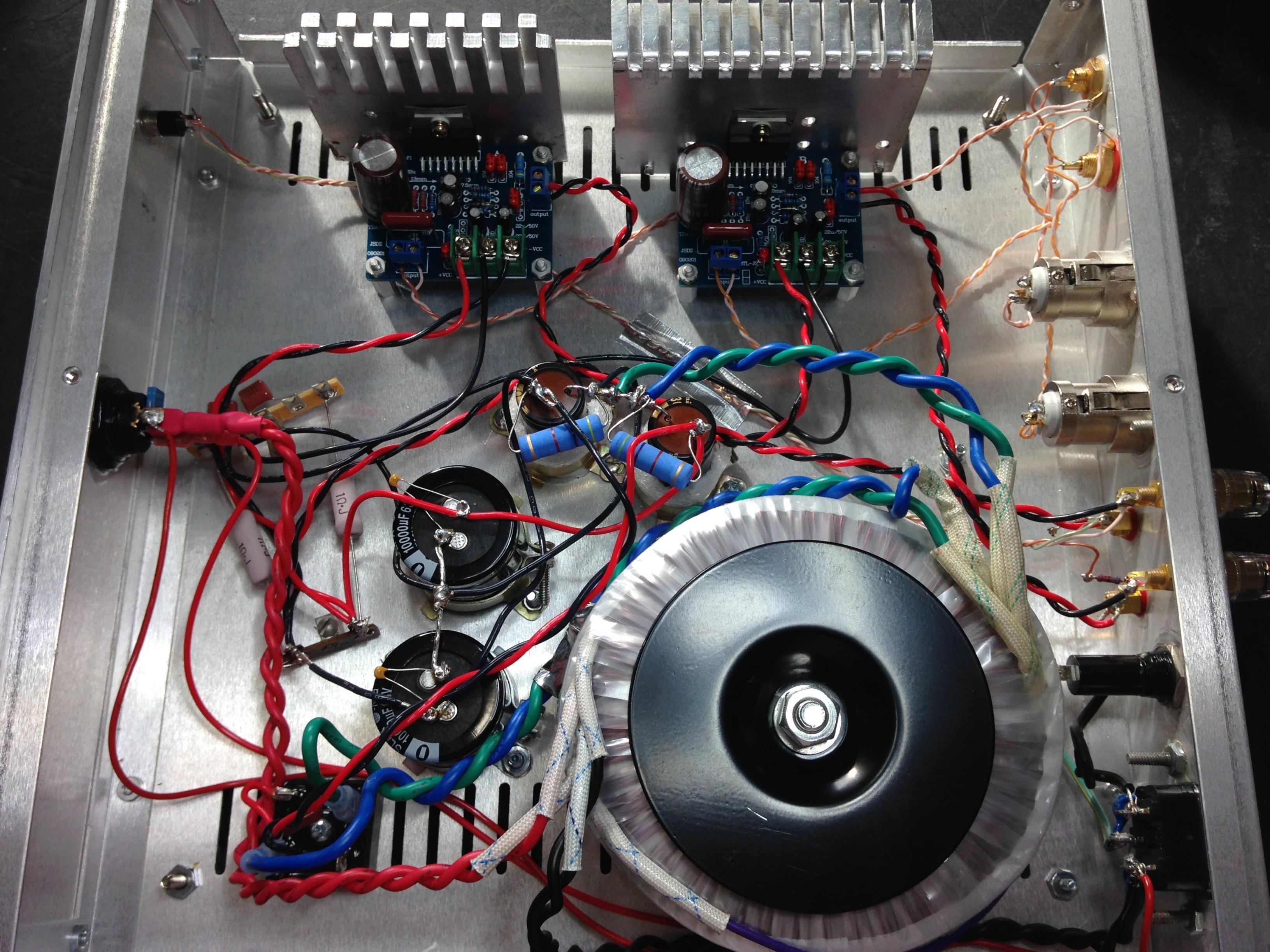

I had some solid core copper dark gray insulation, so that went in. You can see it there as the 0V feeding the boards.
Try 10uf for input and 100uf for feedback for more bass. 😉
A 4.7 uF and 100 uF FB cap went it. The 100 uF was necessary to make space for the bigger polys. Yes, more bass!
FWIW i use a 3.3 panasonic poly or 5.6 uf solen on the input...shoot for a max of 3 inches total from the chip power pins to a large reservoir (10,000 uf or more per chip per rail) and a total path between the reservoir and the trafo (including the bridge) of 4 inches...
4.7 uF poly went it, these are Dayton Audio, a good general cap. Also, shortened all wires.

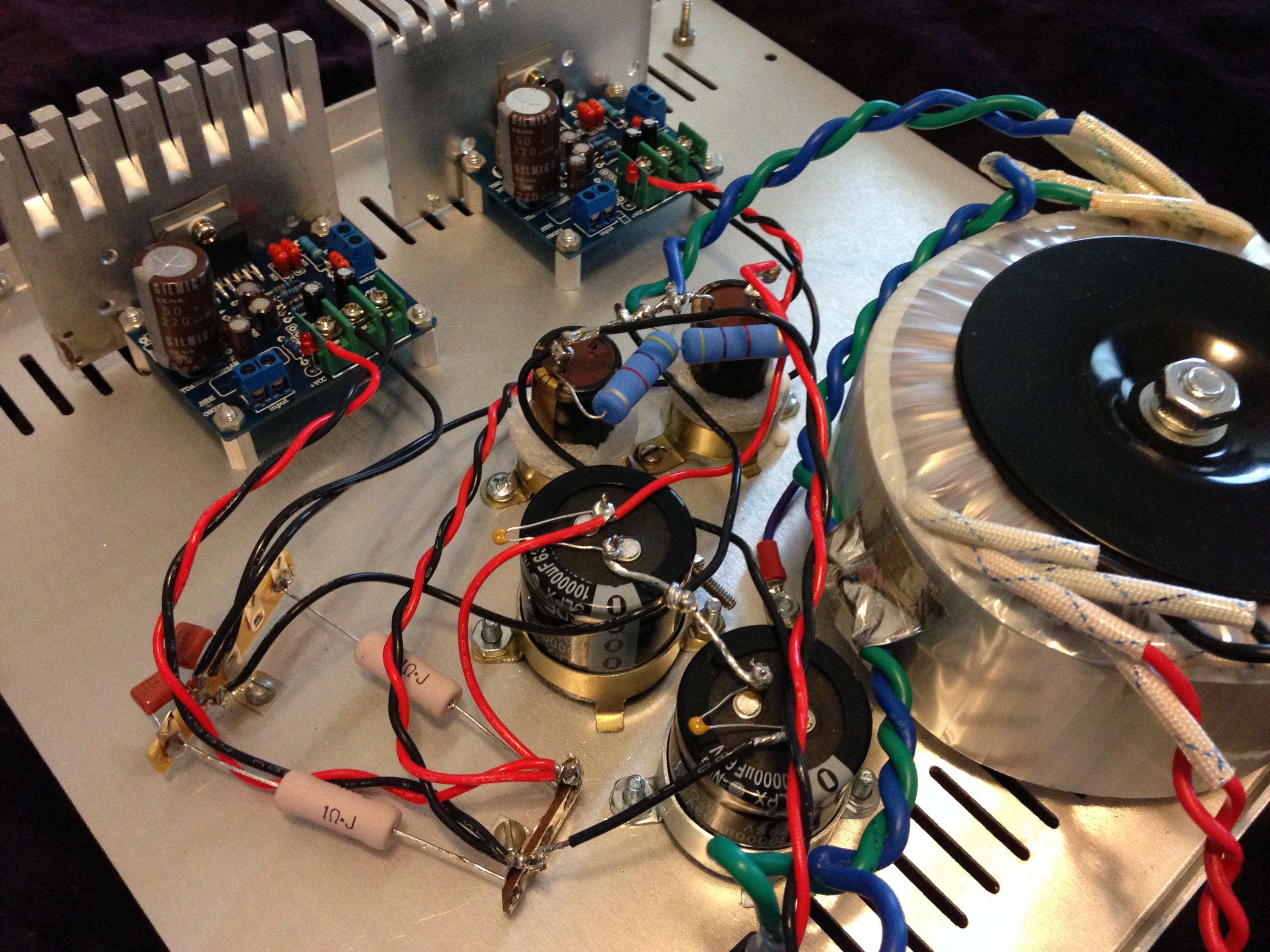

Appreciate all the input, I did not get to test it much yesterday, but so far there is definitely more bass coming through. I will test it later and report.

Did more listening with a friend over the weekend, and he agreed this is a very good amp. It is providing great bass, deep and low, and the highs are crystal clear with lots of extension. I know some will argue, but this amp would easily humble my gainclone and my other tripaths for that matter.
and they are too small anyway, you would probably be better off bolting those TDA to the case/chassis for heat transfer
I did just that, even though with my speakers, the heatsinks barely get warm.
Thanks for all the suggestions, this amp is a winner.
