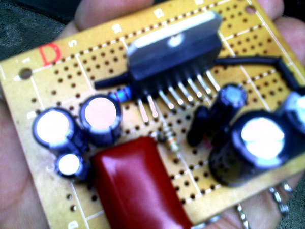

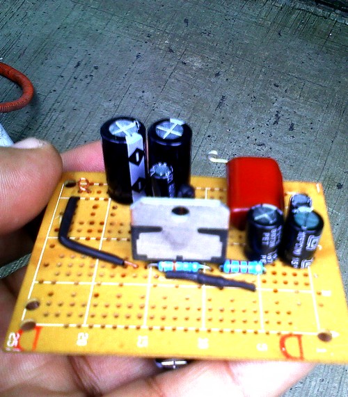

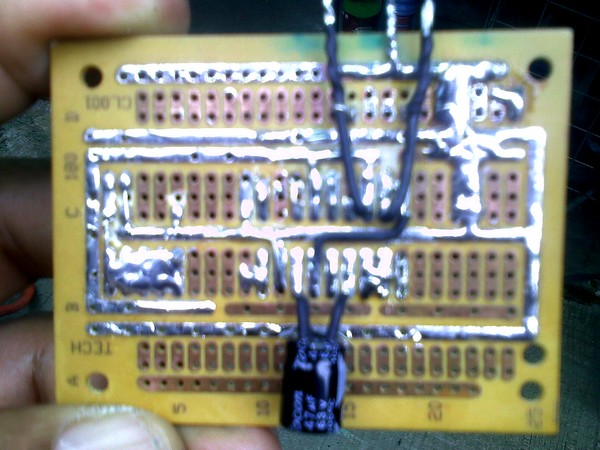

got another fake!
😡 made this , with fbstring : 68k - 2k2-100u100u047u ; 1uf input cap, 47uf bootstrap, 220uf power cap and 38 V rails unloaded, i tested with lamps in series it was ok then without...
😎 it just made a tiny snap, like a match or something... and died!
its the second with 7293

These chips explode immediately if the bootstrap cap is backwards or a bad cap. Might want to give that thing a quick checkup before powering on. Or the easy way--a 33u Nichicon ES, which is good quality and never backwards.
i had one board with a sam young (yellow) bootstrap cap. the cap was installed correctly. it exploded (sizzling sound, then BOOM) after a few minutes use at +/-25VDC rails. replaced it with a panasonic FC. the amp resumed working for a few days and then failed entirely. so my takeaway from that is in the event of a bootstrap cap failure one may expect to experience immediate chip failure as Daniel did or a chip failure later as happened to me.
A different possibility is a faltered/failed mute diode, which would then allow the large signal to turn on before the small signal for instant exploded amp.
