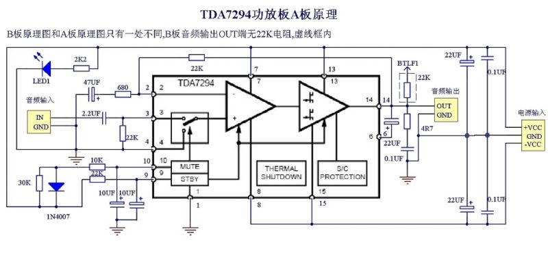

The theme of this thread will be adjustments and modifications necessary to take advantage of and optimize the performance of the LM7294 device. The base or starting point will be the following schematic:
Due to a wide range of technical understanding, very basic definitions and descriptions of both primary and supporting components should be posted. Hopefully, this "Paint by the numbers" approach will attract and inform both novices like myself as well as those who wish to share their advanced knowledge and experience.
I'll start by taking advantage of a post by Daniel W. in response to a basic TDA7294 kit build. We can extract several items for definition and example with the goal of getting everyone on the same page.
Quote:
Originally Posted by danielwritesbac
Well, that's actually a really good result for a basic kit in stock condition. Both the gain and the feedback current may be a bit high and the NFB cap and bootstrap may be a bit small. That combination causes it to miss the highest highs and lowest lows, but that is what the datasheet example schematic does.
Try the bootstrap cap directly at 47u for slightly more low bass.
(some newer schematics show 47u)
And, try the NFB cap at least as large as 220u (or bigger)--Also try some tiny value polyester caps and/or electrolytic of 0.47uf or less, as bypass caps parallel with your NFB cap.
Then the lowest lows and highest highs should be working.
(the schematic shows 22u, which is a bass blocker)
Also for low bass this amplifier appreciates a large power supply reservoir capacitance, not located on same board as amplifier.
If it still does some midfi behavior, the gain might be set too high, since it doesn't really have enough gain capacity for a 70w amplifier. The quality drops if the gain is too high. If you want hi-fi, I think you want low gain power amp pushed by a preamp.
The feedback current might be too high due to feedback-shunt and feedback resistor values too small, which also causes fragility and current noise of overloading the small signal section beyond linearity.
To make a reasonable compromise, you could set the feedback-shunt resistor to 2k2 and the feedback resistor to 56k (or even 68k if going without a preamp). Nearby values make really similar results. This ballpark is a good spot to start exploring. That example is off a bit, but not nearly as far as the datasheet schematic.
Before using the amplifier in bridge mode, I'd like to see it running quite happily clear and definitely running cool temps. The operating voltage for bridge mode is with a 20+20vac transformer (max). So, if you're going higher than that, do consider output caps or speaker protector kit. I did test those baby latfets to 127 watts before I ran out of transformer, but I was using speaker protection, just in case.
So lets see if these can be explained and hopefully detailed on the schematic. I am contacting a vendor of a PCB of this type for permission to use a photo of one of his products on the thread.
1. NFB cap
2. Bootstrap Cap
3. Bypass caps
4. Large power supply reservoir
5. Feedback-shunt
6. Feedback resistor
7. Bridge mode
8. Output caps
9. Speaker protector kit
If links to other posted material on the DiyAudio forum and/or other sources is advised, that should be perfectly acceptable. Each of these items is complex and can occupy volumes to fully understand. Hopefully the information can be distilled down to just what is necessary for this project walk-through.

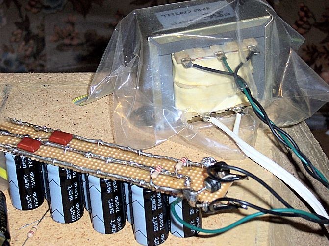

For low ripple performance, va=watts*3
Okay a stereo build, say 65 watts and 2 channels = 130 watts
130*3 = 390va
Ah, but the chip does have a softened clipper built in which reduces the actual requirement to 300va for a stereo build.
However, if 200va, then you'd need a bit larger capacitance. No problem. This doesn't require a weird prefabricated printed circuit board. Here's some photos that show how to do your own power supply quite easily, on phenolic perfboard. The real example, is actually running a TDA7294 amplifier.

Daniel,
Wouldn't the cap bank be ALMOST as easy to construct using an unetched double-sided PCB for each polarity, a la Terry Given? It should then have much lower impedance, right? Or am I missing something?
