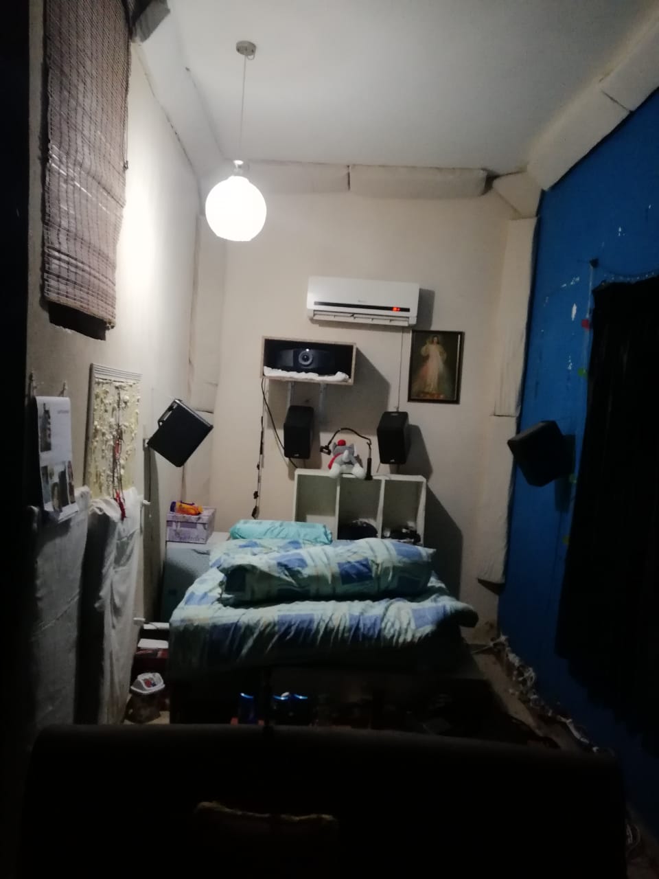

I do. Have a nice - 10db reflection from. One of the speakers, i suppose my room's L shape is creating all kinds of mismatched responses between the speakers
Would having the reflections come from one speaker only cause a problem? E.g the ceiling reflection redirected to the front wall only from one speaker
While it's one thing to try for a rich blend of reflections, normally I'd mark the ceiling and behind the speakers as the first to eliminate.

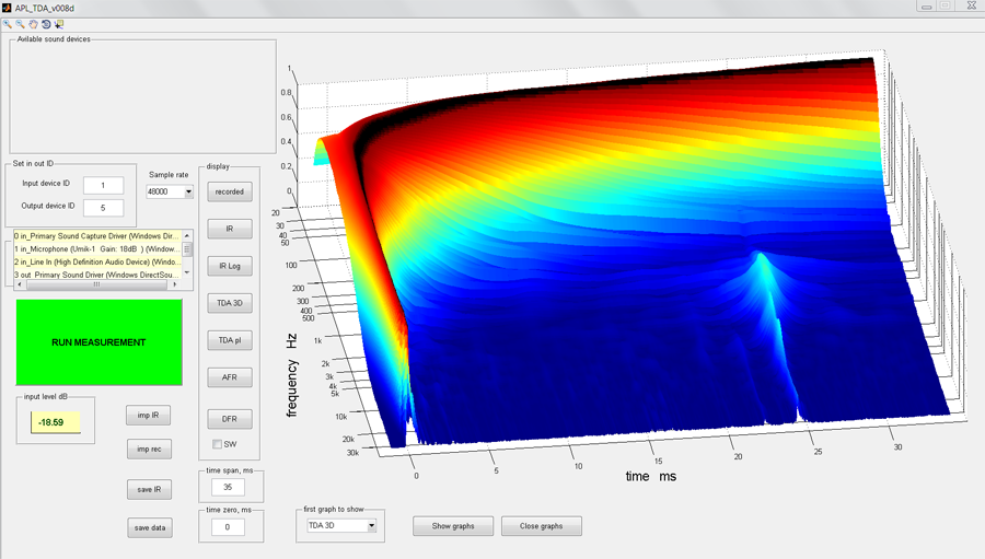

Some 6 year old pictures of the laser pointer, angled Haas Kickers, dark picture of reflection ending up sideways at left ear from right front speaker after 3 reflection points and it strength from REW measurement after about 28 ms. The Haas Kickers has now been replaced by some DIY volumetric diffusers, as well as the front speakers.

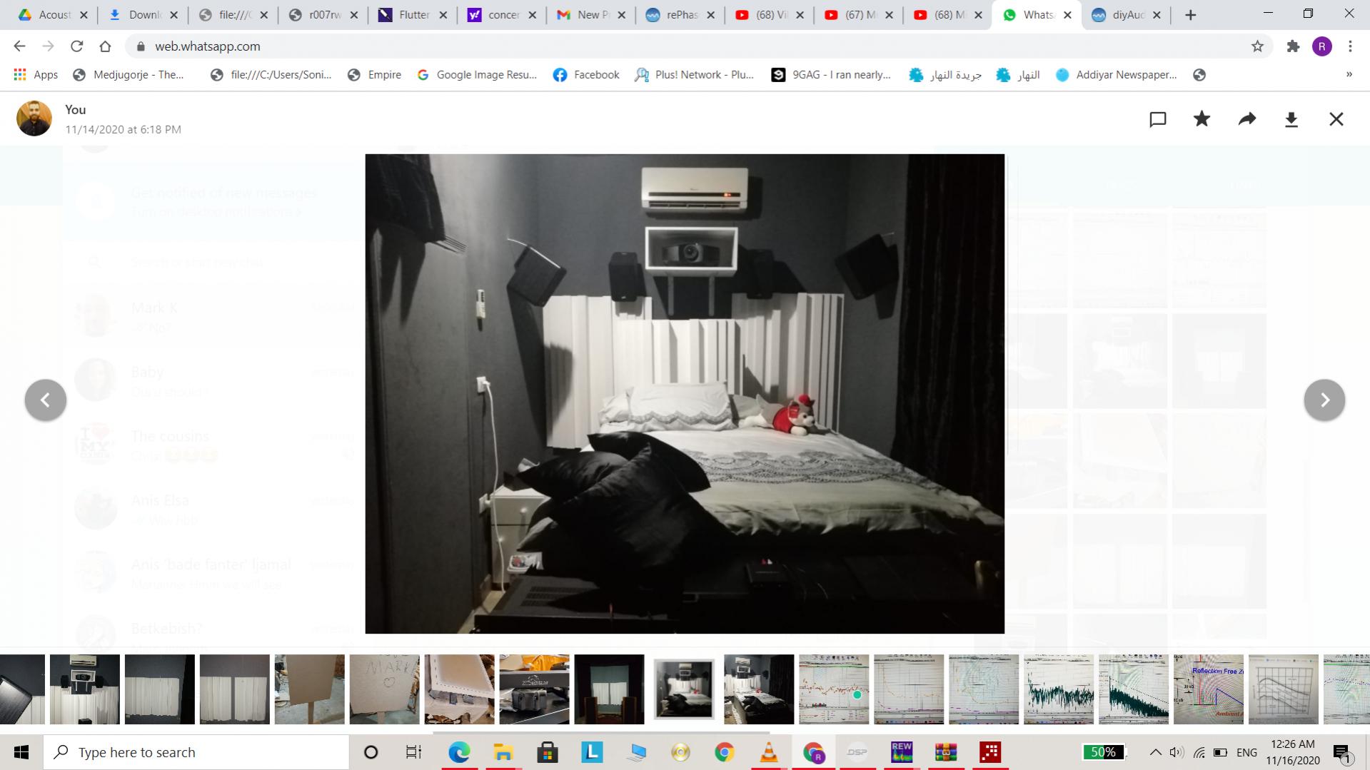

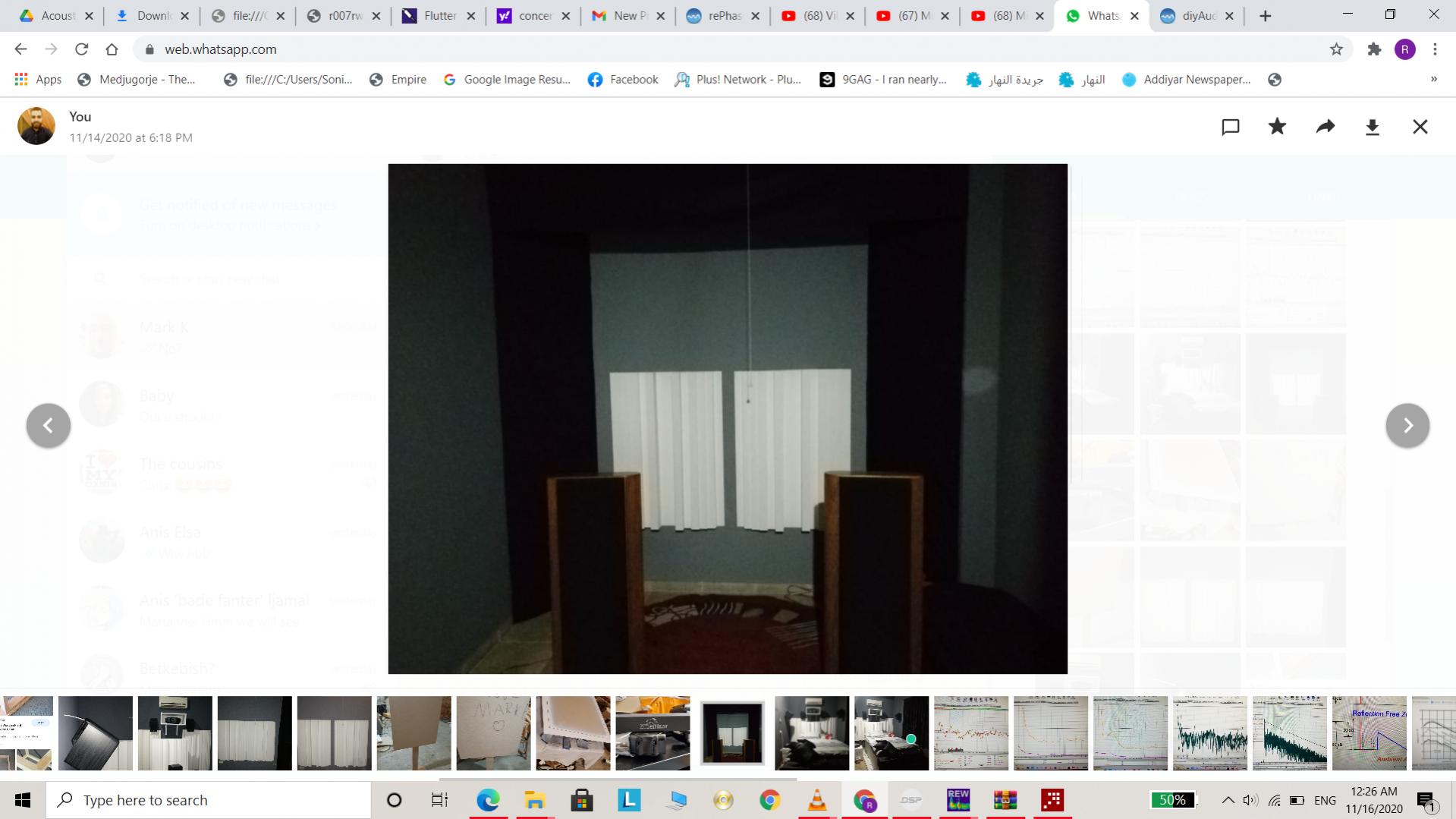

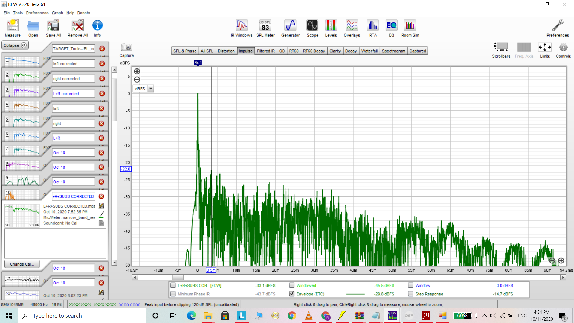

Getting the left speakers wave redirecting to come from the right side is not possible in my room i'm afraid,
What allen said might be a good idea though, what about deadening the ceiling and front wall, redirecting the side wall energy to the back diffused wall? Which is 3.5 meters behind me, and should give me a nice 20 ms ITSG, not sure how strong the first diffused reflection will be, should have a series of reflections around - 15 db or so.
So basically aim for an anechoic path from 0 till 20 ms(around - 25db or better)
Have diffused energy from the back wall at around 20 ms.
Is there any problem with the diffused energy coming from the back only?
Is - 15 db or so of reflections good enough for the effect to work?
Do both speakers have to have the same ITSG? No so easy to do in my L shaped room.
Would having diffusers on the wall behind the speakers be beneficial somehow if i don't redirect strong reflections at it? (i like the way the diffusers are looking there so if they won't cause a problem and possibly help I d prefer leaving them there

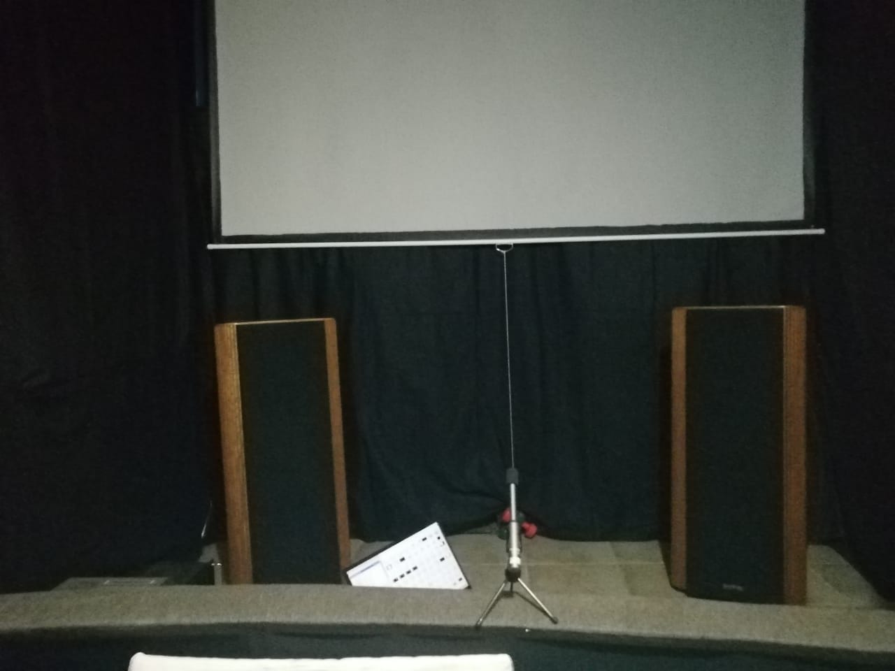

Hey allen, why would you eliminate the ceiling and front wall reflections first, i wonder?
Is it cause they're close to the LP and would mess the the anechoic path before the ITSG?
They come at you from the front, just like the direct sound, and with a short delay time. Prime listening fatigue potential. I like to put heavy drapes behind the speakers with more absorption under them in the usual positions. (If you have speakers with good directivity to begin with then the benefit is reduced.)
The ceiling is distracting and the content there tends to be susceptible to crossover lobing, so potentially not a good tonal match. Still coming from in front, and at a short time delay, but the height itself is also off-putting IMO.
would you still use drapes and absorption behind them if you have no major reflections coming from there? judging by the ETC i mean
If you manage to have a delay of 20 ms coming from the front wall, would you use it or kill it?
i suppose heavy drapes can be replaced with rockwool ?
by under them you mean under the speakers as in to take care of the floor reflection? or under the drapes? and why is that?
my ceiling is 3.5 meters high, i miscalculated before, apparently i have no loud reflections coming from there, should i use some absorption there or just leave it be?

With regard to 20ms, anything that I can get to go behind me can stay and be considered reverberation. The front reflections are a different matter.
I should have said 'behind', just to extend lower in frequency of effectiveness.by under them
