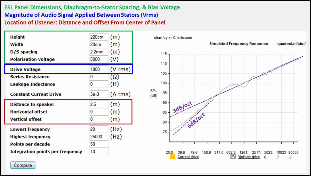

The software assumes that your segmented ESL is an infinite dipole line source with no baffles on the sides. The natural response of such an ESL driven with constant voltage is a response that slopes up at +3dB/oct. Segmentation not only improves the polar response, it flattens the rising response. The sloped response is due to both “dipole cancellation” at lower frequencies and directivity gain or “beaming” at higher frequencies. With no baffle, there is a smooth transition between these two ranges resulting in a constant +3dB/oct slope. If you have baffle edges that are of significant size relative to the ESL width, they will put a slight step or offset in the response separating the two sloped ranges.… does the esl_seg_ui software take into account dipole acoustic cancellation?
Here is an example measurement of an un-segmented ESL line source showing the +3dB/oct slope.

When your ESL is a finite line source, it will behave like an infinite line source(+3dB/oct) at high frequencies, and a point source (+6dB/oct) at low frequencies. The frequency at which the response transitions between these two slopes is dependent both on the line length and the listening distance.…I would think my esl is somehtng "in between" a point and line source - or at least not a true line source? That would mean that the slope would be in between 3 and 6 dB/oct (far field, voltage driven)?
F = c * r / d^2
where:
c = speed of sound
r = listening distance
d = panel dimension (height)
You can use the latest version of the segmented ESL spreadsheet(experiences with ESL directivity?) to plot this be choosing Line Source = Finite, setting the number of segments to n=1, the low frequency break point fL = 100000, and the diaphragm resonance frequency Fs=0. The solid green line would be the response for an infinite line. The dashed green line shows the response for the finite line.
The ESL spreadsheet uses an average trend line of the response. If rigorous calculations are performed you will see the response has ripples superimposed on the response, with a hump at the transition from line source to point source behavior.
An example calculation of this is attached. (taken from here: Help with esl simulator)

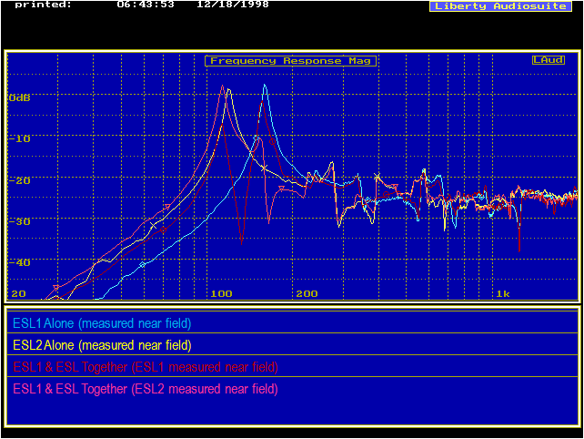

Hi Bolserst,
thanks for your reply and directions, I implemented the Linkwitz Transform filter in my MiniDSP and even though it lowers the resonant peak, the rattling sound still is there. (I have only 1 cd that is able to produce this problem).
Below is a measurement before and after applying the filter:
So in my opinion there is no audible improvement even though the peak is lowered by about 10 dB. Even when applying steep (48 dB/oct) high-pass filters the rattling sound is still there.
I can attenuate this sound quiete a bit by just clamping a wooden board aganst the back of one panel covering the whole vertical length of the panel. (using glue clamps) I measured the effect of clamping 1 panel of about 40x160 cm perpendicular against one side at the back of the panel. I got this idea because the panel is rather tall and wide but thin and it lacks a stiff supporting frame. So when I stamp my feet I can see the top of the panel moving back and forth.
Below: mic @ 3 meter from panel, right channel, in room:
Below: left channel mic @ 7cm from panel:
To conclude, it seems that the frame itself resonates as well, resulting in a higher Q.

Your measurements are very interesting. Im just a noob so forgive my blunders but it looks like your (L) and (R) membranes resonate freely below 40Hz. The frame resonance seems like a secondary issue with more essential issues to sort out? The filter you tried seems like it wouldn't work as the resonance after its applied was still up by nearly 10dB from 20-30Hz where the high Xmax at such a low frequency could create slapping.
When you tried the steep high-pass filters what frequency did you use? You might need to have it up at 46Hz or higher to attenuate enough at 30Hz and below to work?
Would tensioning up the membrane (eg heat shrinking ) help to push the resonance freq. higher?
The rattling sound you mention, does is sound like the diaphragm is hitting the stators?… I implemented the Linkwitz Transform filter in my MiniDSP and even though it lowers the resonant peak, the rattling sound still is there. (I have only 1 cd that is able to produce this problem). Below is a measurement before and after applying the filter:
Wow! That is some peak you have there, +25dB. With Q>20, it will be very difficult to get the Linkwitz Transform filter aligned exactly right. Your best option might be to use some acoustic damping to lower Q of the resonance to the point where you can more easily take care of the rest with the L-T miniDSP. I know you had experimented unsuccessfully with acoustic damping in the past, but you might want to revisit it as a partial solution to use in combination with the miniDSP.
To avoid the problem of frame resonance, you need to make the natural resonance frequency of the frame(fF) significantly different from the primary resonance of the diaphragm(fD) so one doesn’t easily excite the other. With large full range ESL, this can be difficult. You need to either stiffen the frame (like you did with clamped board) to increase fF, or add mass to lower fF. Perhaps if you can move fF away from fD the Q of resonance will be lowered enough to handle more easily with the miniDSP, acoustic damping, or a combination.To conclude, it seems that the frame itself resonates as well, resulting in a higher Q.

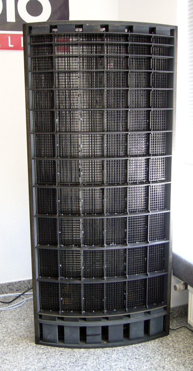

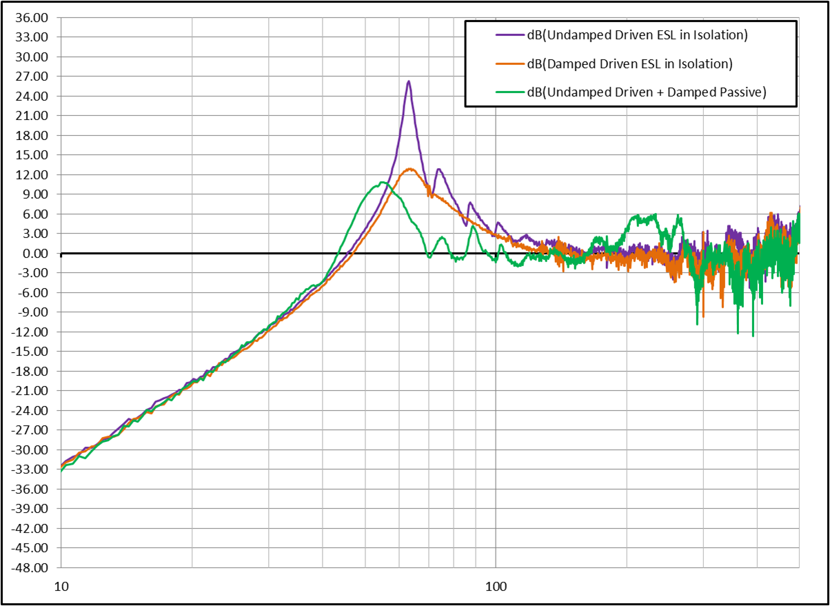

@ silvershadelynx,
You have put forth a lot of ideas and questions. You must know from your experience that designing a full range ESL with high output and well damped bass is very difficult…something I have not done. But, I have performed many experiments and measurements that may be helpful in your quest.
Concerning mechanically segmented panels and bass output:
You are correct that mechanically segmenting a given panel area will reduce low bass output capability compared to if the entire panel has the same resonance. For example, the Sound Lab speakers only have about 1/3 of the total panel producing useful output down at 30hz.
But, as you have found out, having a large panel area with a single resonance frequency results in very high Q. If use of damping mesh is not desirable, having a vertical stack of panels(or single mechanically segmented panel) with slowly varying sizes as you suggest will result in lowered Q for each of the panel resonances. Measurements of the Sound Lab A-1 can be seen here: Full Range Electrostatic Question They have recently modified their mechanical segmentation scheme to have large areas both at the top and bottom of the panels to increase radiating area at lower frequencies. This increases the amount of panel area contributing to output in the bottom octave. They call it “bass-focus”. (see attached pic and *.pdf)
However, placing a single large bass panel with a much lower resonance next to the line of higher resonance panels (like in your drawing) will likely cause some undesirable interaction. The resonance frequencies of adjacent panels need to be close together to affect some amount of damping without ill effects. See attached measurements from (20 years ago 😱 )

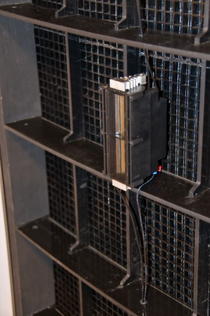

Concerning diaphragm resonance damping:
Notice in the measurements of the Sound Lab speakers linked to above that the resonances are of lower Q than when you use one large diaphragm area with a single resonance frequency. This technique may be all you need to lower the Q enough to make DSP equalization of the milder peaks possible.
One other method of damping diaphragm resonance uses a passive “bass” panel set next to your ESL. The passive panel reduces excursion of the driven ESL as well as contributing to the total output, not unlike vented enclosures used with dynamic drivers. At least one company uses this method. (Pic attached in case website is removed in the future)
Electrostatic loudspeakers model Magic Music - DEA Electrostatics | Audio systems design and production
Measurement of this technique show it to work much better than I would have expected. The only trick would be to get the frequency of the passive matched to the active panel. Attached is a plot comparing measurements of a large ESL: undamped, with acoustic mesh damping, and undamped but with a passive damping panel.
For more details and many other measurements using this technique, see attached Passive_Damp_v2.pdf file.
Concerning resonance of stator structure :
In my own speakers I chose to limit ESL output below 75Hz and use dynamic subwoofers to handle the bottom 2 octaves. This allowed me to mass load the stator frames to push their resonance below that of the diaphragm. In your case you will need to make the stators as stiff as possible to keep their resonance above the diaphragm resonance. For your consideration, the Sound Lab ESLs use stator stiffeners that are over 10cm deep to get the stiffness required. Attached are 2 pics of the front stator and one of the rear. The resulting stator structure is incredibly solid.
Hi Bolserst,
thanks again for your great reply and sorry for my late reply. It seems more difficult than expected to get enough LF range without resonant peaks. I tried a passive element by using one channel as a passive element with varying distances to the neighbouring active element, but without much effort. (it only dampens a few dB's in my test case).
It seems, according to your old tests, that putting mechanically seperated elements of wide varying sizes results indeed in unwelcome results / frequency resonse. I think it's not worth the effort to try - to much work.
I'm not convinced the sould labs solution of distributed resonance is would result in an improved sound quality. It's a lot of effort to build and who knows one exchanges one problem for a different one. (less output in the lowest octaves).
To conclude, maybe my "full range" stats are not that bad at all. The only option to improve LF / resonant peak left would be to make an even wider and taller stat, but getting it mechanically stable will be more difficult I guess. Maybe I will try this in future. If so, then I will keep you informed!
Did you have the bias supply on your passive element powered up? Because of the negative compliance associated with bias voltage, it is possible that if you were not using any bias voltage on the passive panel its resonance frequency was higher than the active element and was therefore not able to provide significant damping. Also, did you have felt or other damping material on the passive element? For all of the panels I experimented with if 1) resonance was matched, 2) damping material used on the passive element, and 3) passive element placed with minimal space beside the active element, significant damping was achieved.…I tried a passive element by using one channel as a passive element with varying distances to the neighbouring active element, but without much effort. (it only dampens a few dB's in my test case).
If unfamiliar with bias voltage related negative compliance:

After experimenting with several prototypes, that was my conclusion as well.…I'm not convinced the sound labs solution of distributed resonance is would result in an improved sound quality. It's a lot of effort to build and who knows one exchanges one problem for a different one. (less output in the lowest octaves).
Thanks for your reply Bolserst,
I didn't have the bias supply of the passive element powered up during my tests / measurements. I did use damping screen on the passive element. I was unfamiliar with bias voltage related to negative compliance, very interesting to read!
