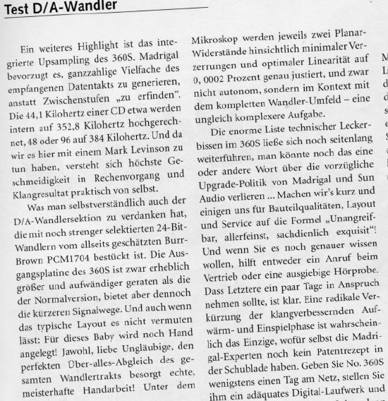

I'd like to have additional single ended outputs. If I just connect the positive output to an RCA socket, I will lose the error-correction function of the symmetrical setup. Is there a simple (and well-sounding) way to combine + and - to make single-ended output?
I wouldn't mind if you translate this, as I'm curious about the microscope technique myself😉
"Another highlight is the internal upsampling of the 360S. Madrigal
prefers to generate integer multiples of the received data rate
instead of "inventing" intermediate steps. The 44.1kHz of a cd for
instance are calculated to 352.8kHz, 48 or 96 to 386kHz. And as we
deal with a Mark Levison, maximum smoothnees in calculation and sonic
result are practically self-evident."
no you don't want to read the rest of it. the microscope is not really explained. only something like trimming the resistors to 0.0002% for over-all minimum distortion of the whole converter circuit
"the ernormous list of technical delicacies could be continued for pages..."
For me this is not an option! :dead:
