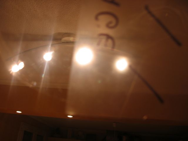

I removed the transparent layer on the back of my broken lcd.
it look different more transparent and less dissusity.
picture left is the tranparent layer removed from the back of the lilli
picture right the ag layer from the front of the lilli.
