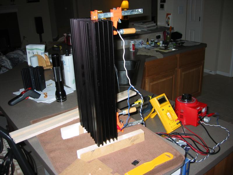

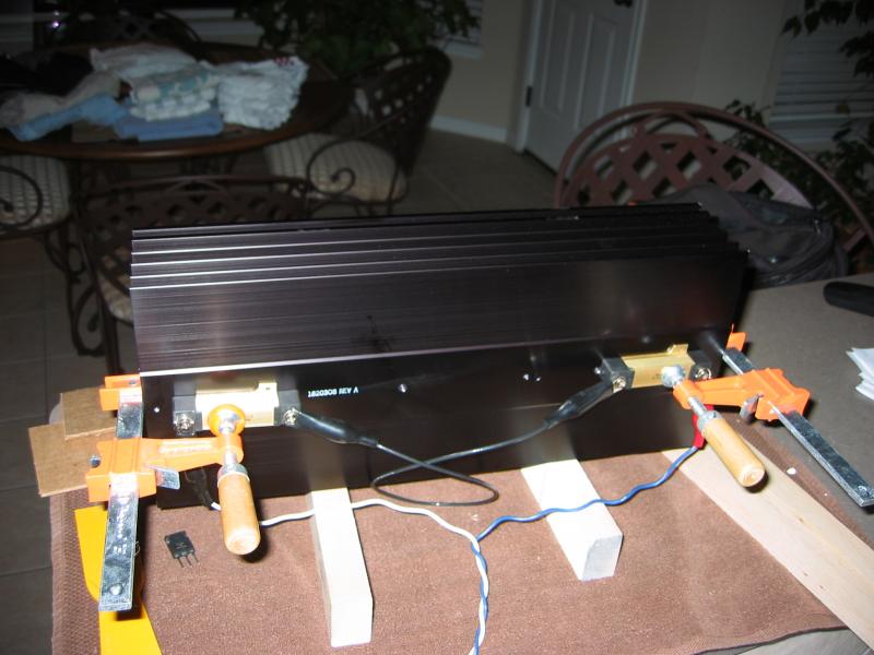

I ran across this thread and happen to be doing some heat sink tests so I'll add what I have found.
One thing that should be noted about heat sink length correction factors is the assumption that the heat load is a point source. Aavid states;
"The published extrusion data shows natural convection performance for a three inch section with a centrally located point source heat load. Because the heat load is assumed to be at a point rather than uniformly distributed, thermal resistance does not change linearly with length. (The ends of a very long extrusion would be cooler than the center and therefore the transfer of heat to the surrounding air is little, if any)."
I think in most cases we parallel several fets so distribution is very doable.
I generally find the published data is not very reliable because it is all about how they are used. I came across surplus 16 inch Aavid 61570 sinks and tested them to see how they perform. If you go by the Aavid correction for temperature rise and length the estimated thermal resistance would be;
0.81 C/W/3" (published 61570 data)
1.257 (30C rise vs 75C temp correction)
0.49 (16" vs 3" length correction)
for a total Rth = 0.5 C/W
My test places two aluminum resistors clamped near each end. I applied 125W (62.5W ea) and measured a 30C rise, thus Rth = 0.24 C/W, about twice as good as calculated. I determined this by measuring the temperature next to each resistor and a spot in the middle of the sink, then take the average. I plan on using 6-8 devices per sink (better distribution than two resistors) this is why I took the average. The three temperatures from top to bottom were 57.5C, 51.2C and 53.4C at a 24C ambient.
I don't find it very convenient to mount the sinks vertically so I tested them horizontally as well. They measure about 32% worse or Rth = 0.31 C/W.
I don't think people should dismiss long heat sinks and I think this goes for wide sinks as well (you should get better performance as well for the same reasons). I encourage everyone to test their own. It is a simple test. All you need is sink mountable resistors, a variac and a temperature probe.
Post your results!
