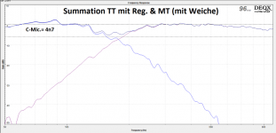

Yes! Each of the two drive units per box has an individual, sealed volume.... Are you keeping the same woofer in the same enclosure?
I agree with that.... setting of f(I)=32Hz is probably already close to optimal...

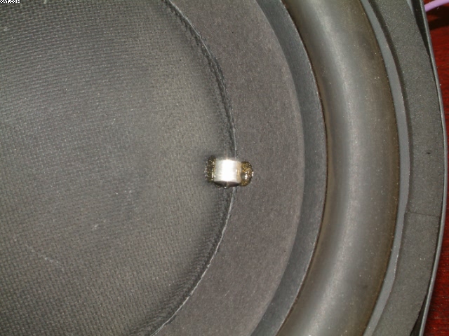

The old electronics employed one poweramp for two drivers in parallel and summed the two microphone(!) inputs into one control loop.
I'm planning to break that up and control each driver individually with its own power amp and own mic driven feedback loop. Is that overkill? I'm inclined to say "no", but want to try that out as part of the hobby 😉
That's my understanding as well.... the peak of the open loop gain curve will be at the resonance frequency of the closed box woofer, so will be dependent on the woofer/box combination even if the MFB circuit is unchanged...

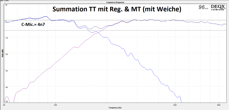

As prework I have done Qtc and fsc measurements of the drivers, finding Qtc of 0.57...0.58 and fsc 60...61Hz consistently over the four boxed drivers.
To make all this a bit more tangible, attached arre a few pictures.
Thanks and Regards,
Winfried
Thanks for sharing pictures of your project 🙂…I'm planning to break that up and control each driver individually with its own power amp and own mic driven feedback loop. Is that overkill? I'm inclined to say "no", but want to try that out as part of the hobby 😉
Having separate sensors, amplifiers, and feedback loops for each woofer is the theoretical ideal. But in practice, I have found that the response and non-linear behavior of 2 woofers of the same type are similar enough that there is very little to be gained from using separate feedback loops. But, as you say, this is your hobby and from a theoretical stand point it is not overkill.
BTW, when splitting the single feedback loop into separate feedback loops, be sure to use separate R157 supply resistors for each mic capsule rather than sharing one. Also, increase the value of each R157 to 30K so the first order LP filter (mentioned in post #14) remains at 1kHz. Alternatively, you could leave R157 = 15K and add an additional 4n7 capacitor across each mic capsule.

Hi Ben,
thanks for your thoughts an the warnings! Please consoder, though, that I have a working feedback loop at hand which I'm evaluating for optimisations and most effective tuning of the (currently fixed) feedback loop to the individual drivers. No howling was detected so far, but a 6dB drop at the 180Hz cross over acoustical frequency response.
Hello bolserst,
thanks for your instructive comments! I can follow your phase lag vs. stability considerations. The C across the mic. output seems to do what you suggest. So, what I have measured (near field) could well be the price payed for acoustic feedback ... right?
So, in summary, it seems best to stay with two mics. and the Cs across the mic., evaluate two individual loops, though.
To my mind the most prominent motivation for mic. feedback-loop introduction at B&M was to extend the bass range (to ~30 in ma case), other linarisation effects coming as a bonus. Feedback with a mic. was "just" low cost compared to the inductive feedback loop (as used in the higher priced B&M Systems until today). Means: AFB is/was an accepted / calculated cost vs. quality compromise. I actually do see mic. feedback loops in quite well souding Sub-woofer still these days (where "crosstalking" sound sources like mid range drivers are relatively far away...).
Thanks and kind Greetings,
Winfried

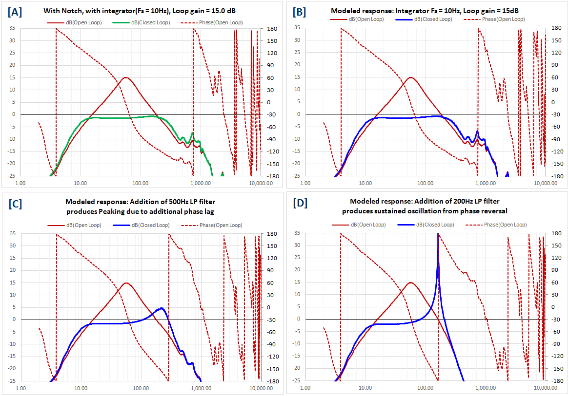

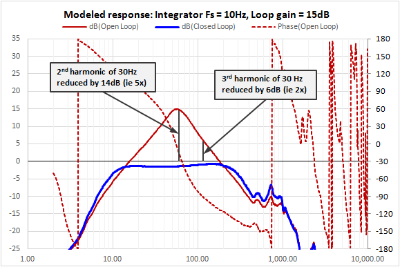

I’m not sure exactly what was going on with the measurements in Post#10 where you mention seeing a 6dB shift in woofer response. Changing C should have only affected the response at frequencies higher than 1kHz. I suspect that something else was unintentionally changed at the same time to obtain the results you measured.… I can follow your phase lag vs. stability considerations. The C across the mic. output seems to do what you suggest. So, what I have measured (near field) could well be the price payed for acoustic feedback ... right?
To better explain the phase lag concern when trying to roll off HF response of mic to help mitigate inputs from the midrange, see attached set of 4 plots.
Plot (A): This is measured response of a MFB woofer system I built with integrator frequency of 10Hz and open loop gain of 15dB.
Plot (B): Modeling of the MFB system…not a perfect match, but very close.
Plot (C): Modeling if a 500Hz LP filter was added to the feedback loop you can see the open loop response is rolled off, but at the cost of phase lag resulting in reduced phase margin and peaking in the closed loop response. (ie marginally stable)
Plot (D): Modeling if a 200Hz LP filter was added to the feedback loop in an effort to remove the peak, you can see the open loop response is rolled off even more, but the phase lag results in complete phase reversal before open loop gain < 1 and sustained oscillation.
That's an astonishing accomplishment: you took a speaker (small sealed box?) with an awful 15 dB peak around 60 Hz and using MFB you made it flat 12-300 Hz.*Plot (A): This is measured response of a MFB woofer system I built with integrator frequency of 10Hz and open loop gain of 15dB.

Harmonics (distortion) can go up to say 100 Hz, so control at those frequencies makes sense for distortion reduction.
For a significant reduction you need a large open loop gain at the harmonics that need to be suppressed. A high open loop gain at 100 Hz means that the gain crossover frequency can be 200 Hz.
Not quite…remember the open loop response includes not only the woofer response, but any filters included for improving loop stability(like the integrator). The woofer was in a small box and underdamped (DVC running with just one VC) but it only had about a 3dB bump at resonance(Q=1.3) and some HF roll off from VC inductance. (see attached plot with woofer response added). Only one VC was being driven because the other VC was being used to compare VC feedback methods with accelerometer feedback.That's an astonishing accomplishment: you took a speaker (small sealed box?) with an awful 15 dB peak around 60 Hz and using MFB you made it flat 12-300 Hz.
Once open loop response(magnitude and phase) has been measured(lets call it H) determining the closed loop response is just a matter of calculating H/(1+H). So, one would hope theory and measurement wouldn’t be too far off. Then, adding in a LP filter(G) to evaluate impact to closed loop stability is easy enough; the closed loop response is just H*G/(1 + H*G).
Remember, the pulse response and the frequency response are mathematically tied together. No new information, just a different way of looking at the same information. Are you interested in the impulse response? Or tone-bursts? If so, what frequency. For me, the frequency/phase response is a more intuitive way to look at the information.Sure would be nice to see distortion and pulse results.
I did measure distortion, but at that time the equipment I used for distortion measurement was stand-alone and did not have export capability. In any case, with the ACH-01 accelerometer, distortion as measured by microphone was reduced by the expected amount of the open loop gain factor at the harmonic frequency. Example for 30Hz shown in attachment.
As TBTL mentioned, and I alluded to above, if you are trying to reduce harmonic distortion you need to push open loop gain to as high a frequency as practical. HP and LP filters are used upstream of the MFB circuit to tailor the subwoofer bandwidth as desired.Nice to see struggles to apply MFB to north of say, 200 Hz. But why try?

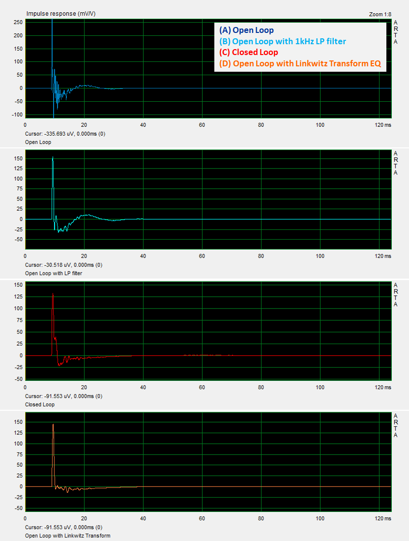

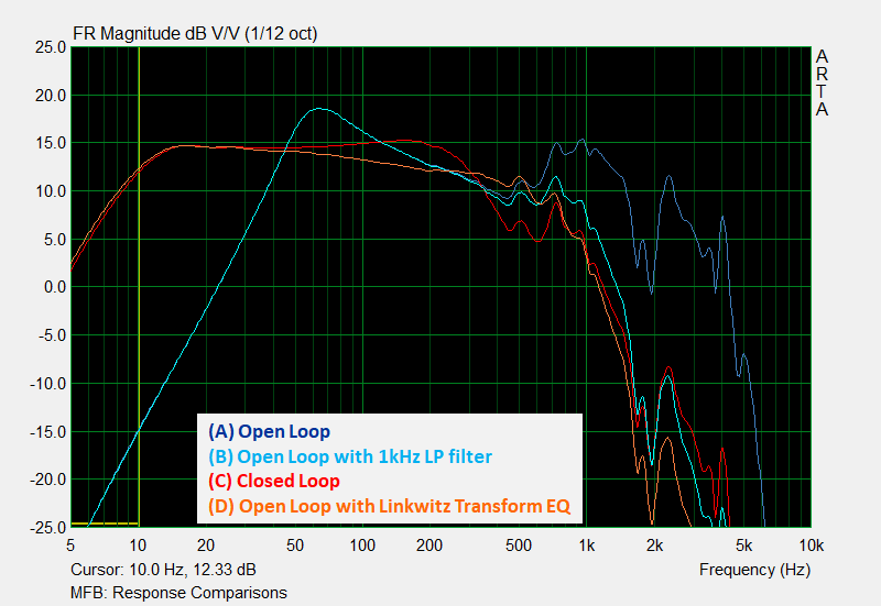

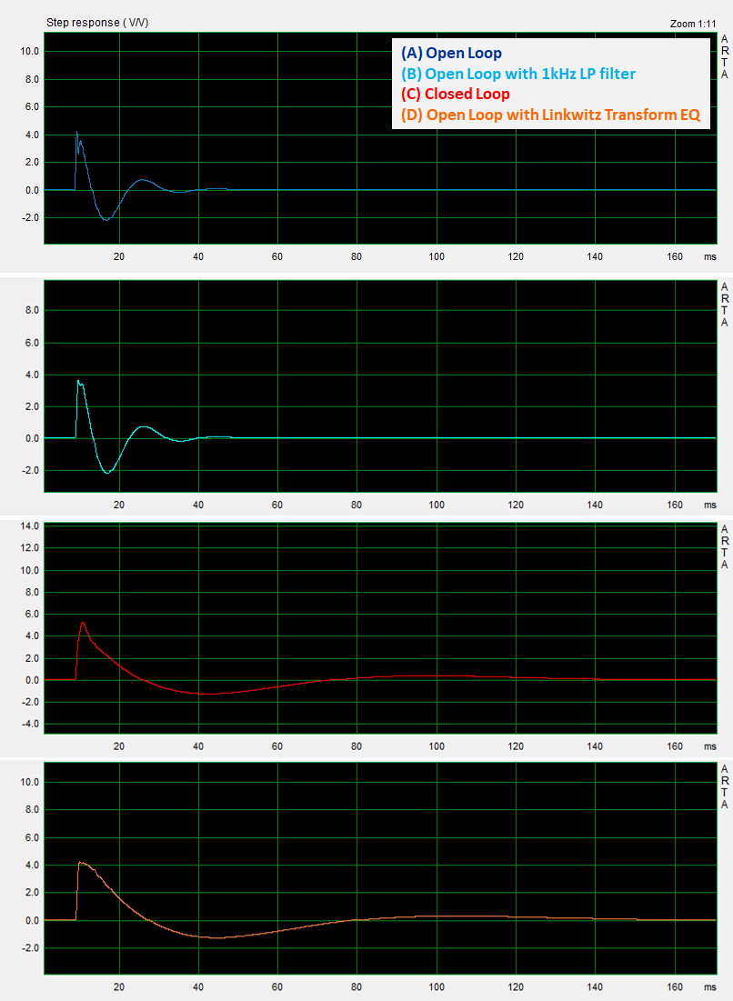

… I managed to locate the parent impulse response data for those MFB experiments. Will get them imported and plotted in the next couple days.
OK, I located 4 different impulse measurements of interest:
(A) = Open loop response of woofer
(B) = Open loop response of woofer with analog 1kHz LP filter
(C) = Closed loop response of woofer with MFB using ACH-01
(D) = Open loop response of woofer with analog Linkwitz Transform EQ used to flatten and extend response to roughly match the closed loop.
Attached Plots:
- Impulse Responses
- Step Responses (calculated from Impulse)
- Frequency Responses (calculated form Impulse)
Attached *.wav files:
- Impulse of A
- Impulse of B
- Impulse of C
- Impulse of D
- Compare A vs C: A, A, pause, C, C, pause, A, A, pause, C, C
- Compare B vs C: B, B, pause, C, C, pause, B, B, pause, C, C
- Compare D vs C: D, D, pause, C, C, pause, D, D, pause, C, C
Enjoy 🙂
Thanks for as elegant and compellingly logical a presentation as anyone could imagine.
I am struggling to parse the wonderful data. The attached impulse plots are hard to read on my gear. Any way to re-package the plots?
Being away from my home-base HiFi just now, using headphones seems to be more revealing of differences for me than poor available speakers; might be true for others too. I hope others will post their aural impressions.
My first gross impression is that LT-EQ and MFB produce similar FR and tone colour. That is a credit to both of them. LT-EQ works because Linkwitz analyzed right although as they say, "your results at home may vary". MFB works... which shows it works and possibly might not vary as much. LT-EQ is just cosmetic although simple to implement. MFB is a proper means of correction although complicated to implement. But I'm keen to closely eyeball how Bolserst impulse plots compare.
