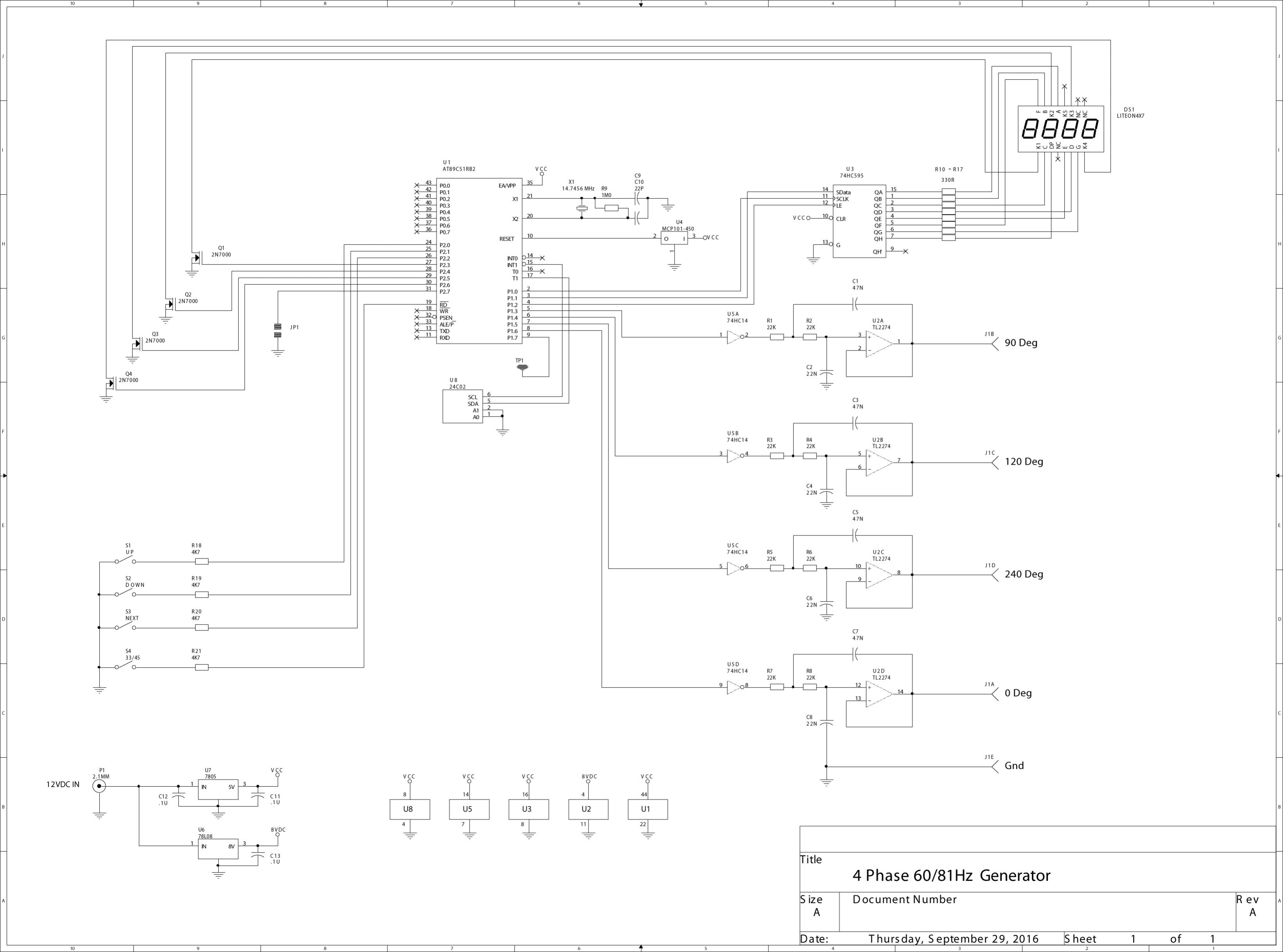

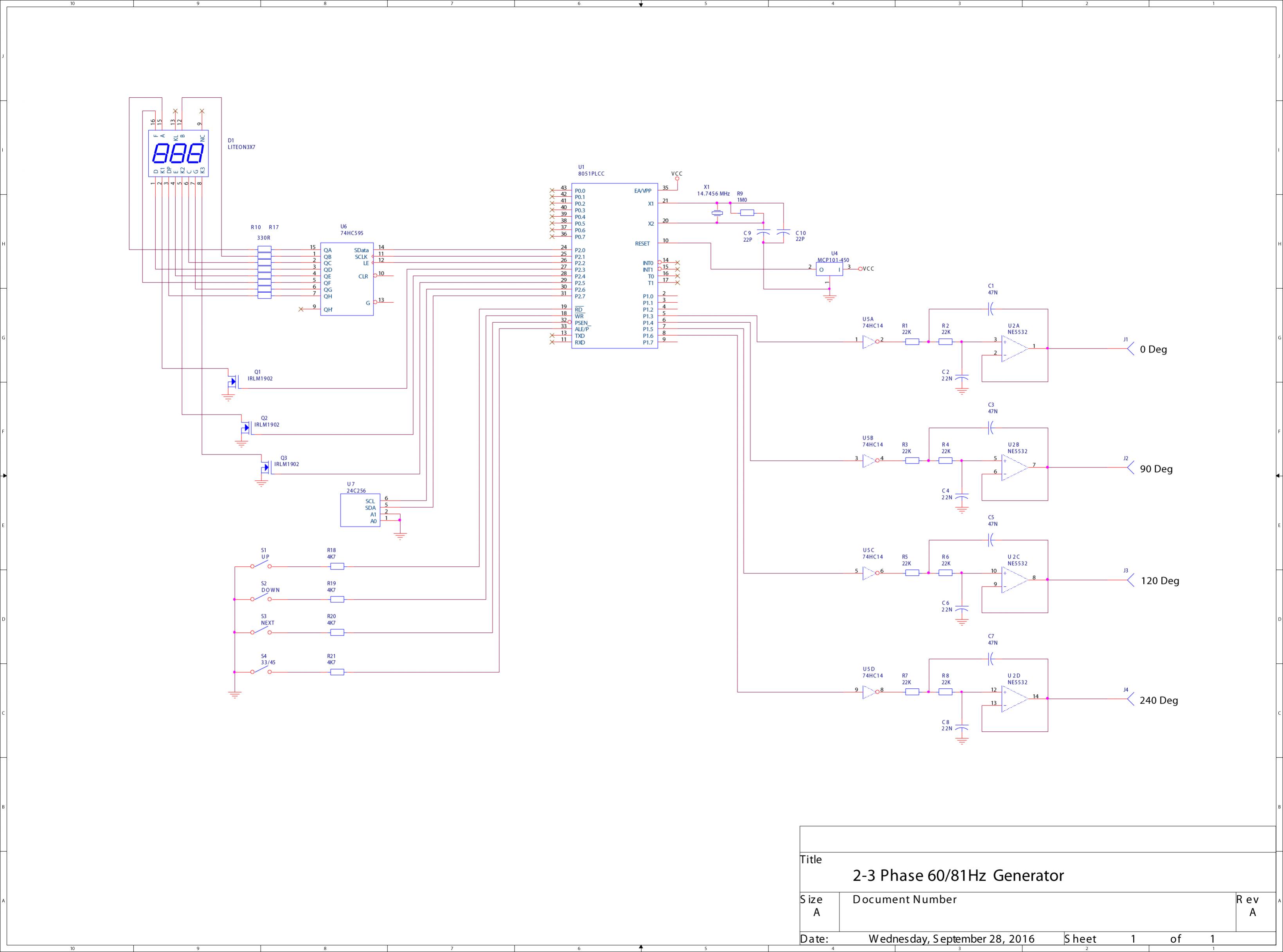

It looks as if everyone has their preferred source for generating the sinewaves, but I was wondering if there would be any interest in a DIY version?
Using an Atmel AT89C51RB2, which has a 5 channel 8 bit PWM built in, I was able to generate 50-90 Hz sinewaves with 0.05 Hz resolution, crystal accuracy, <1% distortion and output zero, 90, 120 & 240 degree offsets simultaneously (adjustable in ~1.4 deg steps) with only a few additional components (hex inverter, quad op-amp, EEPROM, 3 digit LED display). Including PCB, BOM cost is probably ~$35. It would require soldering (thru-hole or SMT). I have no interest in selling parts or PCBs, but I can provide a .hex file that can be downloaded into the micro and gerber files that can be used to fabricate PCBs at your favorite board house. Any thoughts?

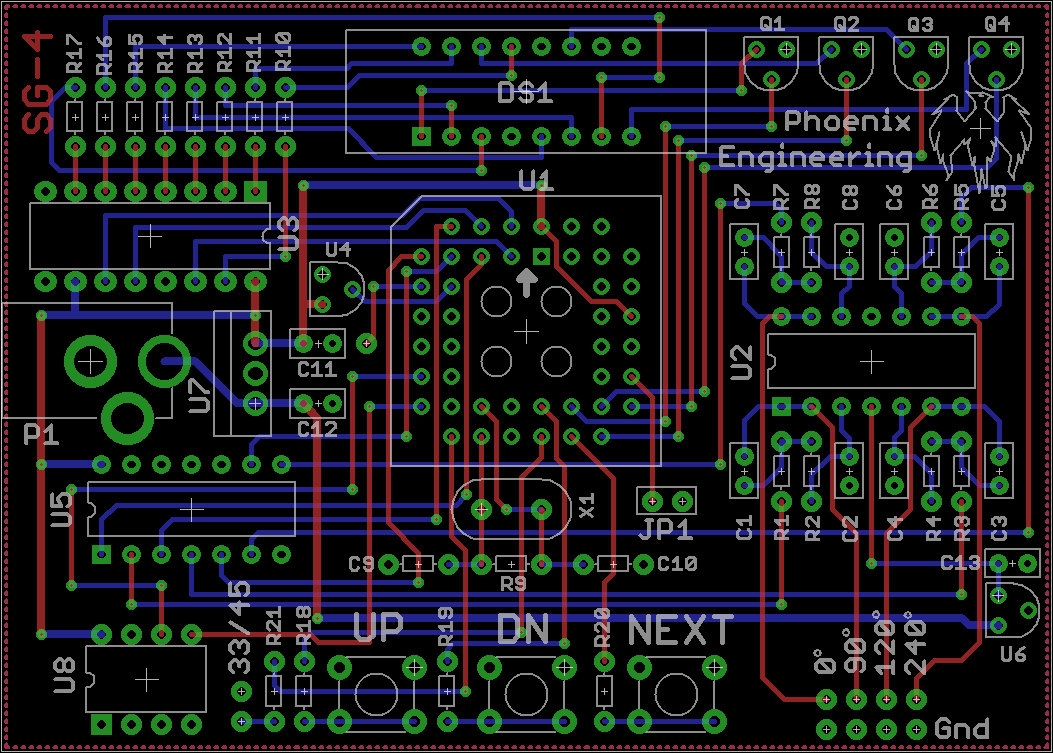

Pyramid, very nice of you to offer this. I am very interested, but have never had a PC board made before. If someone could point me in the right direction, I could probably pull it off. If someone else more knowledgeable wants to do this fine, and I'd help with the costs. Just for grins, I started to look around, and found a US based company that offered online quotes. The minimum run was 5, and was based on size. I took a wild guess at 3" x 4", and another for 4" x 6". I have no idea what size would actually be needed, but thought that might give me some idea. There was just about a $5 difference in the size. I also got a price for 10 boards as well. The prices ranged from $125 for 5, and $180 for ten for a 3" x 4", and $130 for 5 and $185 for 10 in the 4" x 6" size. This was for a 2 layered board .062" thick, their best quality board.

Hi Pyramid,
First of all my compliments with your fantastic achievement.`
I am also interested, even willing to make the Gerbers but not in the production of the PCB's.
But I have a few suggestions:
a second order 200Hz filter is a bit meager for suppressing harmonics from a square wave, and the amplitude of the squarewave largely depends on the power supply.
Linn is using a 6th order 100Hz LPF , and it would hardly effect costs.
Last but not least, it would bring quite some extra comfort when it would be possible to adjust the amplitude of the various sinewaves.
And could some extra hardware be added to the PCB to load the hex file and also to make it possible to load future updates.
Maybe this programming can be performed with a USBTINYISP ?
Just a few thoughts.
Hans

I feel 1% THD from the oscillator is slightly below par. Download this program to add as many orders of filters as you like. You can do approximations of distortion from data offered. Chebishev is usable as it is a fixed frequency. I gave a figure of - 45 dB as a target figure. If using a transformer output these tend to be about - 54 dB if of good quality. - 60 db seems about right for the oscillator. TL074 ( 84 ) is OK as an op amp. Being JFET is sometimes is easier to use.
Download FilterPro – Texas instrument free filter calculator | Xtronic
twstd- I just sent the files to OshPark.com for PCB fabrication of prototypes. 3 pcs are $46.80 or $14.60 each. If the PCB checks out, I can "share" the design where all you have to do is go to their site and click on buy, no file transfers needed. Only restriction is you have to buy 3 pcs at a time (or multiples of 3) and the boards are purple. If someone wanted to do a group buy, I have a board house that could do quantities at a bigger discount. I also created a shopping cart on Mouser that can be shared so all someone has to do is go to their website and enter an access code to pull up a complete parts kit. Cost is $33 for 1 pc qty. As with the PCBs, a group buy would decrease the cost. FYI, the PCB is 3.5" x 2.5". I did the PCB layout with all through-hole parts as SMT can be challenging for some people to solder, especially if they don't have the right equipment. Alot of the SMT parts are going fine pitch (0.0125" pin spacing) or leadless which requires a hot air station to solder.
Hans-The PWM clock is running at 14.4kHz so a 2nd order BW filter will attenuate the square waves by -72dB. If more is needed, you could certainly add passive filters between the generator and the amps. I could add a serial interface to program the chip in-circuit, but it adds cost, size, complexity and you still have to construct a programming cable and use Atmel's software. It can be done, but I prefer not to. If a group buy is done, I could program the chips or someone with a universal programmer could do likewise.
Nigel-The output of the breadboard version was ~0.8% distortion, but it didn't have the hex inverters driving the filters (8051 ports are not designed to drive complex loads and this is causing most of the distortion). It will be interesting to see what the prototype PCB measures. The Eagle PSU generator portion has ~0.015% distortion, but the output of the transformer (115VAC) is closer to 0.5%, probably due to core hysteresis in the xfmr. I've never seen a commercial PSU using a xfmr output deliver less than 0.5% THD. I don't think additional filtering will have much effect on the final result.
