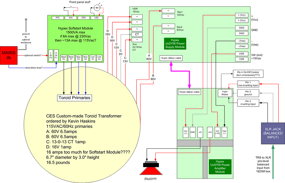

jdgonko said:Could ya all take a look at this diagram I sketched?
Let me know if I'm WAY OFF or getting close to understanding how all this stuff works. 😉
Thanks!
Joe
attached file (gif format file)
Nice drawing.
A few notes.
You should have 2 wires for each of the 60V windings going from the transformer to the power supply.
The soft start is rated at 1500VA. 60V x 6.5A x 2 = 780VA plus at most 90VA for the other windings giving 870VA total. 60V at 6.5A is roughly equivalent to 115V at 3.4A. The soft start should be more than adequate.
Definitely include a switch between the inlet and the softstart if for no other reason than safety when putting everything together.
With the softstart, you shouldn't need a slow blow fuse; a properly sized standard fuse should work well.
That is a great drawing. A couple notes:
#1. Even though the softstart docs show the AC power ground going to the chassis Hypex suggest floating the AC power ground from the chassis. The only point that connects to the chassis is Pin number one on the XLR input. It should be firmly tied to ground at the XLR input.
#2. Use an IEC that holds the fuse. The Softstart documentation suggest you can use a fast blow type. I've not experimented with values yet.
#3. The Softstart can be shut down with a thermistor on the heatsink. Its a nice feature. I plan on ordering some and giving it a try for an extra level of safety.
Once I get all the parts I'll try to clarify all the assembly details and post them in an area for people to access easily. The Hypex Docs are good but we need a FAQ to cover all the little details.

Hello Kevin and Greg:
Thanks for the kudos on the drawing. I'm learning power amps from scratch and creating a drawing such as that one helps me to better understand how all the components work.
I have to give Visio most of the credit for the drawing! I love using that program. Been using it for almost every kind of block drawing since it first was available (i.e. long before Microsoft bought-out the company).
Kevin: Please do keep us apprised of the custom transformer build progress. I am interested in purchasing two of them and then working with all interested "UcD700 people" to make sure I properly wire them up, heh. January could be a very rocking month. 😉

I'm waiting to hear back on a turn-around time on the sample transformer. I'm pulling the trigger on the order as soon as I can confirm the specs of the sample. The company is the world's largest toroid manufacture so I'm sure they have the equipment and expertise to do it right. Murphy can always raise his head so its better to be patient and safe rather than hasty and sorry.
Ok... after a long wait I finally have the sample transformer:
We are looking at eight weeks right now for production units. Those who are still interested please contact me via my email: info@diycable.com
I'm also doing a package with the UCD700AD & UCD700PS for those who are interested.
Final Details on the transformer:
*Dual 0-115V Primaries
*Dual 60V Secondaries 6.5A each.
*13-0-13V Center tap 1A
*0-16V 1A
*Copper foil shield between primaries and secondaries.
* Goss Shield to limit EMF
* Potted center with through hole
* Bolt, top plate, nut, rubber insulating pads for mounting hardware.
*0-16V 1A
- Class D
- Optimal transformer for UCD700
