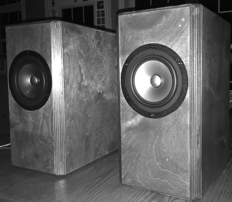

One of the larger trapezoids. There are medium, wide, & extraWide variations. As they get wider they get shorter. I expect the middle one will be best overall. Bass performance will be largely the same.

If you can’t make the trapezoids there are rectangular ones, Classic Golden Ratio, and the Compact FloorStander — all easier builds.
Yes the traps are not an easy build, but they bring a subtle reduction in diffraction signature (cross-section is roughly a teardrop shape), and they look cool.

Traps are indeed more challenging to build than rectangular enclosures. For mFonken103SolT, I went slowly, taking the time to think through each cutting or gluing step, using overhang and other features of the work pieces to pit forces against each other and keep things in alignment, and it turned out just fine. TOTALLY worth the effort. If I can do it, so can you!

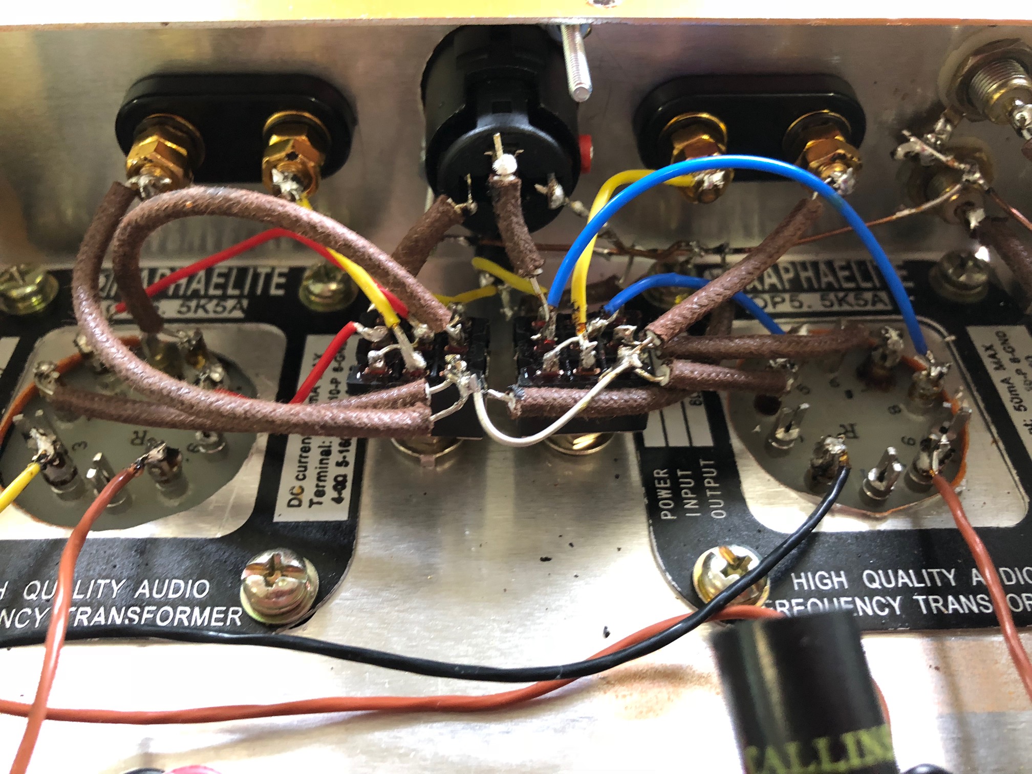

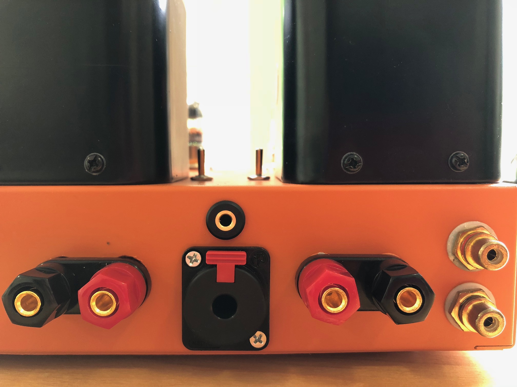

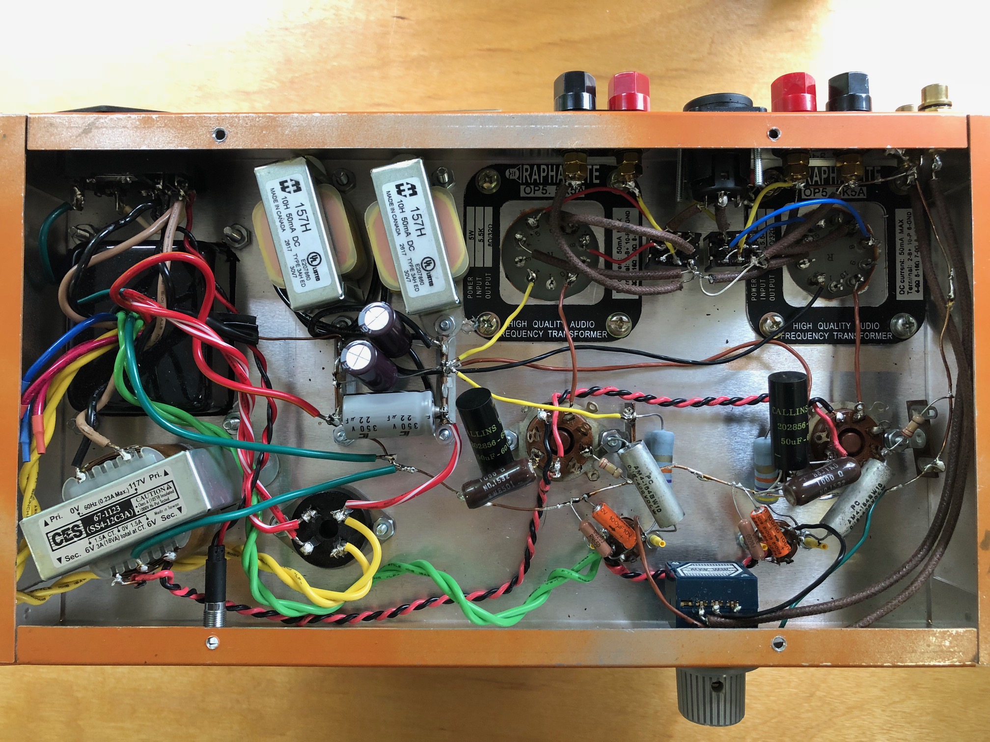

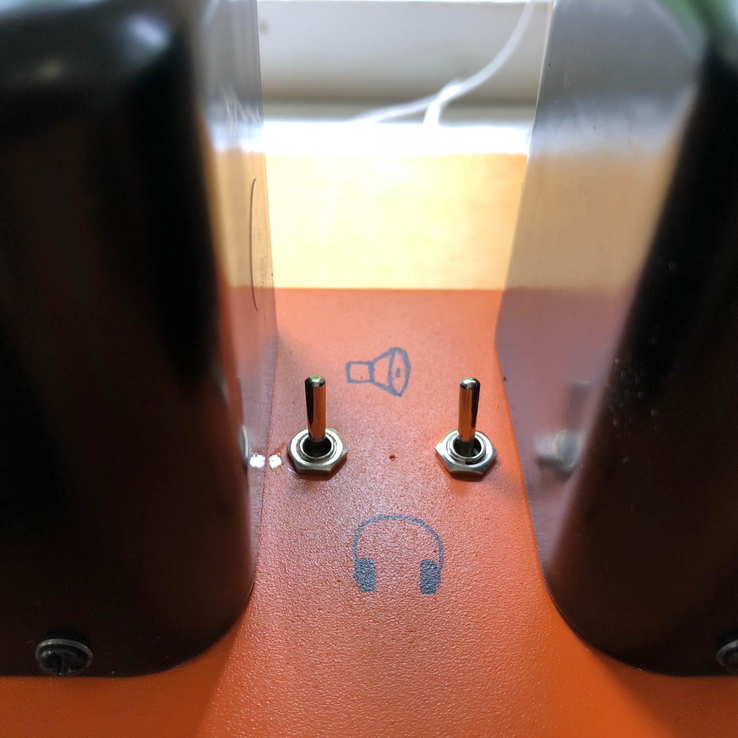

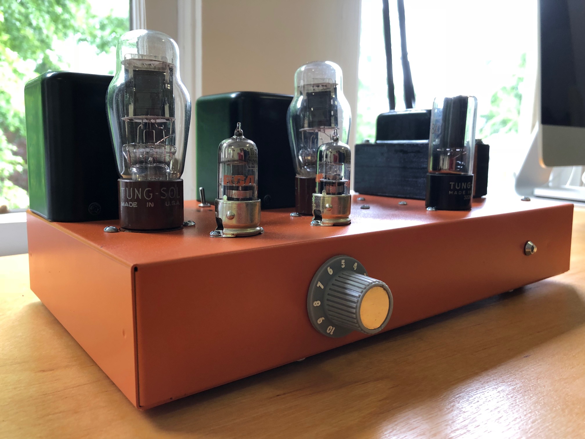

Sounds good, waxx. I've been using a pair of 89dB Fostex FE103Sol in various enclosures, first with a triode-wired SE 7C5 (loctal 6V6GT) amp (1.5 watts) and now with my variation of a SE 1626 "Darling" amp (0.75 watt, though probably closer to 0.6 watt at my operating point). Both of these are powerful enough to drive the 89dB Sols to levels that are too loud for me, and they sound fantastic.
The 1626 is the most recent amp that I bothered to finish in a chassis, about three weeks ago. It has Raphaelite 8 ohm/32 ohm output transformers, and a 3 pole double throw switch in each channel to toggle between speaker and headphone (32 ohm Beyerdynamic DT880) without having to unplug/plug things at the back. Been listening to it all day while working this week.
