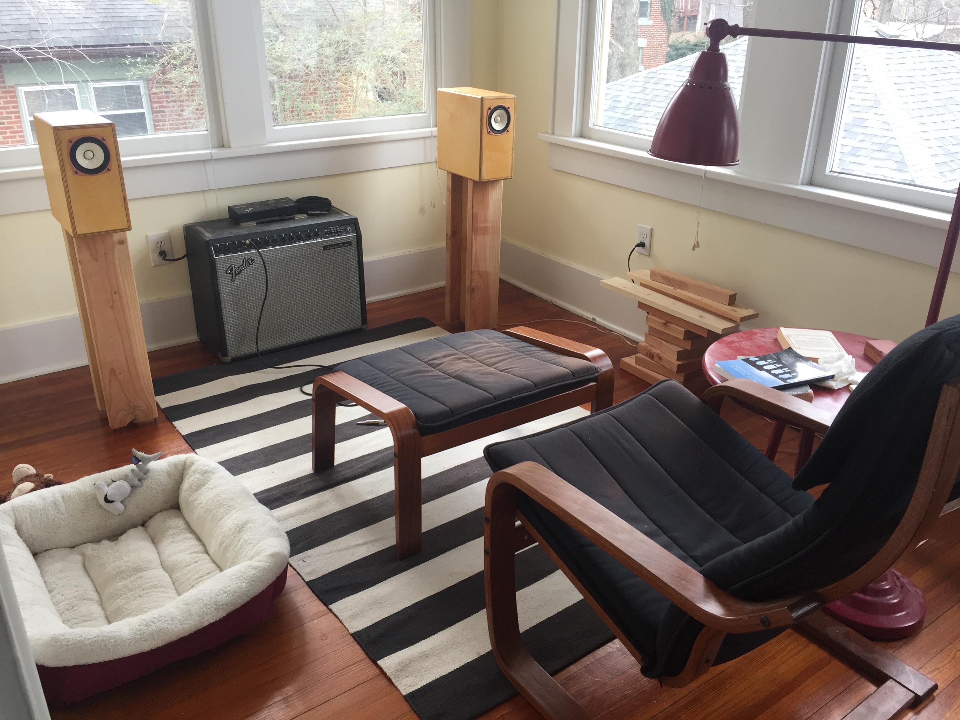

Thanks guys. Yes I’ve made a pair of Woden Shrike (pictured above) and am midway through a Falcon build, as you know. I’m eager to hear the differences in the drivers when compared in the same type of enclosure. It’s just so much fun that it’s got me wondering about what else is possible. Strange that the satisfying sound of the Shrikes, especially when played with a 300B set, made me restless.
So far the Sol has been more pleasing to me than the 105, so I’m also wondering what enclosure would extract the best performance — I guess most finesse — from the Sol.

My listening levels are usually pretty low in this small room, so I feel comfortable with the A7.3, then.
Not to get off-topic, but in your experience, which enclosure extracts the best performance (finesse, as you tend to say) from FE103Sol?

Jeff -while I'm no longer using my small (8'6" wid x20' long) basement man-cave - it's now a home office / storage room - I can attest that the A7.3 in Pensils and Bottlehead Paramours, SE EL34/6CA7, or EL84 "El Cheapo" work very well. Of course I never listened much past mid 80dB levels.
I've repeatedly remarked that "given appropriate floor space", I'd recommend any of the FH family for the appropriate driver size - but judging from your photo and dimensions give for the room, I think that's something lacking here.
As to which enclosure would deliver the "best" performance from the 103SOLs, I'd opine probably the Woden Vampyr - they certainly very well with the FF105WK - although the optimal listening distance might also be an issue in your room
