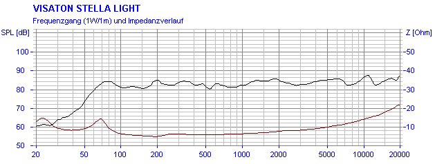

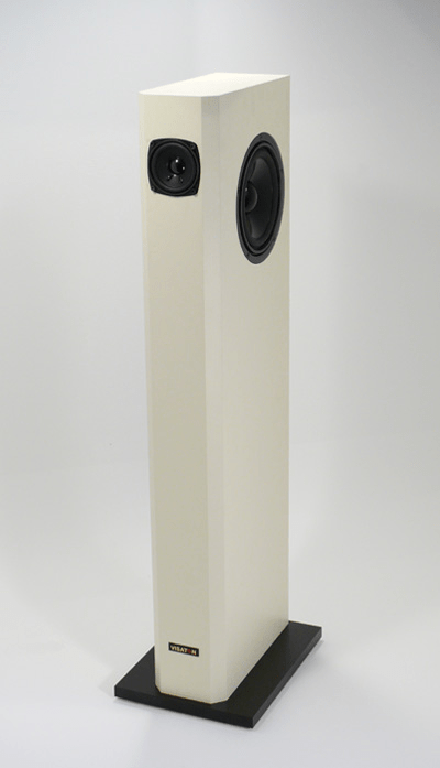

One good simple example is a Woofer assisted Wideband (WAW)
done by Visaton Stella Light
Side mounted woofer naturally rolls off high-end
and tall tower helps improve baffles step
Pretty impressive response for 1st order
Great impedance curve as well.
Even a tuber could love that flatter impedance curve
and not usually so smooth with 1st order

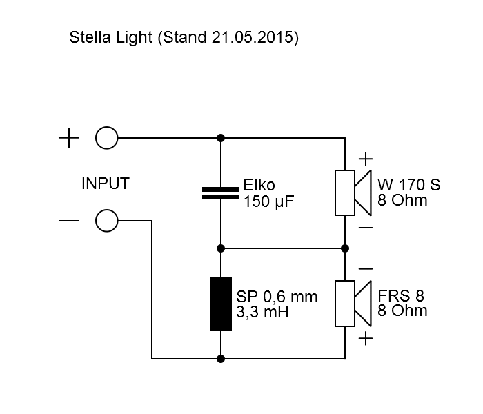

Again the series crossover shown above
with side mount woofer solves alot of problems
not having to hunt for magical woofers and ideal
responses to get a first order to work.
