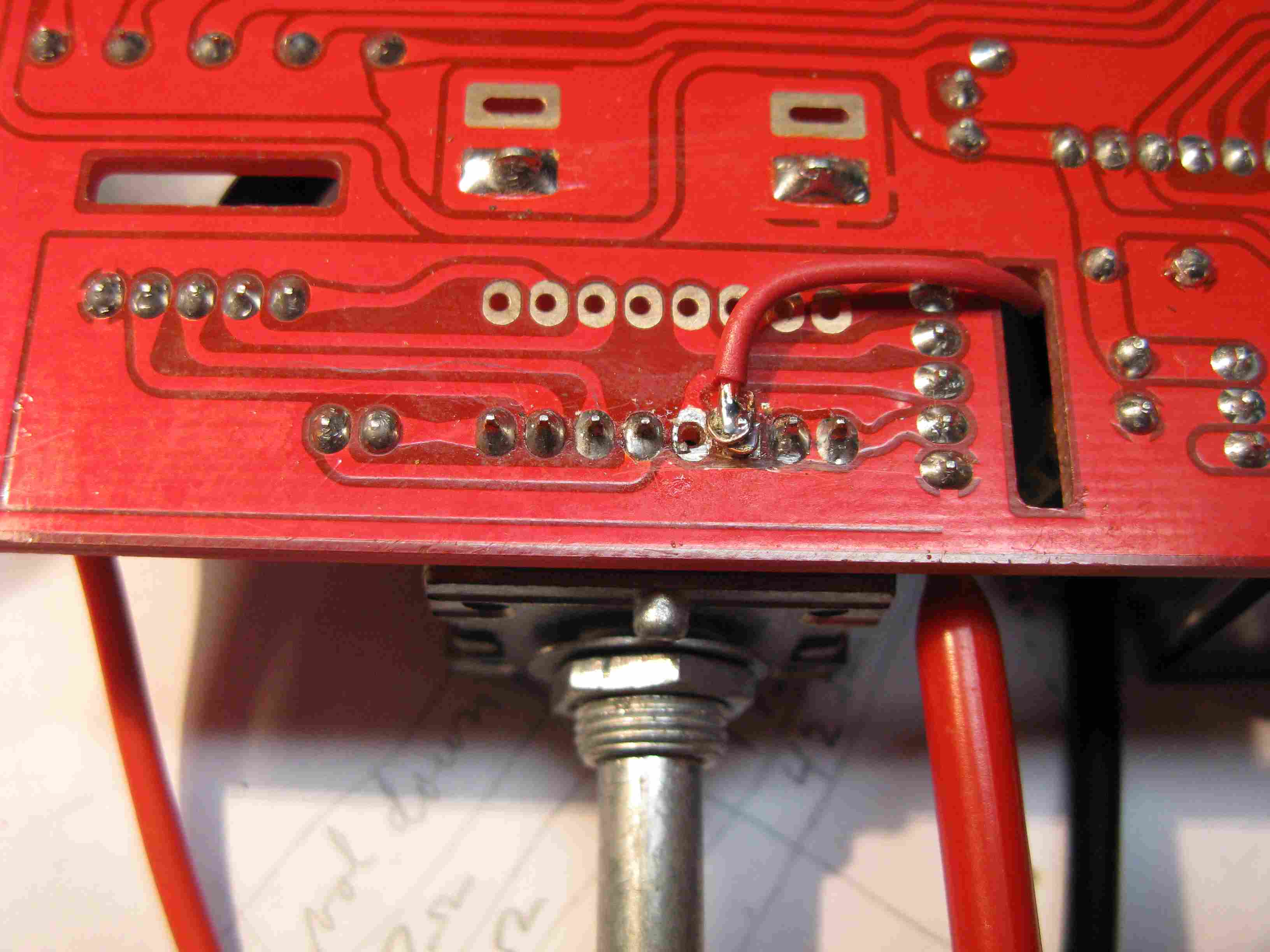

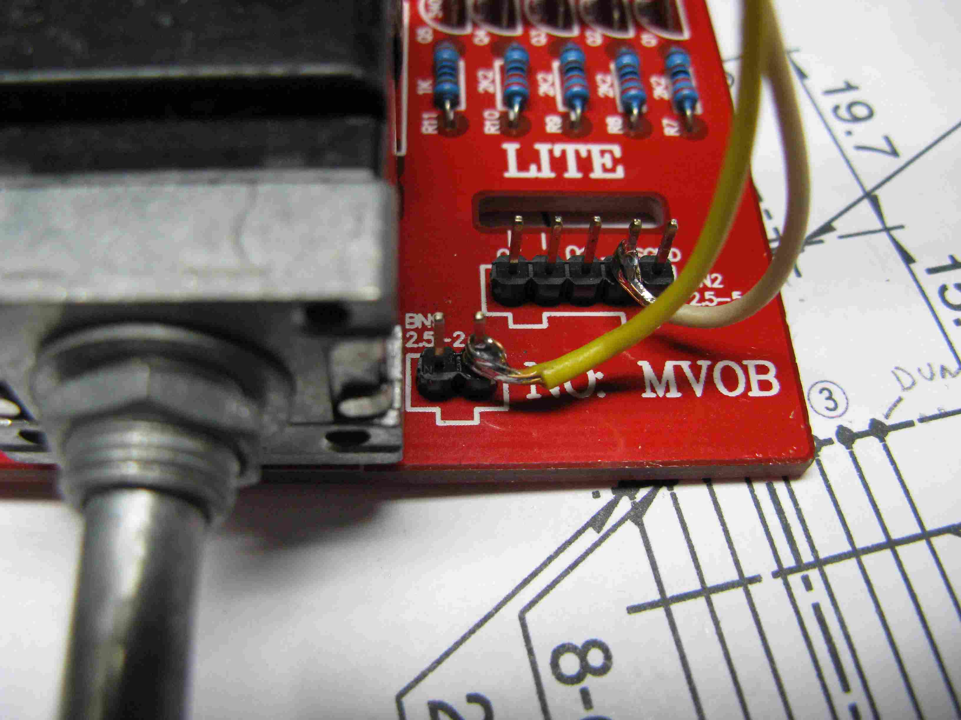

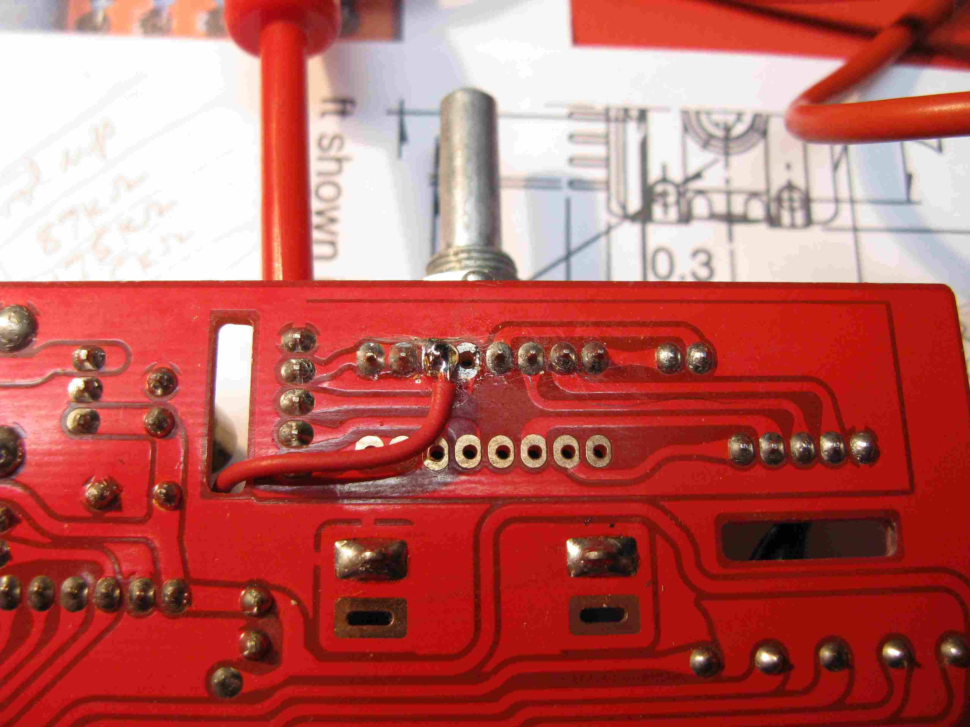

Can't answer your distortion question, but I HAVE solved the remote control/multi input one. But it involves cutting a couple of traces and careful soldering.
I'm not sure if this should be in a new thread..I'll give a "quickie" overview here:
Get this remote volume/multi-input kit from Hong Kong Remote Control Volume for DIY tube Preamp Amplifer 100K - eBay (item 220428580361 end time Apr-30-10 22:47:27 PDT)
Costs $70 including shipping to USA. Cut traces with a dremel or utility knife - I have pix of the work if anyone wants to see. You can then have IR remote vol & input switching.
Keep in mind you CANNOT just "drop this in" and expect it to work. It won't! You HAVE to cut traces! The ground from this remote board has to be disconnected from the motorized pot. Remember, you are going to put +5V thru the pot & you'll destroy your power supply because the pot is connected to the board's ground.
Beware...but it DOES work great if you do it correctly.
Also, note that my link goes to a board that's a little different from dvb's. They aren't exactly the same, but I'd bet the other board also ties the pot to gnd. Batchme001.jpg
