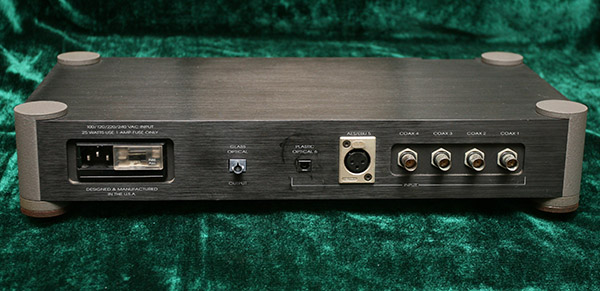

Well I just downloaded the manual for the Wadia 9, and I see the officially sanctioned way of connecting s/pdif to the glass optical input of the Wadia 9 is with the addition of a Wadia 10 Glass Optical Interface.
I imagine a Wadia 10 is quite expensive.

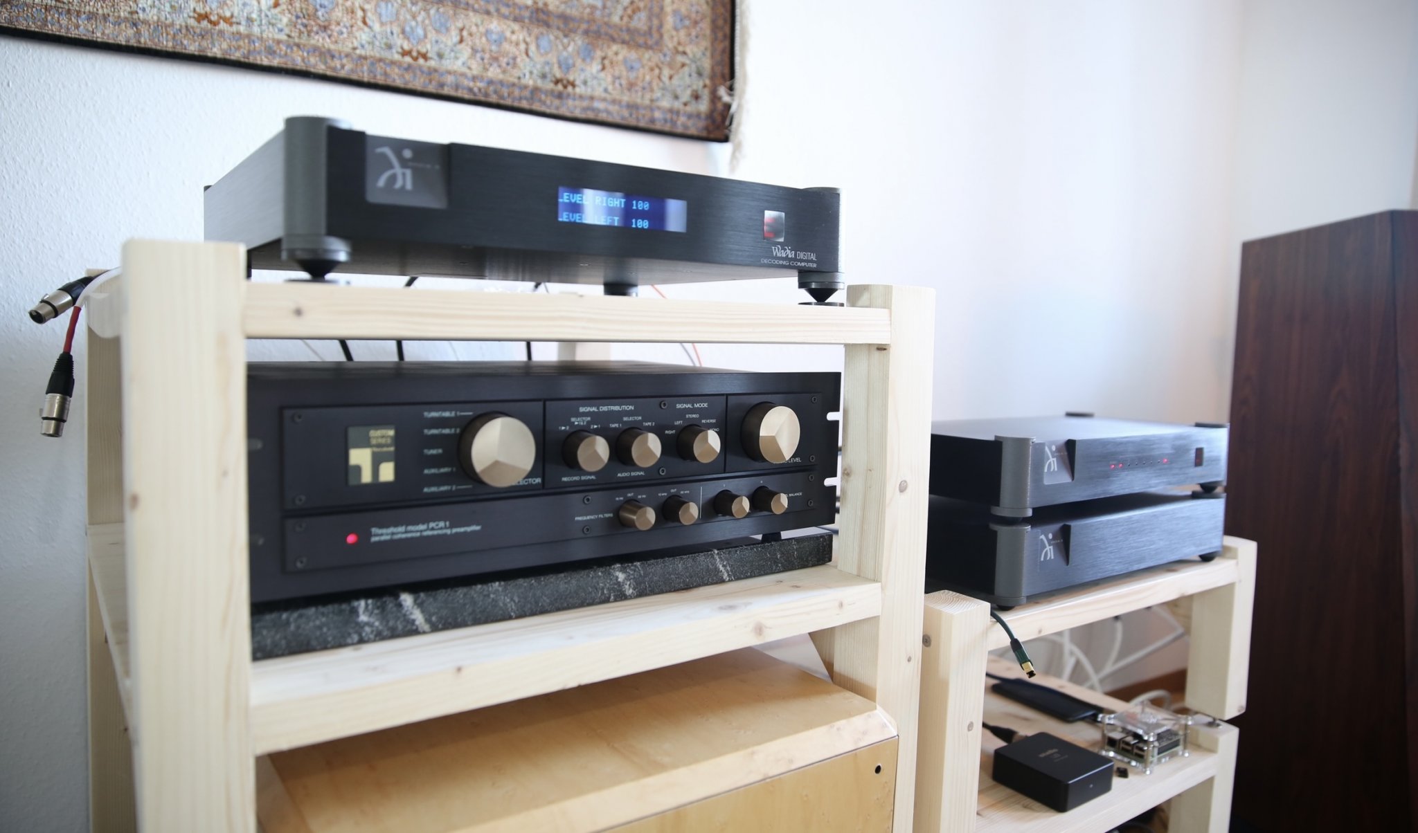

Hi Nounours, there is Wadia 10 which accepts 5 bncs and one tosslink input and output one ST to Wadia 9! problem solved :]
Wadia 10 looks basically the same as Wadia 9’s power supply, and it’s exactly the same size. I have posted a photo of my setup here.
Regards from Germany,
Karl
