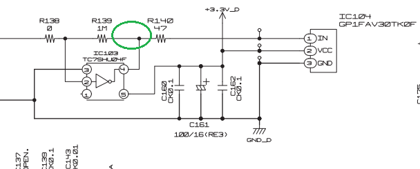

I am in a position to get used CD player Denon DCD-700AE in fantastic condition for cheap. Only problem is it has optical out instead of coaxial S/PDIF that my DAC has.
Looking at the attached schematic I`m a bit confused. I can see digital out from the DSP chip TC94A14FA and then to 74WHC157 multiplexer before it meets TC7SHU04 (inverter/unbuffer-powering led diode?).
At what point (and if it`s even possible) to tap a spdif signal and route it through 75Ohm coax? I actually want to use BNC connectors for this, but that is beside point here.
Unfortunately I am not an expert in digital electronics or S/PDIF protocol so your help would be greatly appreciated, thanks!

I'm out of my lane here, it's been awhile since I've thought about spdif. I think it's less complicated than you outline. the optical part of spdif takes a normal electric spdif and converts it to optical. so I believe all you'll need to do is tap into the line that feeds the optical (called torx??). probably need some additional passive components, a pulse transformer (though that may be on the receiver side only).
do some searches on older adc/dac chips, the inexpensive ones. iirc they have sample circuits for the Dout pins.
again, I could be way off base so what I said will need confirmation.

Cheers Rif for your advice, I was thinking/hoping for something in that direction myself, so you must be right in your approach🙂
Will try to find some references including "lampizator" pages, because he knows the best😉

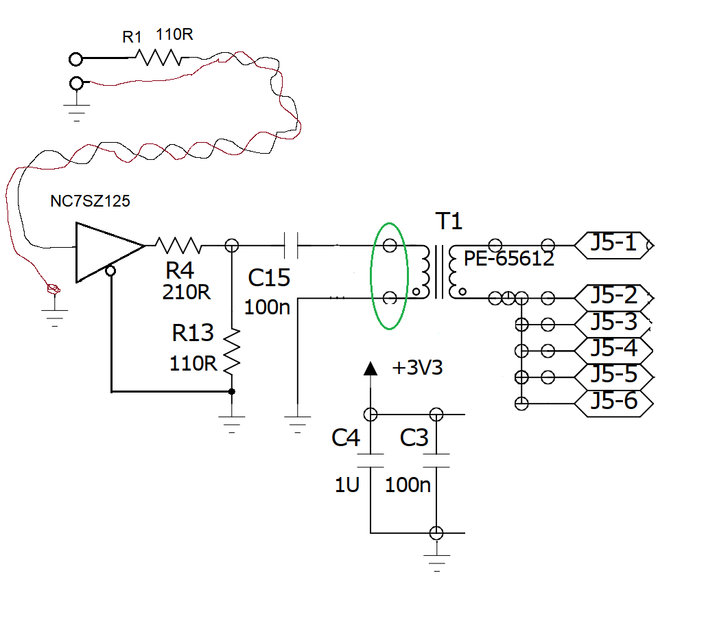

My spdif switch project Whazon will perform well. But since you'd rather not having an extra box, there are other ways of doing it. If you are willing to add a BNC outlet to the CD player, the attached circuit will do it well. R1 taps off the TX feed to the existing optical output module. The logic buffer NC7Z125 and all the parts around it can be arranged on a small PCB attached to the back of the BNC connector. C3 and C4 should be placed near the power supply pin on the buffer. R4 and R13 make an equivalent output Z around 75R. If not needed, the BNC can be put where the transformer primary winding is.
