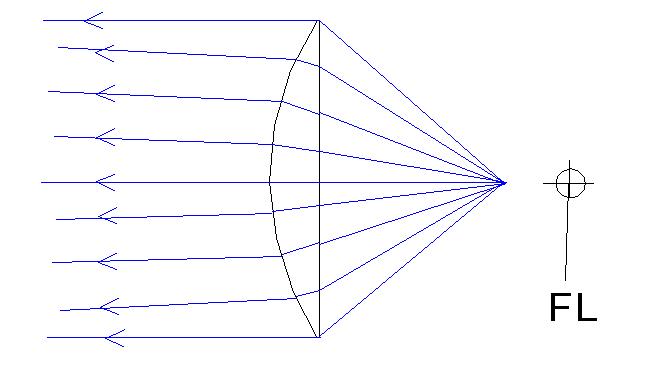

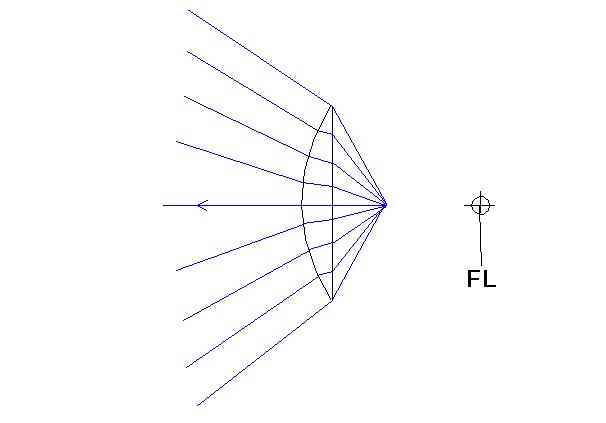

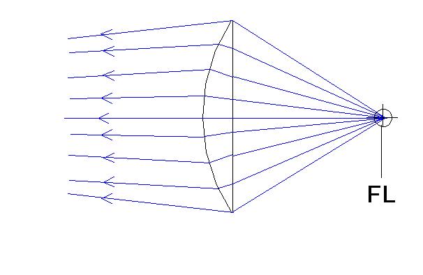

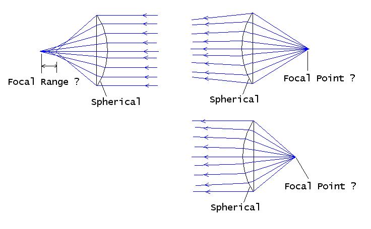

Just so I understand this correctly, the equation for a PCX becomes:
I plugged some numbers into the equation for a 50mm diameter DCX, 250mmFL, and I got a focal error of 3.44mm. I then used the same numbers but made the diameter 100mm, which gave a focal error of 13.78mm. These results seem to be with-in reason. When I tried to use the modified equation without the r2 values, the results went out the window. After re-reading your response,
The formula is general for all lenses with two sperical surfaces, you just need to know the radii of curvature for the lens, and its focal length, etc. I think that is what you are asking, but I'm not sure.
I must have missed the bit where you said “two spherical surfaces”, So there must be another equation for PCX lenses (single spherical surface).
DJ
No not at all, a flat surface is an infinite radius of curvature, and 1/infinity = 0. So your equation was right. If you know the focal length of the lens you can determine the radius of curvature using:
1/f=(n-1)(1/r1)
Hope this helps.
