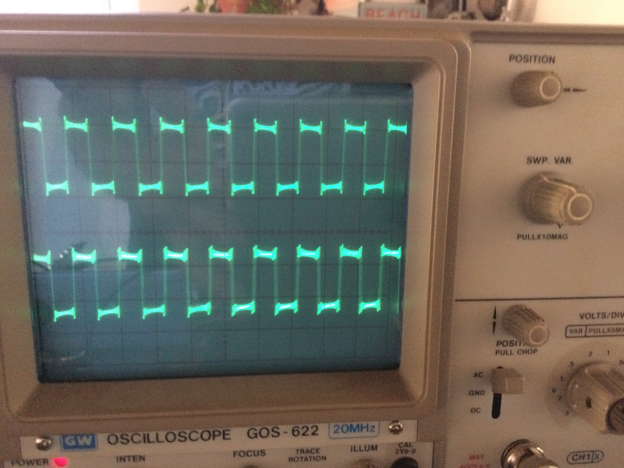

I continue testing with the oscilloscope, and when I put on the square wave, which is not very good because it comes from the cell phone's function generator, at maximum gain I hear a slight hiss coming from the amplifier, what is this due to? Is my amp oscillating?
It is a 1khz square wave, with an 8ohm load.
What you hear with all the gain is the square wave tone, but it doesn't come out of the cell phone, something oscillating?
Looks about right, for a square wave with sharp filtering and low phase shift.

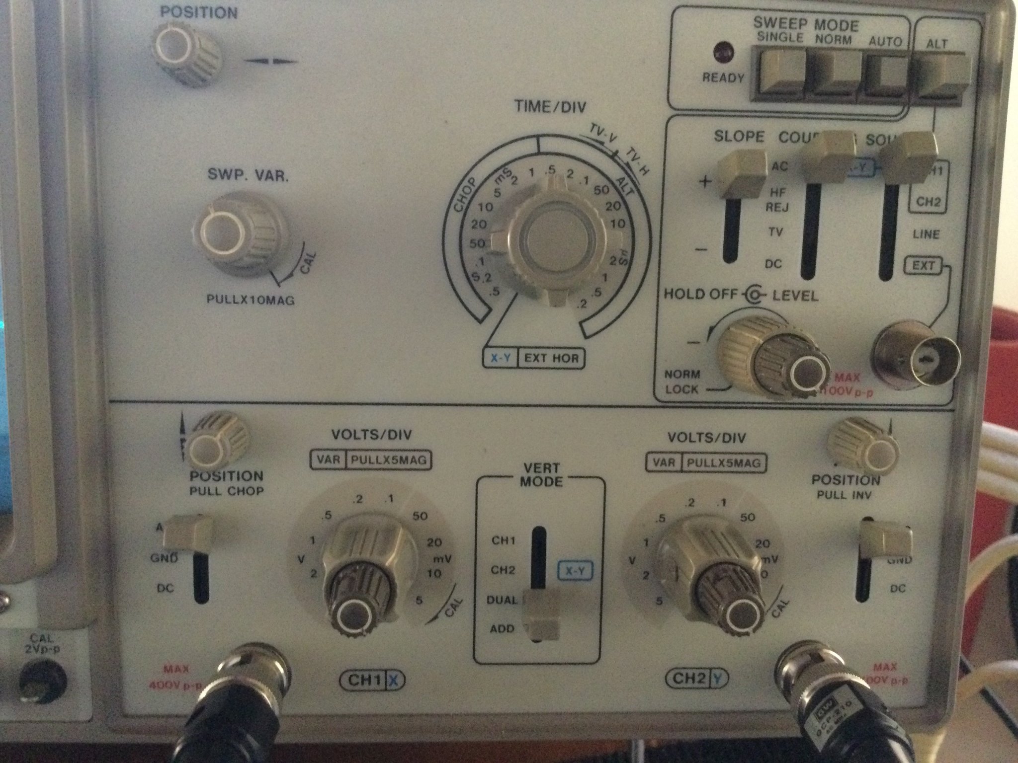

Use DC input coupling to avoid the tilt. Show only 1 or 2 cycles, with better focus.

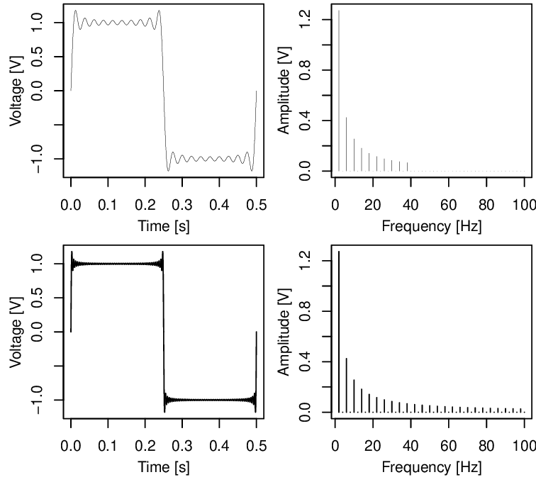

The "ringing" is from the ABSENCE of higher harmonics.
  • Example-of-square-wave-showing-Gibbs-phenomena-in-time-and-frequency-domain-with-m-5.png

Not good or bad, that's just the way it is. All systems are inherently low pass.
If you lower the input frequency, there will be less ringing, because there will be more harmonics,
since the bandwidth is constant.
Guess what a 20kHz square wave would look like if recorded on a standard red book CD.
Answer: a sine wave. No harmonics at all.
