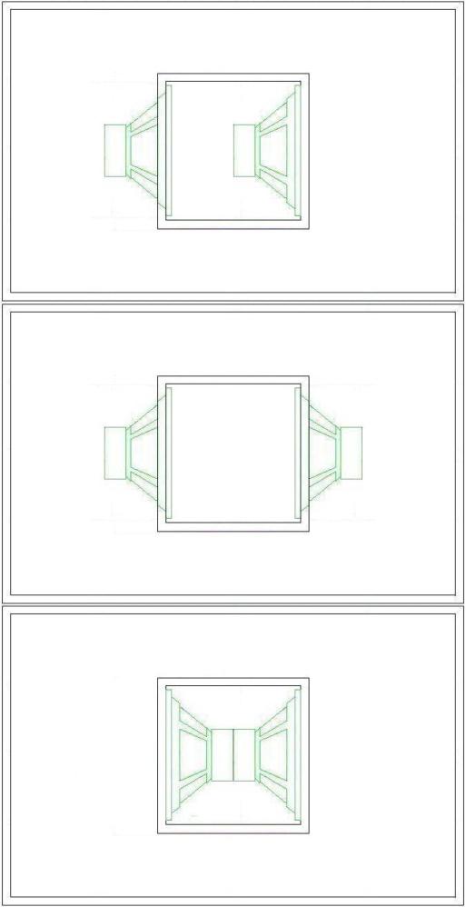

Hmmm. 3 different ways of mounting 2 drivers in a 'torus'.
The top one in my illustration would have to have one wired out-of-phase anyway, as it's a single enclosure. If had them in phase, then the subby would be rocking along with everything around it (and probably pole on the first really big bass note). Easy to mount and dismount the drivers, but difficult to support the magnet of the driver on the right. Unfortunately, the wiring would be part internal, part external.
The middle set-up would mean that I could easily support the magnet and spider internally and that it would be easy to mount and dismount both drivers. It doesn't sound like much, what with a 7kg+ magnet and a cast frame, but you can sometimes get the frame to 'sing' with the right tone and this is my excuse for magnet support. I notice Dave uses lots of absorbent stuff on his modified drivers which probably does the same thing. The wiring up of the drivers would be internal, and as the EP2500 can pump out some reasonable current/voltage, that might be good too.
The bottom set-up would be easy to wire up, as it would be all exernal. But it might be a bit of a squeeze to get the drivers in and out. And it would be a hassle to fit any magnet bracing.
All of them would be pretty much rock-steady, as the drivers would be moving in opposite directions - no difference there. A pity I can't mail John Kreskovsky to find out what he thinks of the arrangement and which would be best for removing harmonic distortion. Is it the physical direction in which the drivers are facing (in which case the bottom 2 would be better) or the direction of cone movement (in which case the top one would be better)?
I think I'll have to persuade my other half that we need a bigger stereo room so that I can build the thing 🙂 :angel: 🙂
