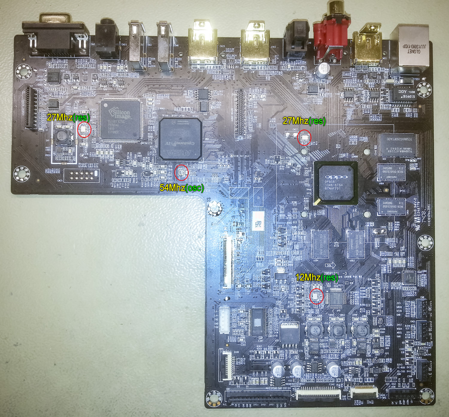

Having a 105D main board on my bench, I took a closer look at the clock system on board. There is hereby a picture of the clocks distribution for the different stages. The 12Mhz clock on board is designated for the USB responsable chip. This clock it is not important for improvements purposes, so let`s ignore it.
All the clocks are internally generated by these chips, based on resonators, except the Darbee processor, which it have a 54Mhz oscillator. As I can see Oppo designers cared a little bit more for the Darbee clock circuit. A ferrite bad it filter first the power for this oscillator, then three different values/types caps, are used as filters, after the ferrite bad. The Darbee processor is AC coupled to the oscillator output. Comparing this clock approach used for Darbee chip with the rest of the main chips, it seems that the quality of the clock signal for Darbee processor it may be quite critical.
Another observation I have is the physical dimensions for Oppo main processor and the Darbee one. The main processor it have two HDMI channels, and is smaller than the Darbee one, which is meant to process only one HDMI channel. Taking the dimensions of the chips as a criteria, one may conclude that the Darbee processor is a lot more powerful and extreme complexe, while the Oppo main processor is smaller, even though it have to manage with two HDMI outputs, and the whole rest of the device control, memory controller, audio decoding, and so on...
My main thought is in this respect is to unify all these clocks spread over the whole board, as their frequencies it show it is possible to have only one oscillator as master clock, then divided accordingly to obtain the necessary clock signals for the targeted chips. I appreciate that I may have a quite good solution for such modification/improvement. I have already a 216Mhz Epson SAW oscillator, and the divider I also use together with my battery powered clock board. I think I will give it a try to clock the whole device from only one 216Mhz oscillator, including the DAC chip...
