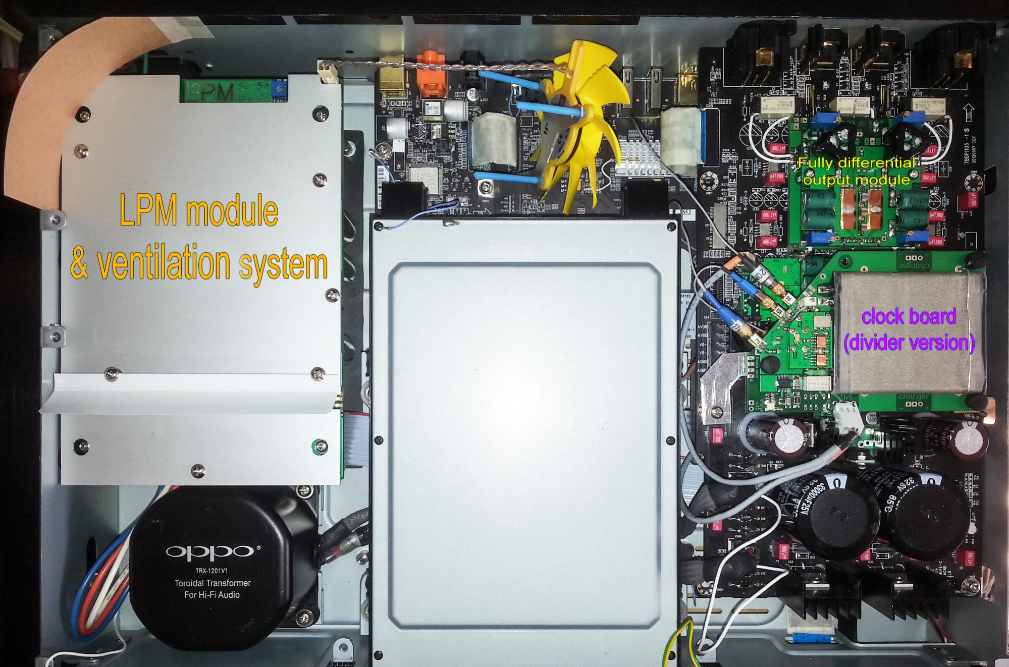

Recently I have got an Oppo 105D.
The sound is not correct.
Where can I buy Coris LPM for it.
You have a PM.

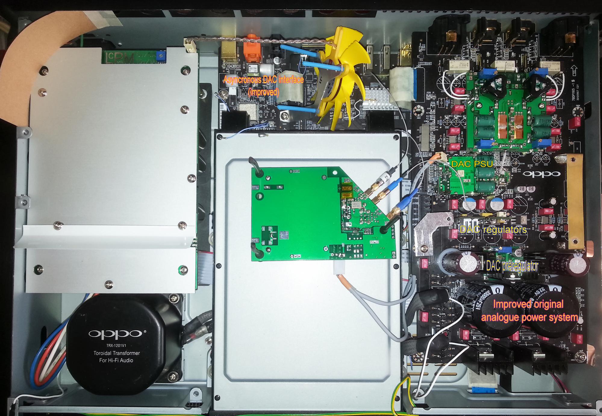

NicMac,
in fact, there are a lot of things you can do very inexpensively to improve the 105 substantially.
For example, I have removed the output coupling capacitors. This alone will reduce the grain on the output.
I went further and installed a linear power supply (from OPPOMOD), disabled the multichannel card, added shielding, and added decoupling capacitors to the Sabre chip. I also added a balanced transformer to the input of my amplifier. I also added some chassis damping, and Sorbothane vibration isolation.
This provides substantial improvement to the 105.
These and many other ideas are discussed throughout this thread. You should also ensure that you are providing clean power to the unit.
