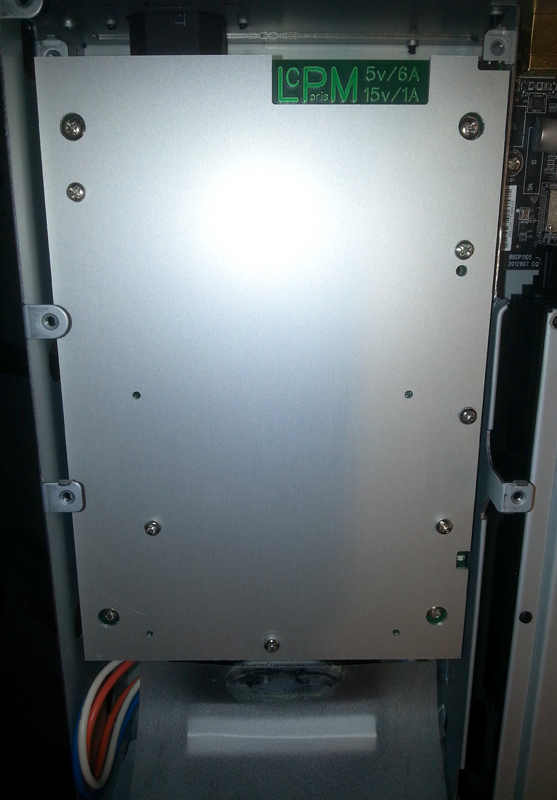

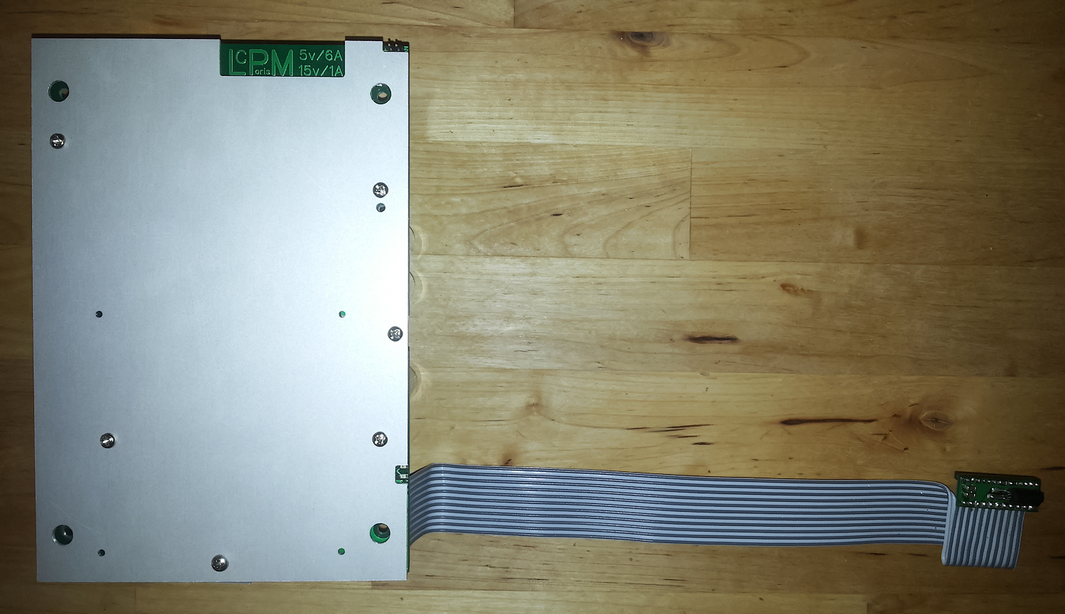

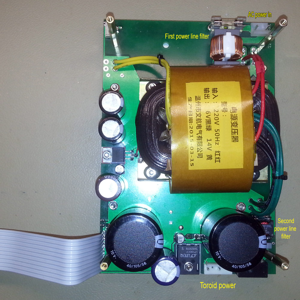

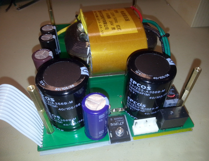

Well, I think to come now with some more details about my LPM.
As one could see in the previous pictures, there is about a more professional approach for an serial PSU for Oppo BDP 95, 105 and 105D models.
This LPM is not suitable for the 93 and 103 models, as these models needs few more power rails.
My LPM it have a first power line filtering cell at its input before the main transformer, then a second (cascaded) filtering cell for the power designated to the original toroid (analogue PSU of the player). Optional use (choosing) of 115v AC is provided by design. The original 110/220v AC switch is not used. AC voltage input is set it up at the assembly stage.
The PCB is designed to accent both R core transformers, as toroidal ones. If toroid transformers should be used, then it can be one for both rails (5v and 15v), or two, one for 5v rail and one for 15v.
The rectifier stages it use Schottky diodes. For 5vDC rail are used two 8A diodes, so the transformer should deliver 2x6vAC. 15vDC rail it it use two or four Schottky diodes 5A, accordingly to the transformer setup (2x 15vAC, or 1x15vAC).
I decided to use an R core transformer, for its advantages: highest efficiency, and most important, the best HF noise separation/isolation primary/secondary. This type transformer it have the lowest internal capacity, and therefore it transfer lowest level HF noise from its primary winding to the secondary. The toroidal type is worst in this respect. Of course it should not be necessary an power line filter, if a R core transformer is used. However, the PCB is designed so, especially in case it may be equipped with toroid transformers. I chose to use power filters anyway in this illustrated here PSU, more for experimental reasons.
The regulators used are LT adjustable series 1083 and 1086. The adjustable series of these modern components it offer the possibility to be improved even more their output performances.
The filtering stage it consist of strong capacities of over 100 000µ for 5v rail and over 10000µ for 15v rail. As the 15vDC rail it have to power a relatively low current hungry stage, the filtering capacity for this rail is quite huge, so as it is in my LPM. The filtering for 5v rail it can use two 56 000µ caps or 10 x 10000/20000µ, as the PCB is designed for both options.

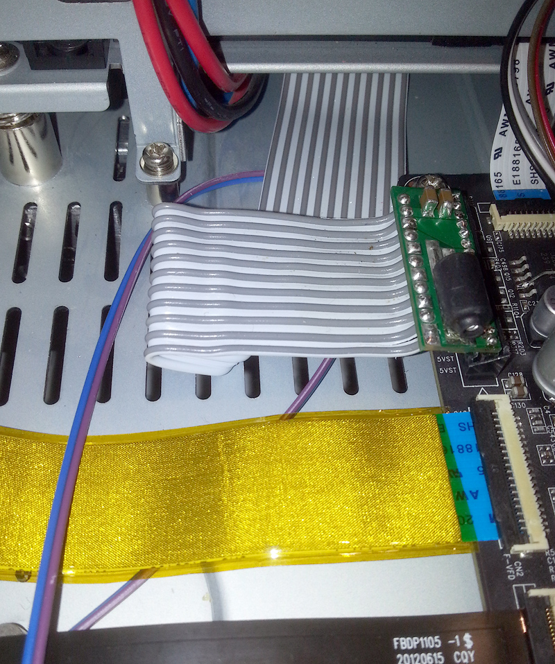

The flat cable used to make the connection LPM - main board is equal balanced for both grounding and hot lines, and it provide an extra filtering for HF noises right on the final adapter for main board connector. This end filtering is meant more to prevent the inducing of HF noises generated buy the digital circuits in main board, back into the power supply. This approach it minimise quite much the overall noise level of the system.

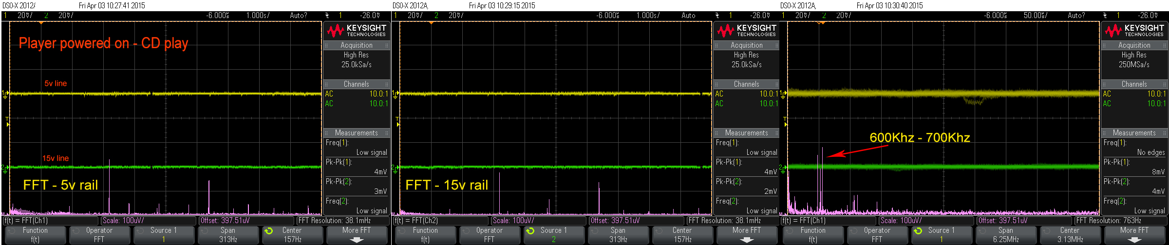

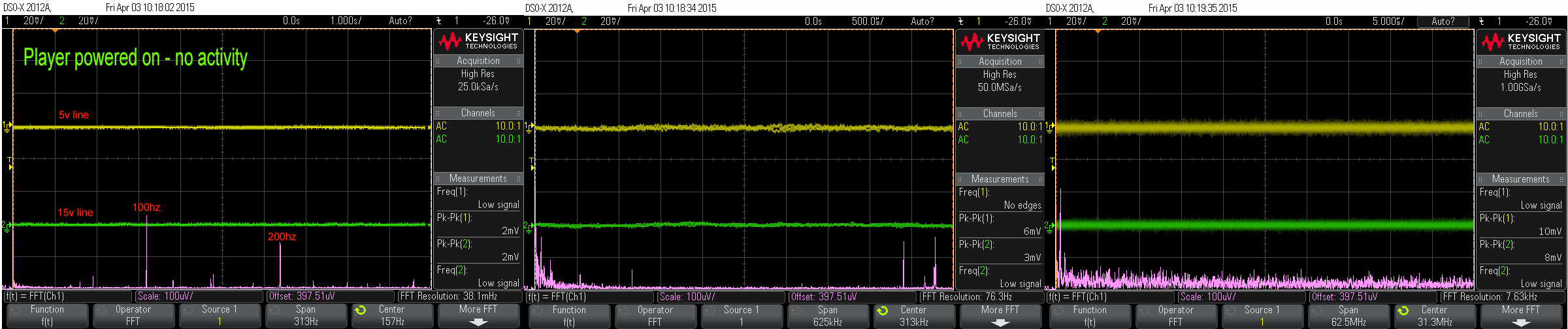

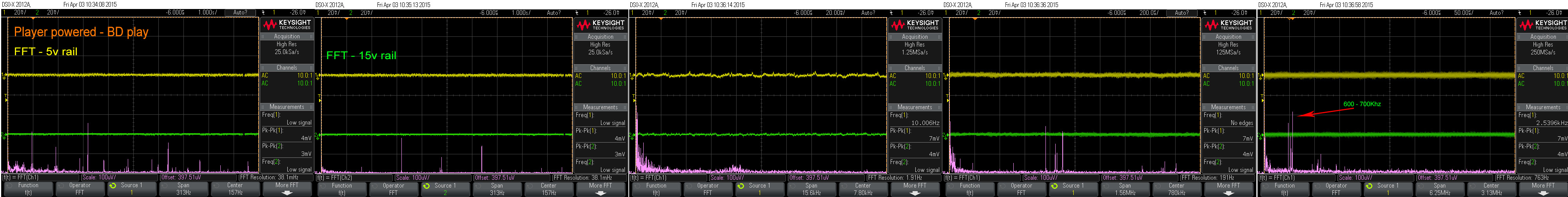

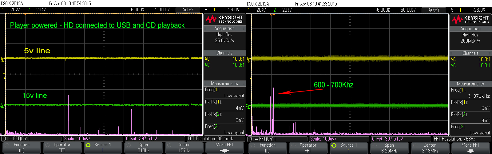

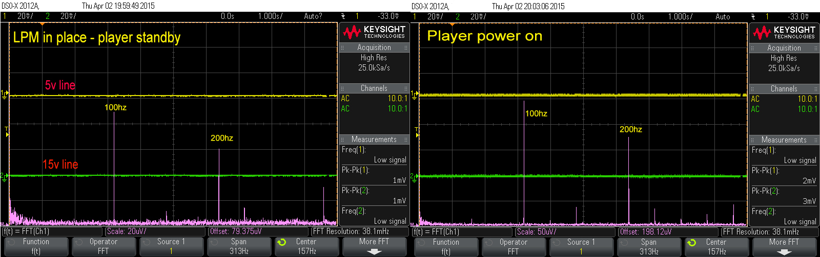

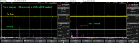

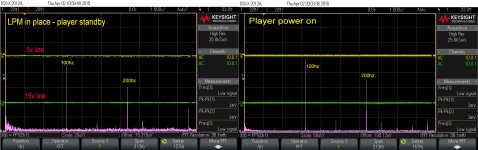

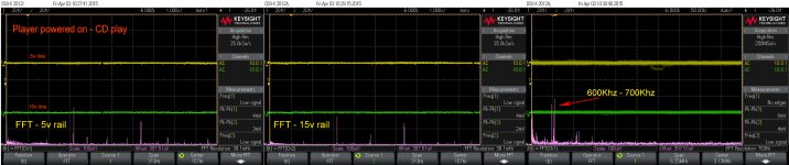

There is a picture here, showing my measurements setup. I realize right now that it was a little bit fault in this setup. I should placed the measurement points before the final filtering cells, but not just on the main board power inputs... However are measured so, the power rails right at the main board input points.
I add here some scope snapshots, using the measurement points as illustrated.
The scope is set it up for high resolution measurements, as this option is much more appropriate for relative low frequencies domain.
The noise levels of the LPM is showed by FFt diagrams, and how is to be seen, it shows around 200µV noise (100Hz ripple and quite few HF picks). The HF picks are induced noises from the digital board.
By adding this quite high quality LPM, the overall improvements for an (already modified player) are important for sound, but the most dramatic impact it have this LPM for the video stage. The image is just exceptional!
I forgot to mention some details about the PCB itself. The circuitry is printed on an double thickness copper foil board, with very large ground and hot line areas/traces.
The design include too an servo power circuit for an ventilation fan. This fan it can be powered from either 5v or 15v rails, and its current it can be adjusted. The fan power stage on LPM board (controlled by the player power up sequence) is carefully filtered and designed to prevent any eventual noises to be induced into the main rails.
Both regulators and the rectifier bridges are thermally connected to the (upper side) heat sink.

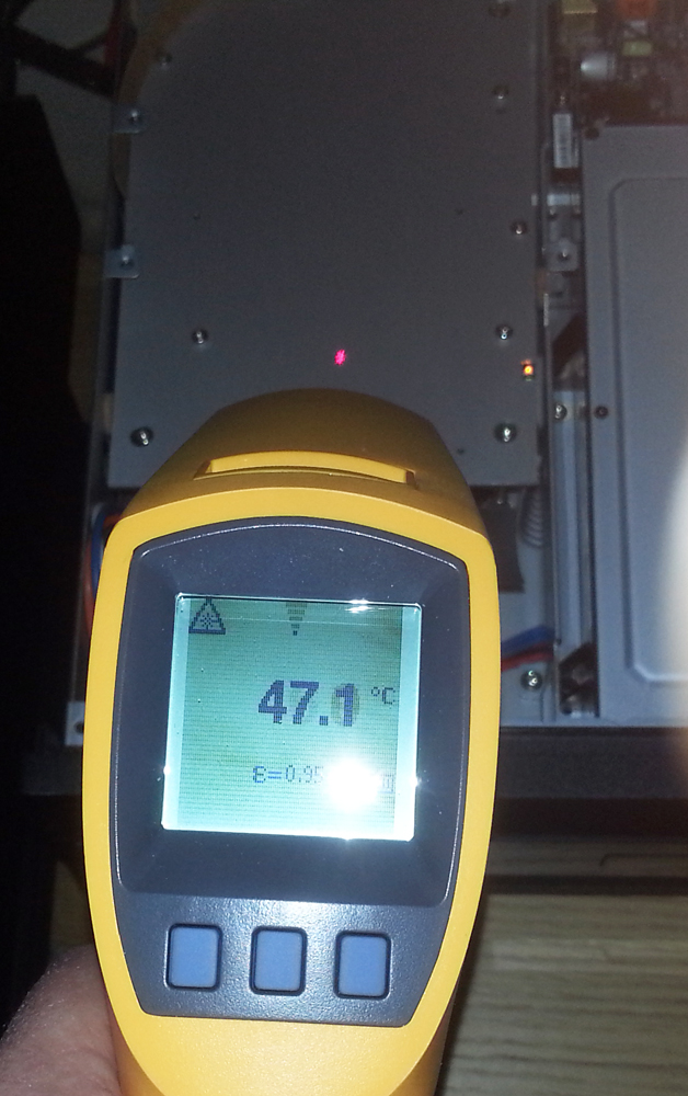

The heat is present, as it is a serial PSU, and it dissipate a little bit. I measured on heat sink, for an relative normal load (player in use, with CD activate, and one HD connected to USB), and the fan running, 48 dg. C. The heat at the cover air output is barely perceptible, while the enclosure air input area is at room temperature.
There is need for a fan to ventilate the enclosure. So as I use the fan set it up, is completely inaudible, but only one put his ear right on the enclosure cover.
