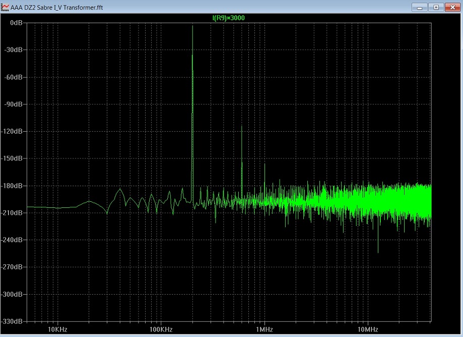

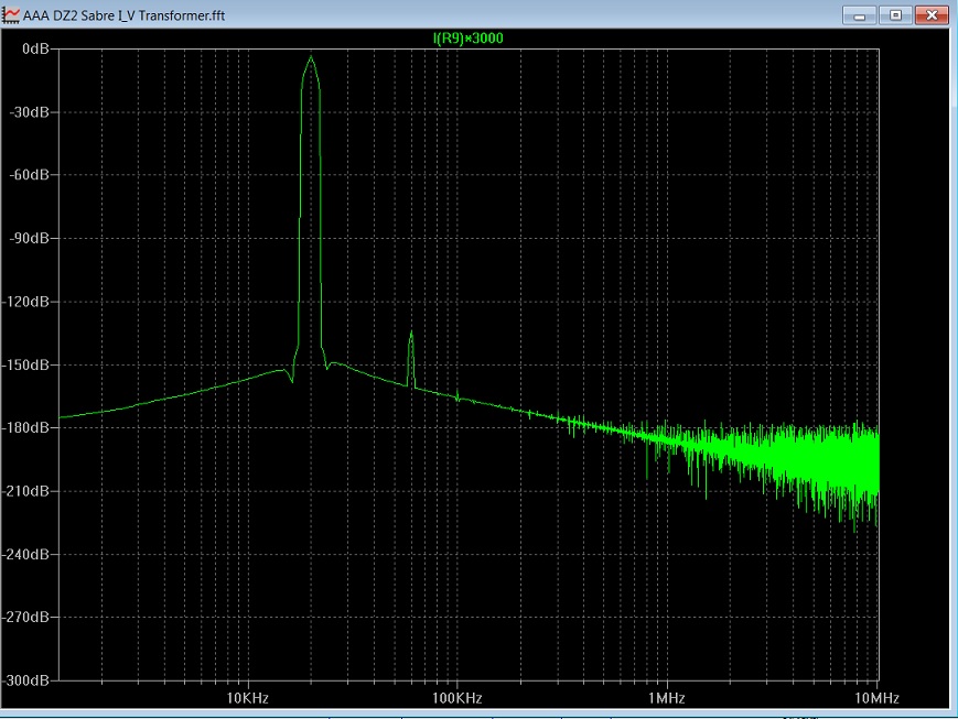

Yes it's a good solution for quick and easy I-V.
I don't really have a way to measure my I-V, however in the development I
did a lot of spice modelling to find best operating points.
A major focus was to be able to deal with HF content of DS DAC's like 9018.
So important criteria were:
a/ no feedbacky open loop (discrete) design,
b/ very low high frequency distortion
c/ Low thermally induced distortions.
d/ Transformer interface to following equipment.
Ref to pics below of the initial ltspice simulated results without transformer.
20kHz / 200kHz / 2MHz (yes that's 2MHz)
These FFT's show very low THD, even at 2MHz it is very low. The design
is such that thermal distortions are cancelled to a large degree.
In real life these types of numbers would not be achievable but allowing for a
factor of 10 x or so and as you can see the design is very good.
I did put on a standard (not upgraded) stereo output (opamp based I/V etc) Oppo 105 and no doubt the THD is a lot lower, but I can see significant odd order distortion products and peaks at 5th and 10th. You can also wee some 7th (arguably the one to keep an eye at), but and less but some 9th. The sound is nowhere near the same.
You have to be careful as it looks like you might be measuring distortion of the
test set itself. A decent Sabre 9018->opamp I-V can easily measure lower
than your test sets baseline.

Very impressive sim results. Is the input stage common-base/gate?
Ken,
Can't say too much at this stage but it presents a <1ohm impedance to DAC,
has no coupling caps, has high current OP buffer direct coupled to a
mammoth nickel core transformer. The transformer can drive any load /
unbal / bal with full galvanic isolation.
The design has a unique feature that self cancels distortion without any use
of feedback / feed fwd / EC etc - as such it also cancels thermal modulation
based distortions. However even without the cancellation part it still has very
low distortion for open loop (around 0.003 or so).
It will also preserve the full DR >130dB of ES9018.
