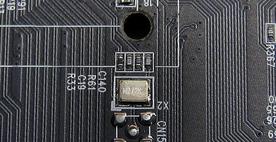

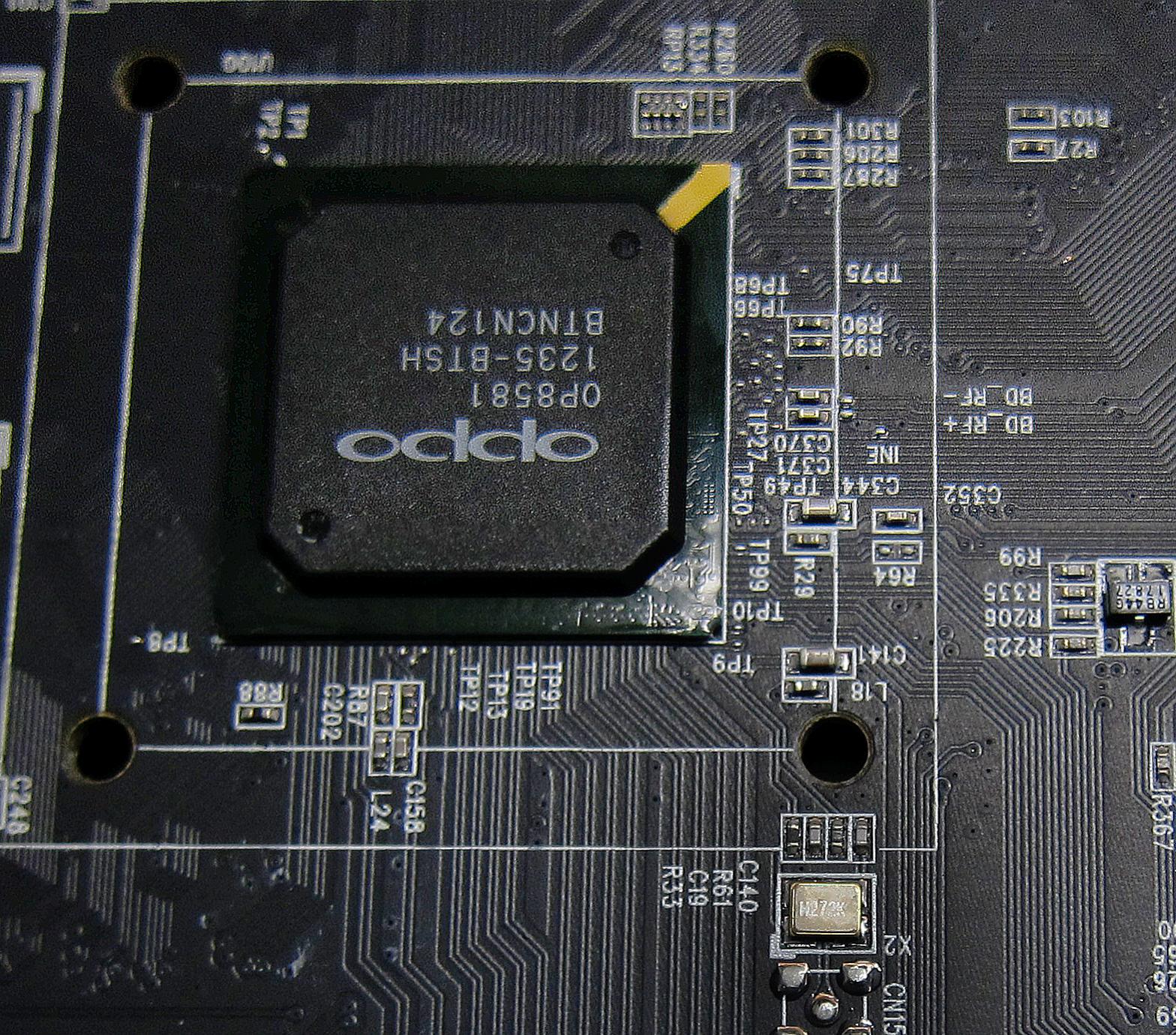

Hi Guys
Looking at that 27MHz on the mainboard - you have to remove the entire board to remove the OP8581 Mediatek chip. Remove 7.1 board, the stereo board then remove entire back panel, then finally remove digital mainboard. Only then can the heatsink be removed by squeezing the ends (four plastic 'harpoon' ends) one by one and off comes the heatsink with it sticky (clingy) thermal pad.
I reassembled everything - can simply push back heatsink when finished - and I can operate the player carefully without yet pushing the pins in. Checked running an audio disk for an hour (no heavy video processing, which may not make a difference anyway) and estimate the heat to be 40-45C. So I would not recommend running without heatsinking.
Take a look at photos attached. The caps C19 and C140 I don't know the values - but they will be a few pF. R33 is 10R and R61 is a typical 100K.
To insert a clock signal, the two caps will need removing and also removing 10R may in fact isolate the Xtal so that it need not be physically removed. We shall see.
Cheers, Joe R.

Nice job Joe! It looks like Oppo have designed specially this way, to make it difficult for they who want to mod their machines...😉😀
I see that this oscillator is marked X2. The question is where is X1, and what is used for... The same notation it were used for 95: X2-27Mhz, X1-25Mhz...
It may be X1 the clock for QDEO video processor?
I will take soon a close look on my device.
Nice job Joe!
May in this instance Oppo is following this logic: X1 is 54MHz for Sabre DAC and X2 for the single main system clock. I don't see another X1 anywhere else. There are no clocks under the board - wish I had taken a picture of it, but sure I didn't because there was nothing there. Interesting, I removed three boards and all components were on the upper side.
Oh, on the photos I took while I had the player open, I do see an X3 - nearer where transport ribbon connector is - not sure what the frequency is, but it is not clocking anything in the OP8581, not at that location - near a Weltrend WT61P8. Some kind of display controller chip?
Cheers, Joe R.
Yes is right! Sorry for my "logic" about X numbering... X1 is the DACs clock (my earlier picture here), X2 is for processor, and maybe X3 is for QDEO chip...
We have now something to start from...😉 Nice (hard) work to come...

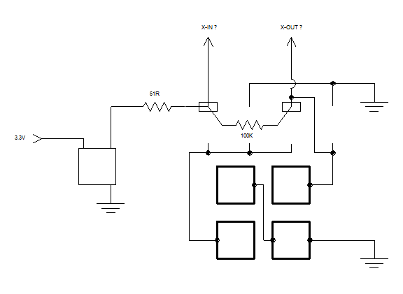

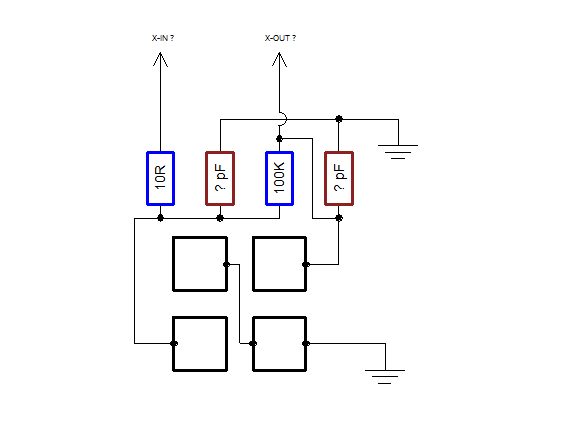

I would like somebody to take a look at this - see below attached Gif files.
The first one shows how it is traced out on the Oppo 105 here.
Note that I am guessing X-IN and XT-OUT.
If that is correct, then I propose removing all four SMD components and insert 100K resistor as shown. That way the Xtal does not have to be physically removed. Personally I find that a good idea - also makes reverting it back a lot easier, if need be.
Other than that, simply remove Xtal and SMD caps.
Note: If anybody knows a manual of a Bluray player that uses MT8580, we can confirm which is X-IN and X-OUT. Based on memory and if the orientation is similar to the past, then my guess is correct. If not, then revert to the other side to inject clock signal. Simple trial and error and 50/50 chance.
Cheers, Joe R.

About wiring of the oscillator here I will think to an analogy with the 95 model. It may be the similar design, and the chip for sure do not have any changes for the clock pins, comparing with the old model.
So, in 95 model the clock were injected on X1 crystal tab 3 (pin 3). I think the designers used the processor corresponding pin as clock IN and another corresponding pin as clock OUT. This design it may also be similar for the 27 Mhz clock on backside of the motherboard of 95 model. There may not be important reasons that this "logic" and design it will be modified for this new processor model (105).
So, my supposition is that the clock IN pin of the processor it may be connected to the pin 3 of the 27Mhz crystal (105 model).
I fully agree that the most reasonable way is to remove the passive components around this crystal to isolate it, and do not desolder it out from the board.
I will want to identify the trace which goes from the pin 3 of the crystal to the processor, and I will want to try first to connect there the new clock signal (after isolate the crystal).
There are of course 50/50 chances that this logic may be true. So if it does not work this way, then one may connect the clock signal to another processor pin...
In general the design of such clock inputs are made to function well for both way of use: crystals and oscillators. So, may not be catastrophic if one connect the oscillator output on the so called output clock pin of the processor. I will want to use first an 27Mhz oscillator as clock, to see that all may function as it should, and then try something else...
