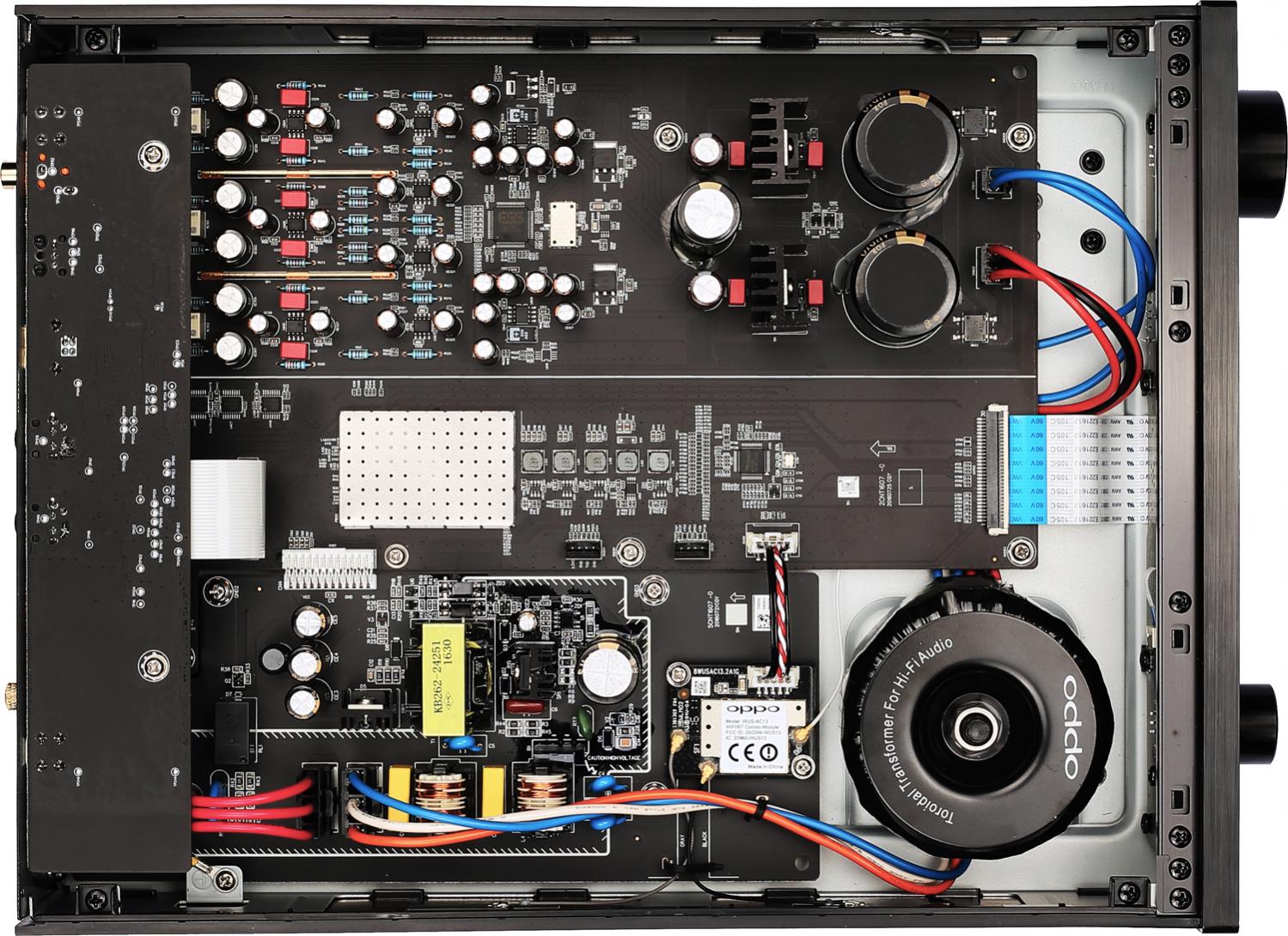

Well, Oppo`s Sonica DAC looks quite nice from outside (almost same design/look as HA_1). Let`s take a look inside (as Oppo have recently published the inside picture)...
First thing I wanted to know it was what kind of DAC chip they actually use. As known, ESS have recently released a family of new (upgraded) Sabre version chips, as some dedicated low noise regulators for these new chips.
I took a closer look at the internal picture of Sonica. There is not possible to see the marking of the DAC chip soldered on PCB, but looking at the marking of a ES9038pro, there is a very distinct difference between the chip inside Sonica and the original ES9038pro chip (see bellow comparative picture)...
It looks like Oppo use something else than 9038pro. Maybe ES9028pro, or ES9026pro... But they advertise for 9038Pro inside... Something I can not get it so far...
Else, what more we can see?
There is (another observation): the same design approach for DAC analogue section as for Oppo BDP players. The DAC 8 output channels are configured and distributed in between (most likely connected 2 + 2) the RCA and XLR outputs. Not known what kind of I/V and buffers opamps are used, but it looks to me the I/V are fully differential devices.
The DAC clock it is a little bit different, it seems well shielded, and I have a mistake that it is not an oscillator chip based, but maybe a PLL based one... I could see quite many components under that shield, and such may not be necessary for a usual oscillator device... Well, this supposition it stil be confirmed or not...
The final outputs are AC coupled all...
What is very disappointing (in my opinion) is the further use of a SMPS for the digital stage of the device. The whole power Sonica it need, is specified for 30w (included the one for analogue stage) This it mean that the power necessary for the digital stage is even lower (something about 20w or so). For such low power it was much more beneficial for the device overall quality, the use of a fully linear PSU, for both digital and analogue sections. I think this SMPS approach for a declared high end/quality DAC is really unfortunate and even wrong.
As we can see in the Oppo specifications for this device, the dynamic range as signal to noise figures are 120dB. I find this quite strange, when the ESS advertise for the new 9038pro chip an huge 140 dB level. There is not a very important improvement in this field comparing with HA-1 (ES9018 chip based)...
What is good for this new Oppo DAC (my opinion) is the upgradeable firmware.
In spite of all these above negative observations, and if the inside ES9038pro it will be confirmed, I will buy this device. Why? To modify it. Only modifying it this DAC it will become indeed a very high-end audio piece...
Oppo continue its "tradition" to give to the moders a work to do in this field. This is quite positiv in fact...😉

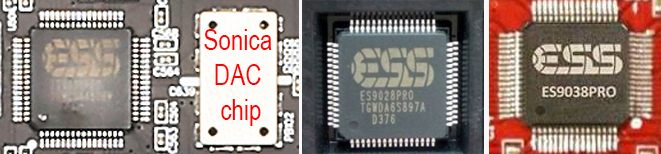

Well, I found a better picture of the DAC inside Sonica...
It is clear enough, out of this picture, that is about ES9038Pro into the Sonica DAC.
But what about the quite different marking of the ES 9038Pro chips out there? There are some other kind of copies of this chip out on market? It is this possible? Quite confusing...
I can see better in this picture that the clock is well shielded. There are not components to be seen under the shielding, but only the ground soldering pads...
What it may be inside the clock shielding, it still be discovered... It could be a usual oscillator chip and its power provider device...
I think the picture with the red PCB is photoshopped. Looks like the marketing pictures on the ESS webpage:

However, there is one marking on ESS official/original sheet, we can not find on the Oppo picture of the DAC inside Sonica... The marking on the ESS sheet is the same as the one in the red PCB picture I found...
It is quite clear that are two different markings of the ESS9038Pro chips. Why? Which one is the real? Or it are both real/original? It could be two production versions of the same chip? In such case which it may be the differences in between?

Referring to the marking confusion, I pointed out on my previous posts, it looks like there is a reasonable explanation.
There were different production batches (pre production, and full production). As there is known the pre production chips it came out with some issues, it is advisable avoiding the use of that specific marked chips, which it could be on marked out there.
The right marked chips it looks like the one inside Sonica DAC...

Sonica all op amp outputs, albeit good ones
Sonica uses LM4562 op amps for I/V conversion and the single-ended outs. The balanced outs use LME49724 op amps. Probably not possible to get 140db without going with low impedance discrete bipolar amplifiers.
Did I mention that the +12v, -12v, and +5v voltage regulation are all by fixed three-terminal regulators? An homage to 1995 and the design of the Marantz CD-53/63?
