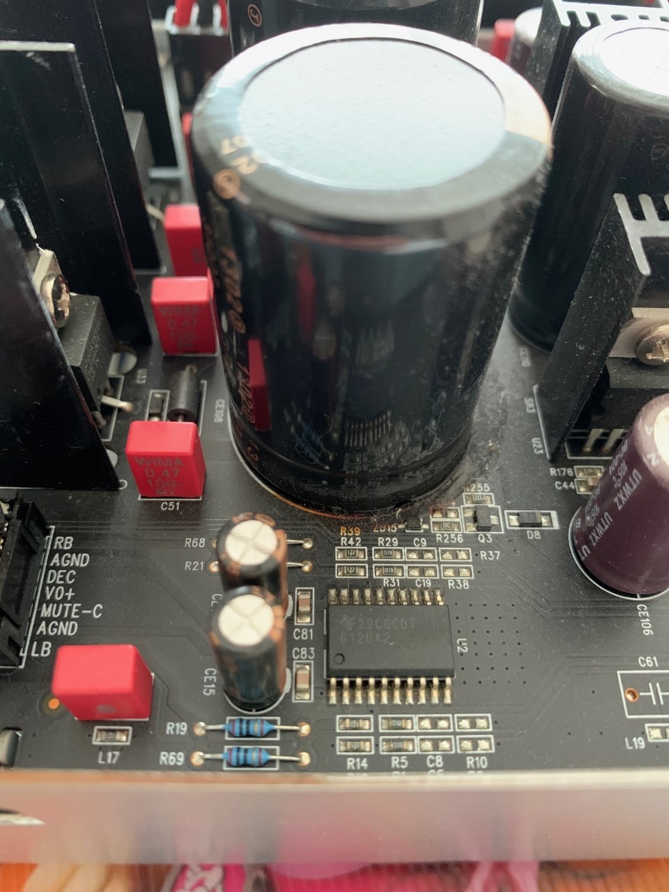

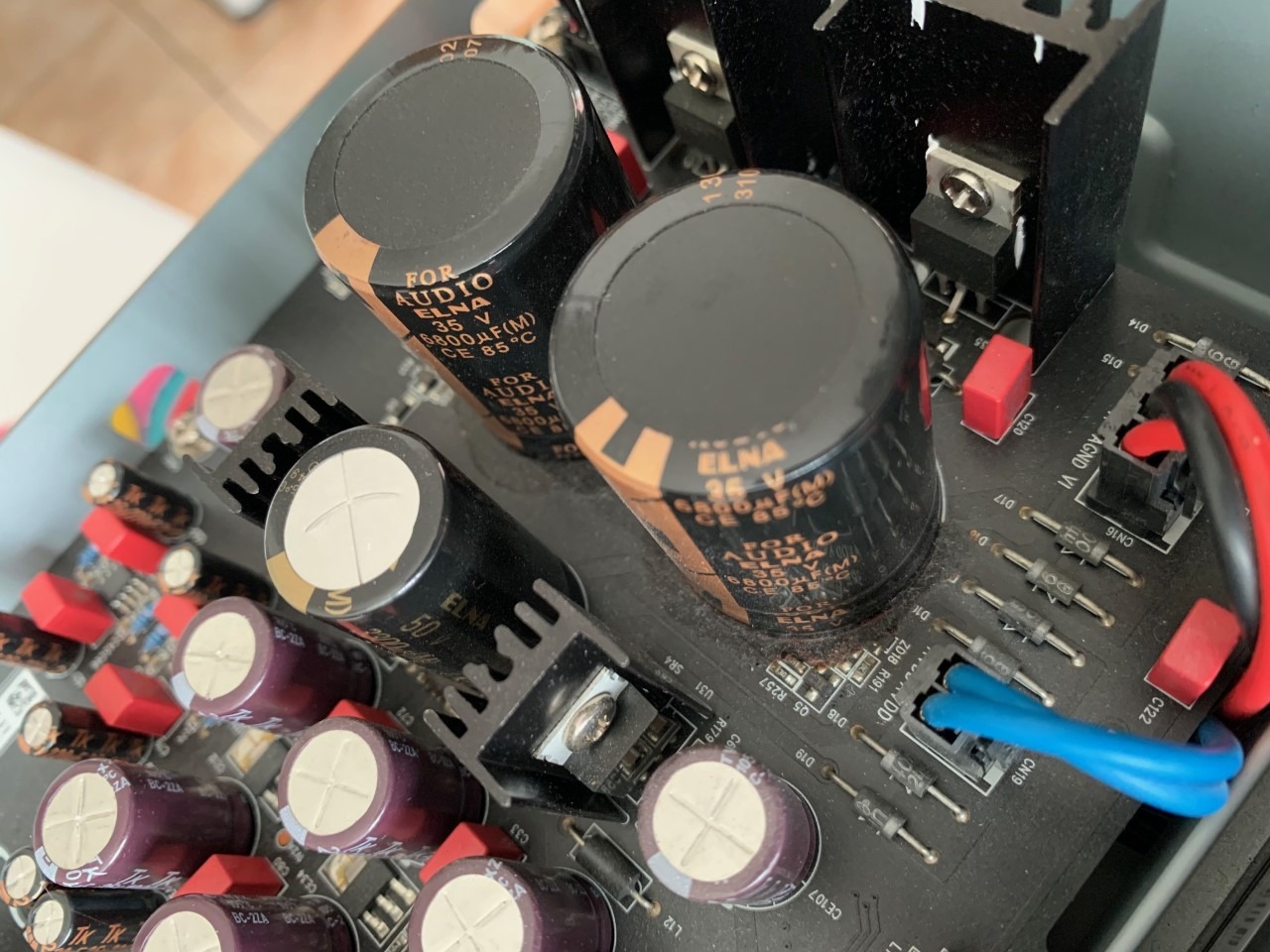

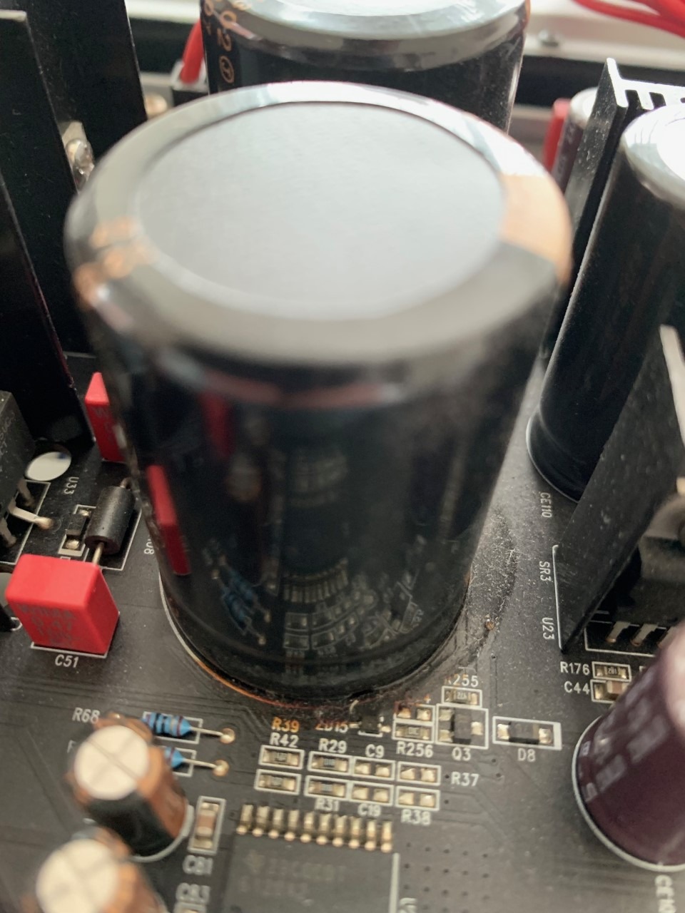

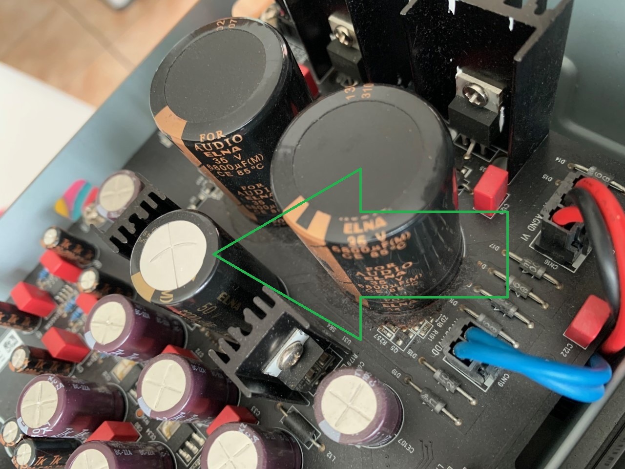

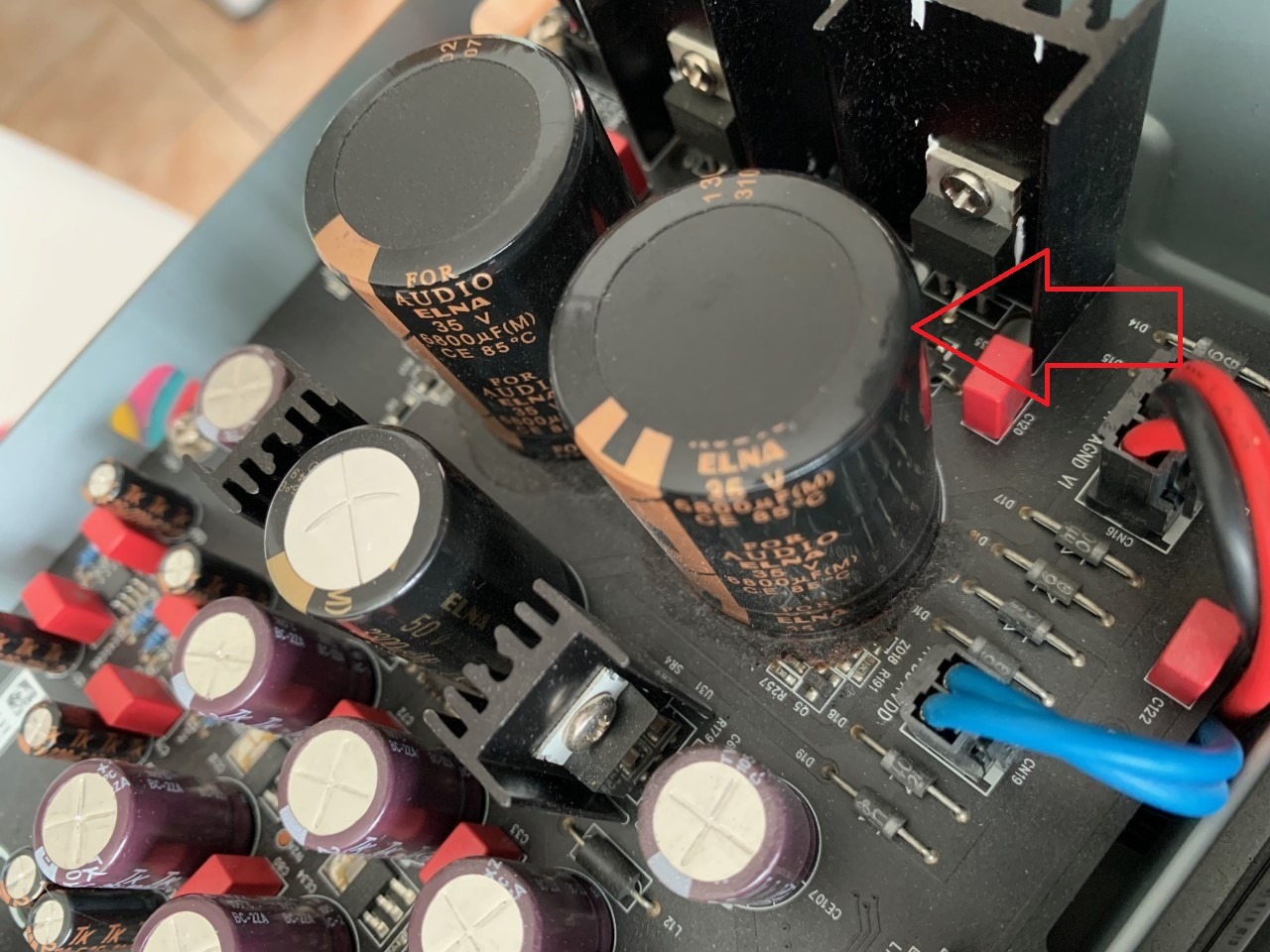

The issue of low brightness on the front panel display, it can most likely be caused by the power supply of the display itself (located inside the front panel). To reach to that power supply it may not be very easy... What you see around the big caps on stereo board is not leaking of the caps electrolyte, but is only glue used by Oppo to immobilise in place that caps. Due to the age of the device, that glue have somehow modified its appearance and it give the impression of a previous leaked liquid. Not the case. The other places you marked on pictures, as suspecting is a kind of leaked substances (near regulators), is only residues of the soldering paste, which maybe it was not well cleaned in production process. However, the stereo board and its power supplies are very far from a possible cause of the front panel malfunction. Not even the main power supply (board) it may have something to do with that issue, if the device it function well either.Hi, this is my first post on this forum. I have a Oppo BDP-105 that I bought second hand back in 2016, I left it on pretty much 90% of the time since 2016 ( 7 years ) . I mainly used it as a DAC , I only spun disc once in a while. Recently I started to notice that the front panel display was more faded than usual, also, at times when I play a disc the player freezes. I decided to open it up to inspect and noticed that there were 3 caps that look like they have leaked. Also, there is a brown colour on the board and on some of the soldering. I'm no electronics expert when it comes to these things but I've contacted Oppo and they haven't been able to give me much info other than telling me to send it in. I paid the service fee and will be sending it in this week. Seeing how I am from Canada , it will cost me around $350-$400 canadian dollars after service fee and shipping.
This brings me to my question, is this the kind of repair that Oppo can do? I mean, if the board is damaged, are they able to simply swap the analog board for a new one? Just trying to see if it is even worth for me to send it in given the damage.... What can you guys make of the pictures attached? Thanks!
View attachment 1139108View attachment 1139109View attachment 1139110
I have not read all the posts in your thread, but only the first post. So I may not know so much about other details...
Replacement of the stereo board is not necessary and do not affect the cause of the front panel display issue.
