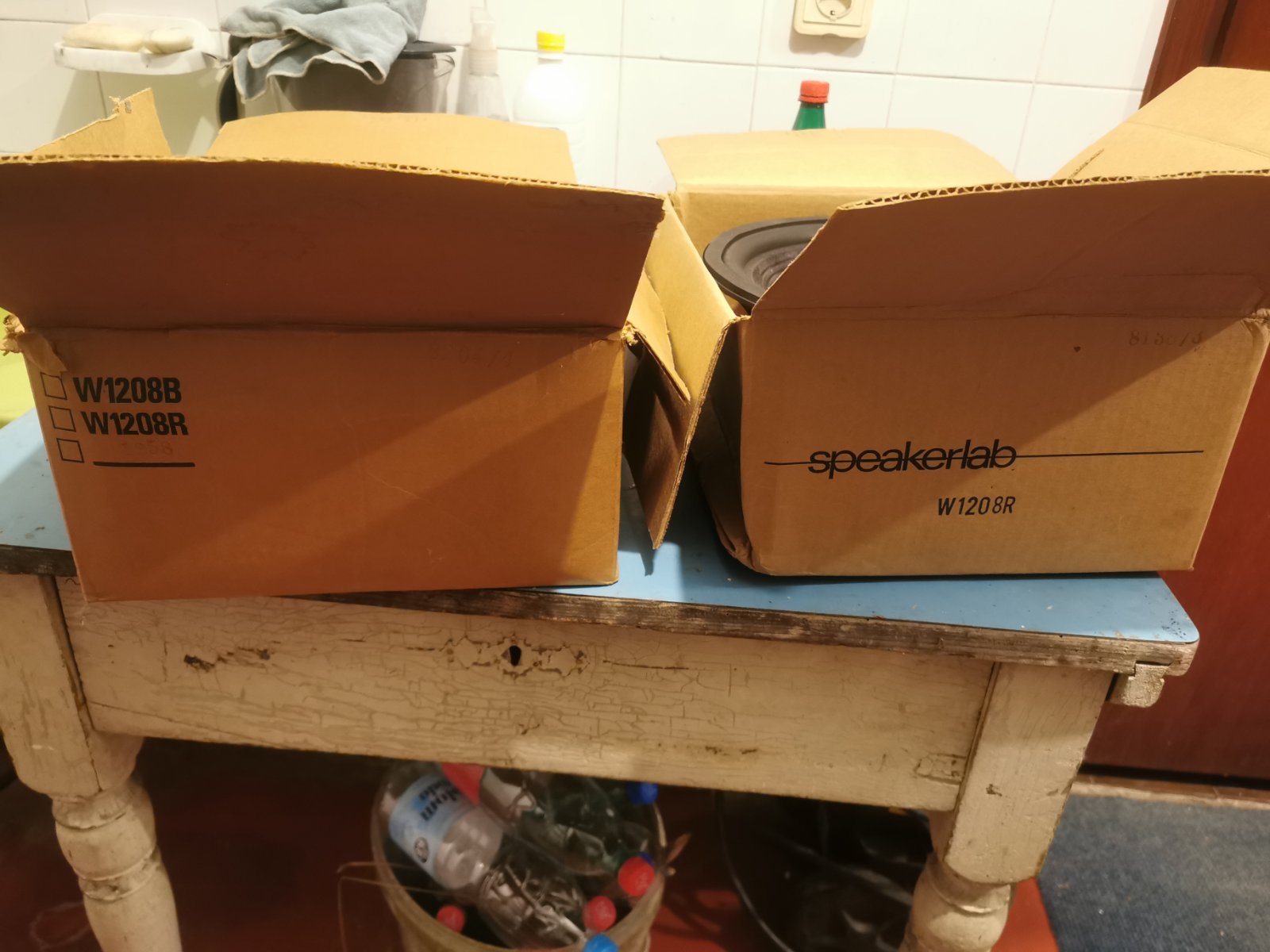

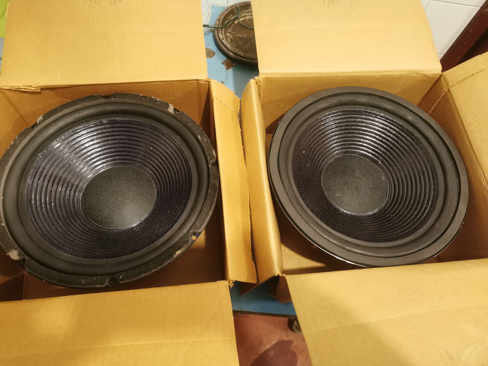

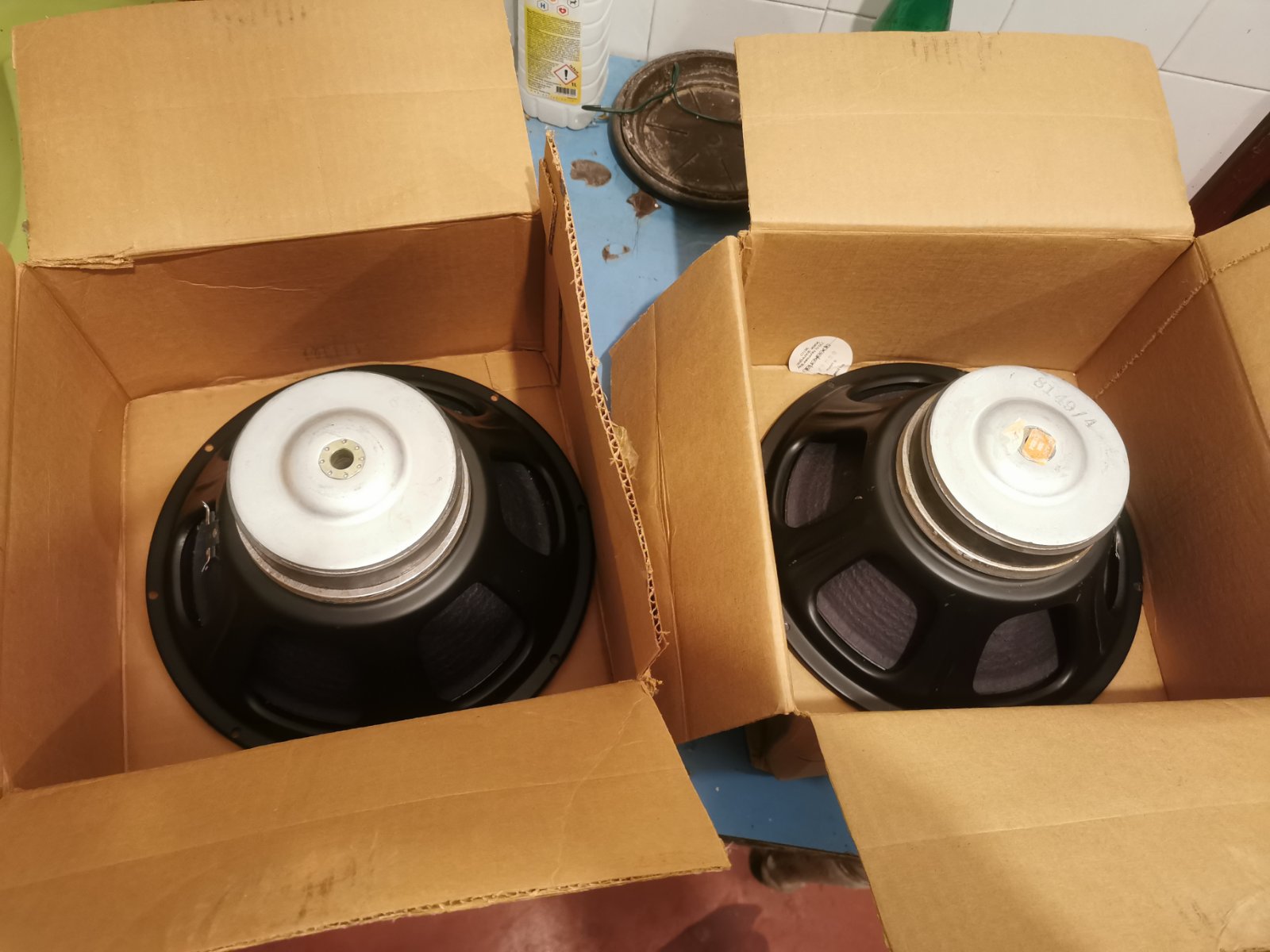

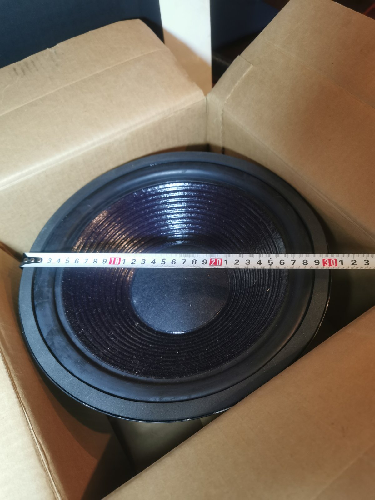

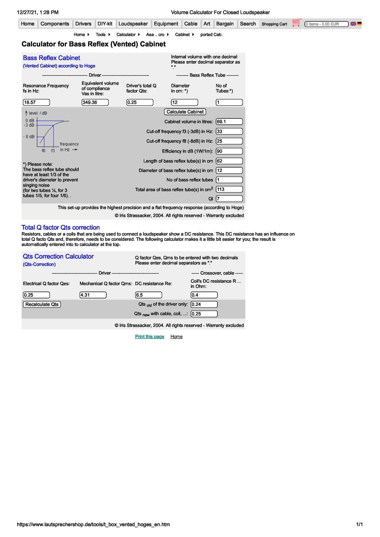

I got two Speakerlab W1208R woofers cheaply in original boxes. The drivers are on appearance NOS, probably never used and in solid condition.

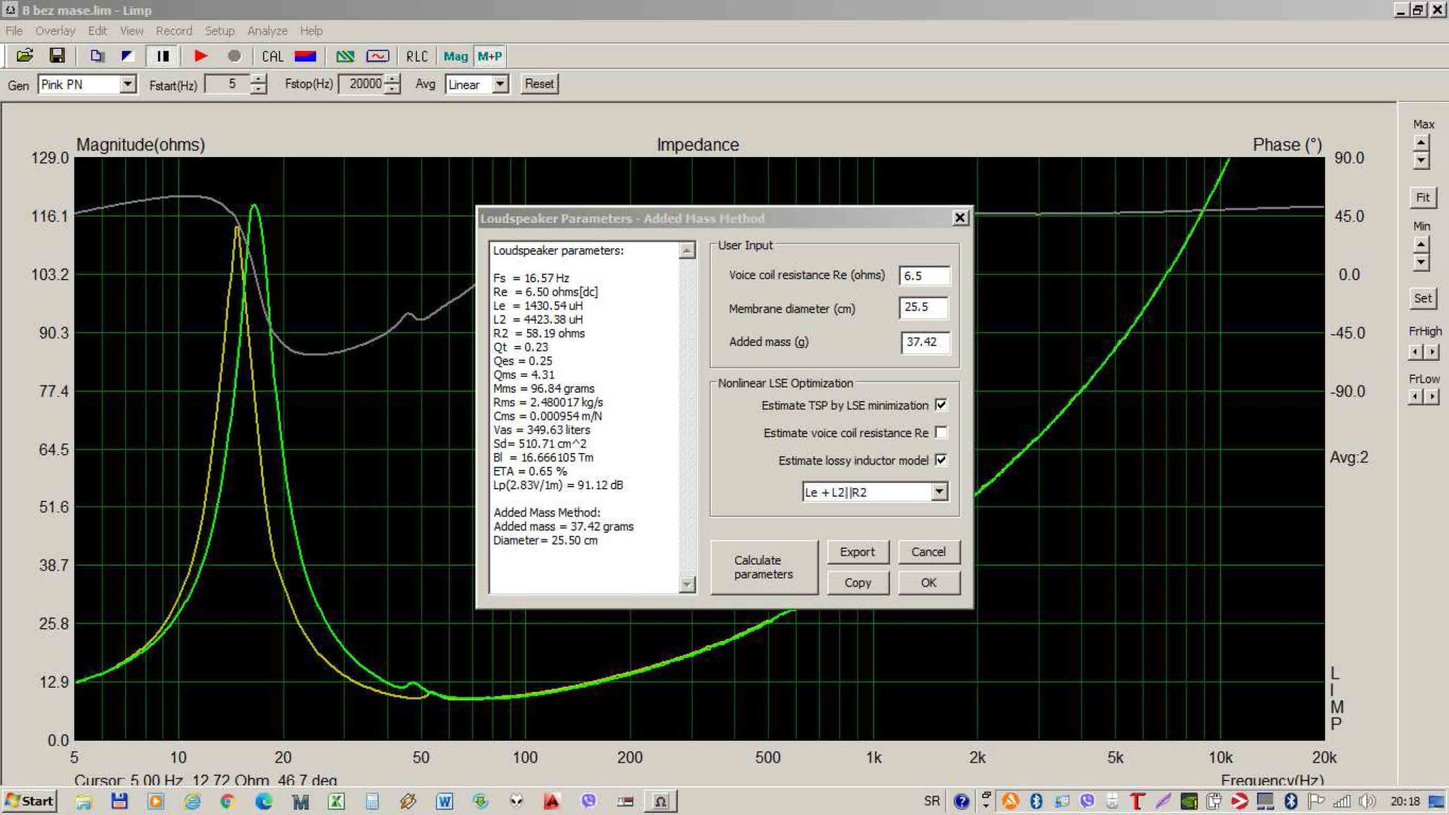

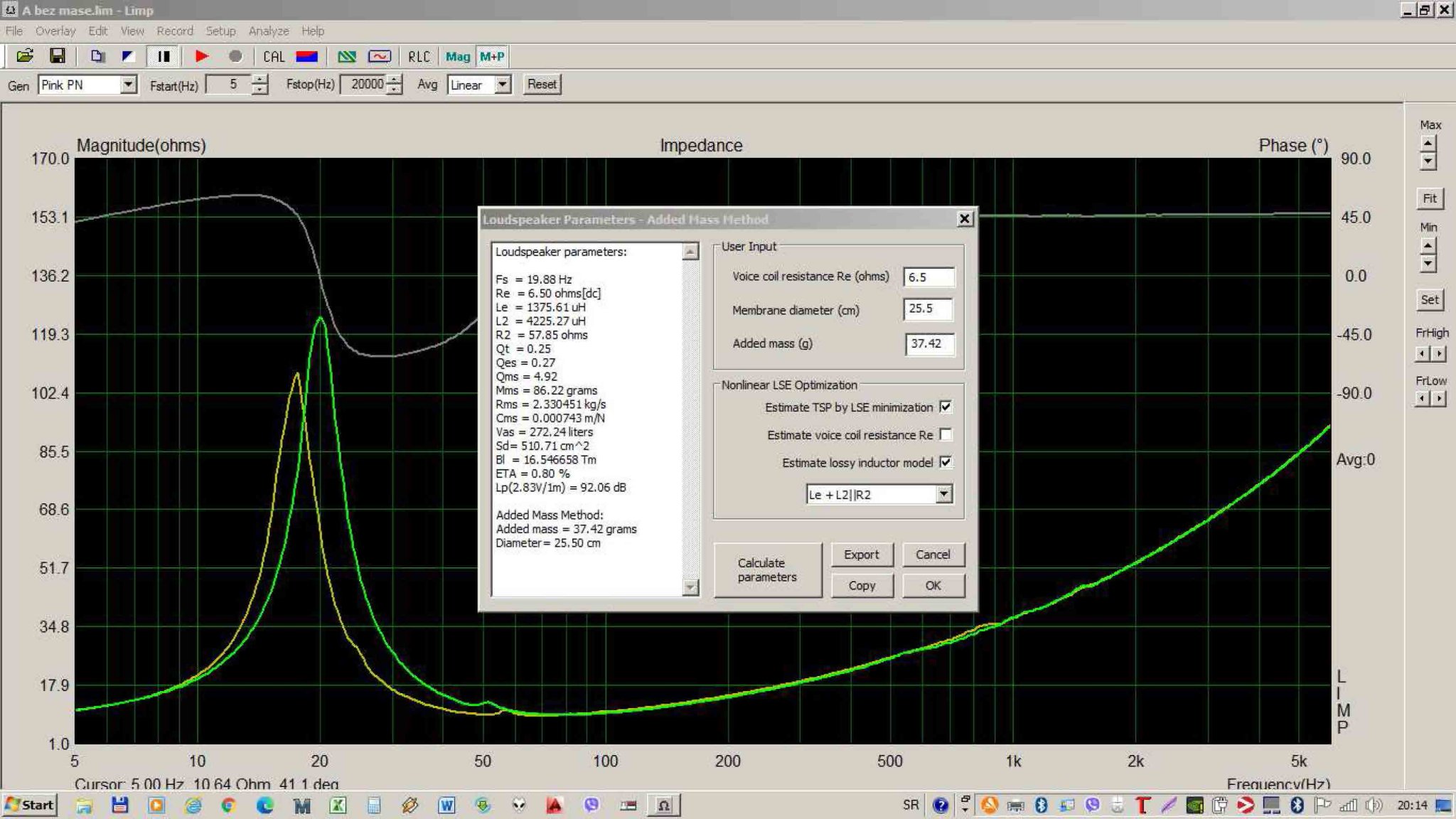

The measured TS parameters and the simulation say that bass reflex boxes with a volume of about 70l are suitable for them.
The plan is to do either two active subwoofers, or a large 3-way box similar to the KEF105/B&W801.
Does anyone have any other ideas on what to do with this?
I'm going to replace these rings to make them look better.
