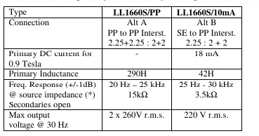

Hi, you mentioned the "S" mention, so I used Alt B col.
from the datasheet. Where did I get it wrong ?
In Alt. B the 2.25 windings are wired in parallel to make a 2.25:2+2 transformer. I use them in series for 4.5:2+2 (my connection is not shown in the datasheet).
When the windings are connected in parallel, the current rating doubles (for a given air gap size) and the inductance drops to 1/4.
Thank you. With this series configuration, the voltage gain
(6SN7/cv1125)->1660S is about 14/2 = 7
enough to drive 300B ???
