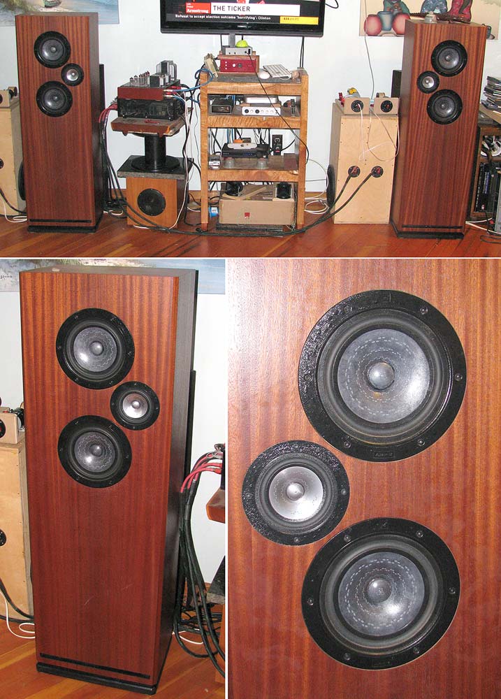

2-way, ML-TL (it is all about trade-offs) and an aperiodic midTL.
