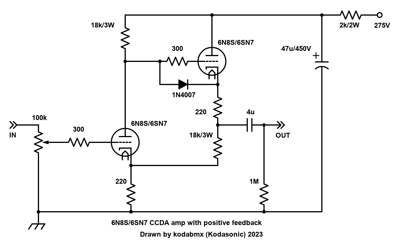

The CCDA has the option for using a small amount of positive feedback for more distortion. Sorry, I mean more 'tubeyness'.
Both are nice circuits. I guess personally I prefer the simplicity and economy of the CCDA.

I build both (though my version of the Aikido doesn't inject PSU noise so it's just an actively loaded half-mu amp followed by an actively loaded cathode follower) , and I prefer the actively loaded one. Changing tube types requires little to no effort, and some of the heat gets moved to outside the chassis.
I will also say that the CCDA is a very nice design as well, and I only build it with positive feedback.

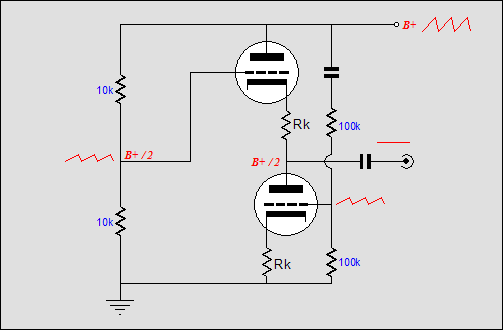

Isn’t that the one function which makes it not an Aikido?I build both (though my version of the Aikido doesn't inject PSU noise…
But isn't the point of the Aikido that PS noise can change with tube conduction and changes in current? Forgive me, I'm not very technically minded but something like that... ;-)
All the "Aikido" circuit does is inject the PSU noise in such a way that it is effectively cancelled - it gets rid of hum etc.
Here's a picture of what I mean.
From John Broskie's Tubecad.com: https://www.tubecad.com/2004/blog0011.htm
A regulated power supply is just a better solution to the problem IMHO.

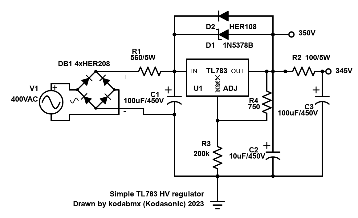

Here's my implementation - costs under 20$ to build (not including the transformer) - and I have boards available.
I should add that the 400VAC in question above is based on a square wave drive from a DC-DC boost converter, so 400VAC in gives 400VDC out. 300VAC is more suitable for sine wave power such as from the line.

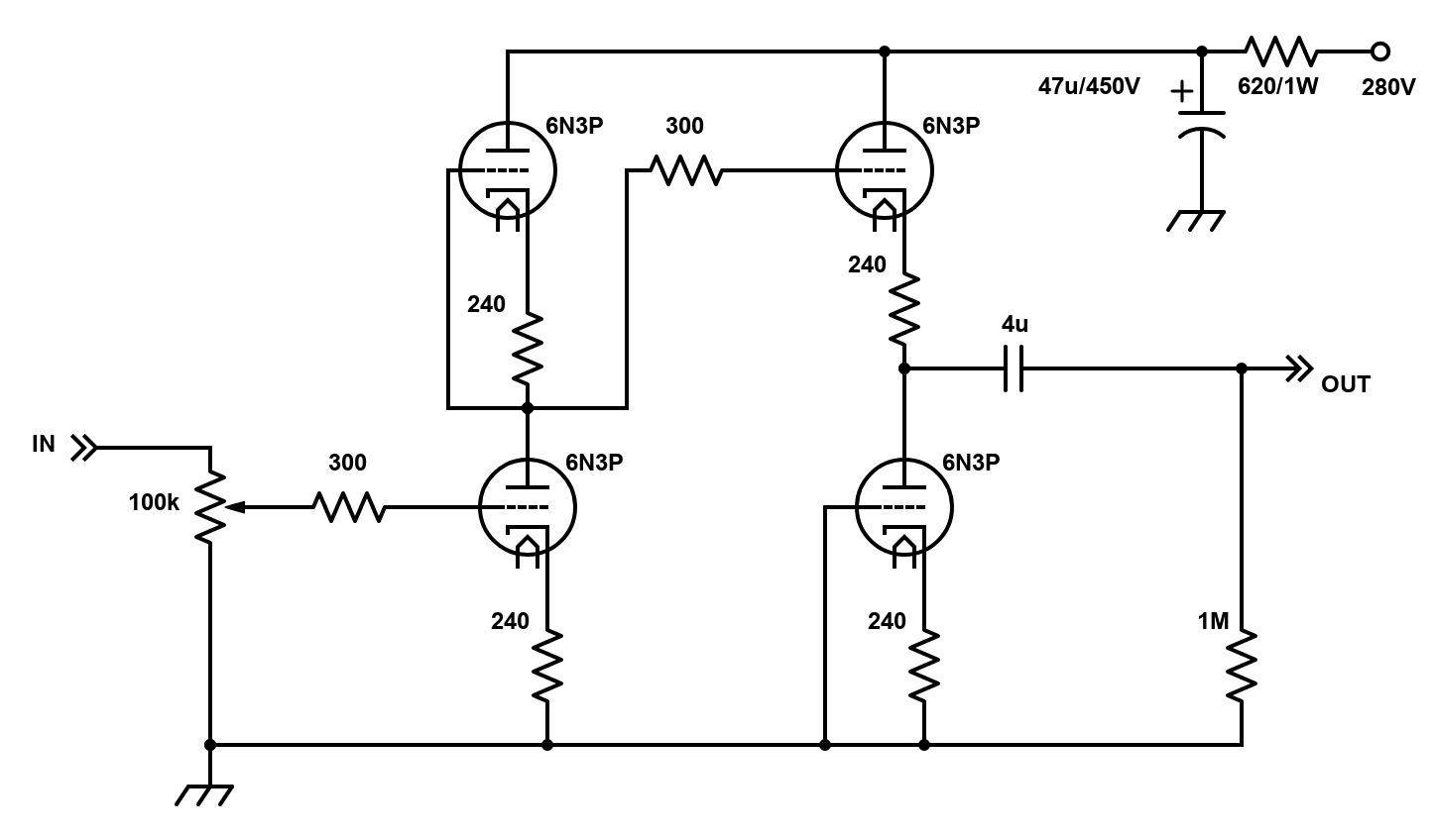

I was thinking... It's possible to set up an Aikido as a CCDA of sorts. Bias the first stage (half-mu totem pole) the same as the second stage (cathode follower with active load) so that they draw the same plate current.
