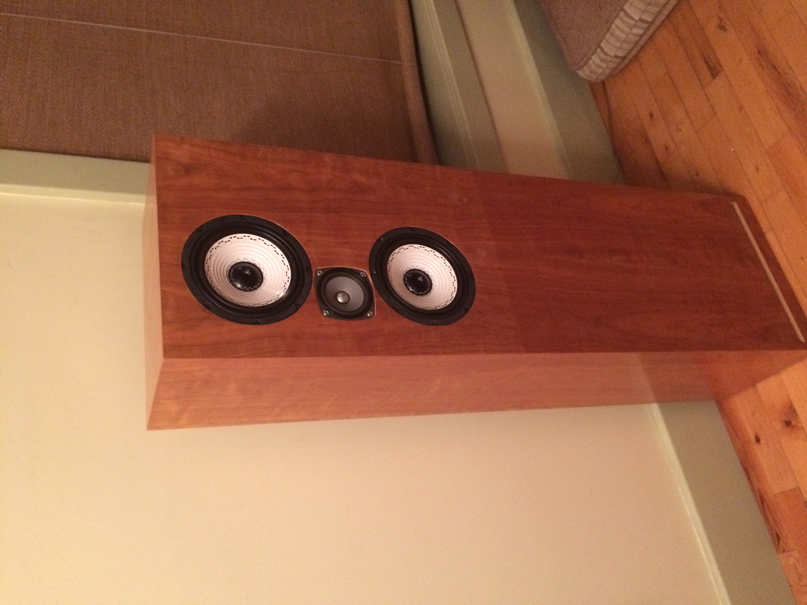

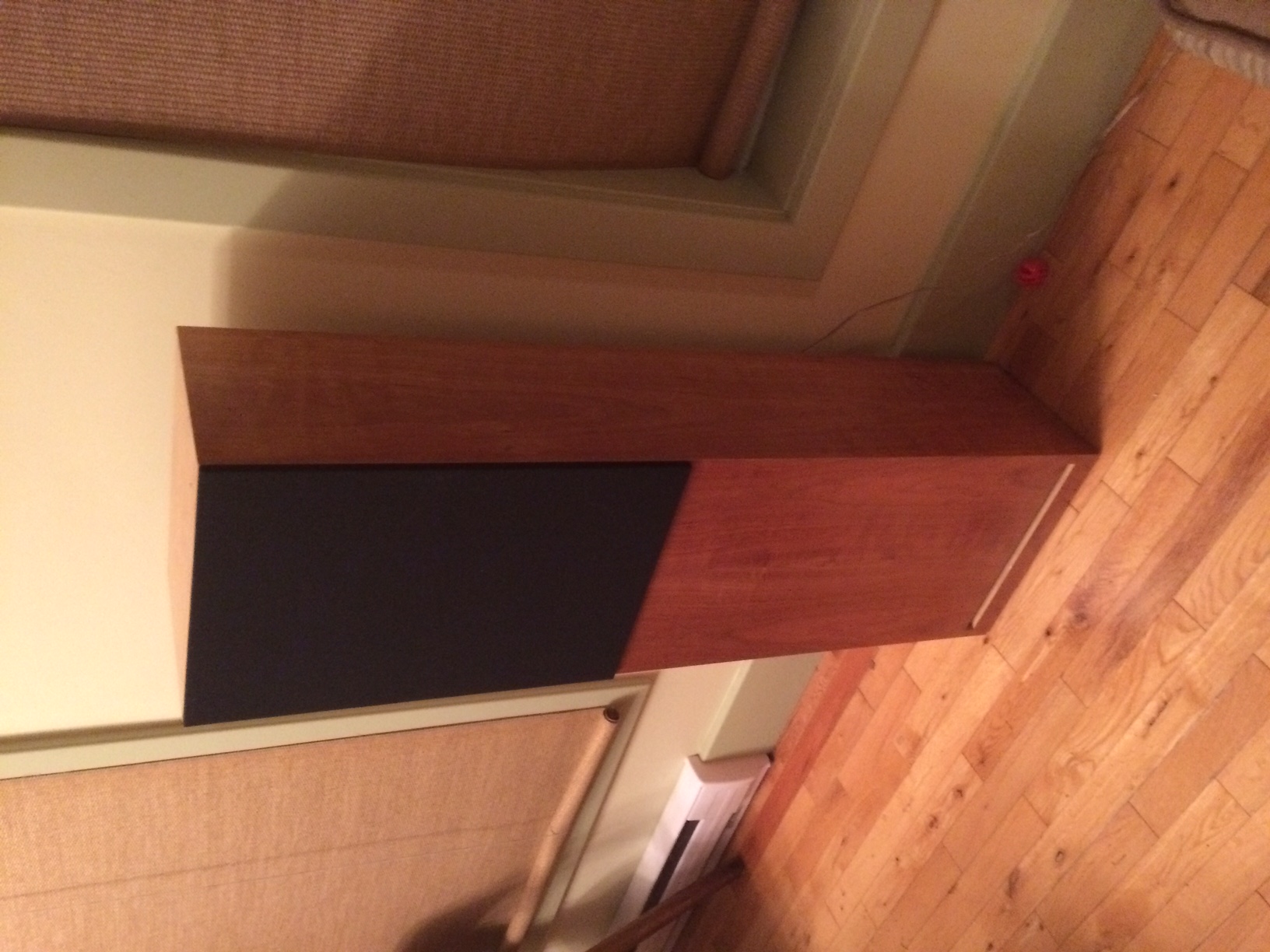

Re size, the dimensions of the Alpair MTM as discussed above are 405x290x1220mm = approx 16x11.5x48". While that's both much wider and taller than either the FH3 or FHXL, that's also a much shallower footprint, and they don't require the same space behind as any type of rear mouth exit back loaded horn I've ever built. So these aren't tiny bookshelf units, but certainly not the same size as a K-Horn, nor requiring the same real estate as an open baffle, or large dipole planar of any flavour -i.e. ESL or magnetic .
Attached are photos of the earlier build of the same configuration described above, using the much less expensive CSS EL166 / Mark Audio Woofer6 and Fostex FF85WK. I don't have the exact dimensions at hand, but as best as I can recall, they where close to the same size as the Alpairs.
