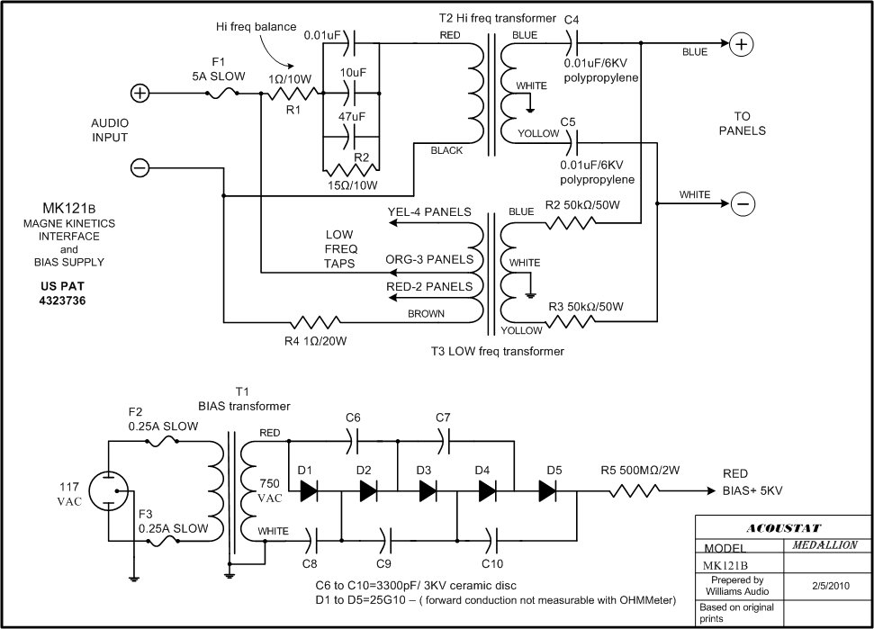

CLS....you seen this right...as for the bias Xfourmer.. i like acoustat... the 750v-or higher... This is the A...setup...there are other goodluck

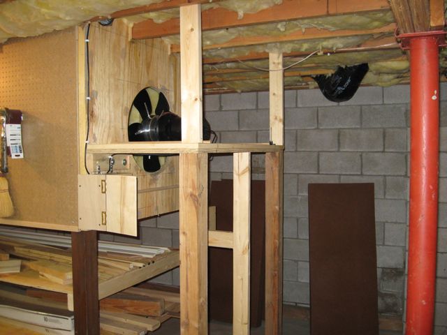

That a very expensive sub (yikes)...I thought of making one myself, as I have an osculating fan somewhere in the basement!

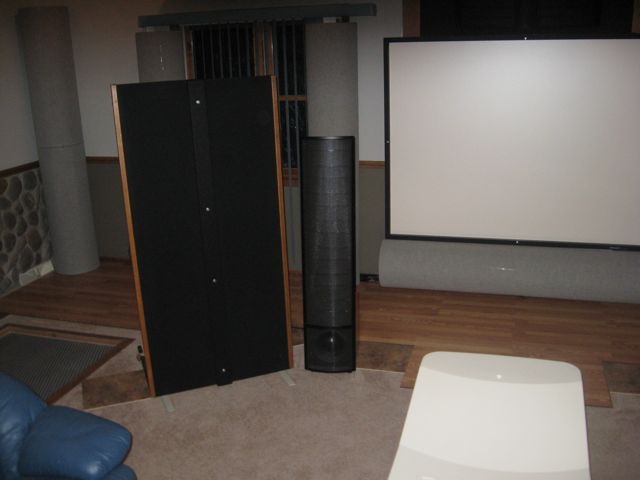

Well, I sold the Tympanis and so far, no regrets...I have the DIY CLS running 250hz and up with a pair of old Tympani 1D bass panels doing the LF...
Insofar, I am not getting those pristine highs that I had from the Tympani IVa ribbons, but all else is simply gorgeous.
I may just add a ribbon tweet and be done with it...
