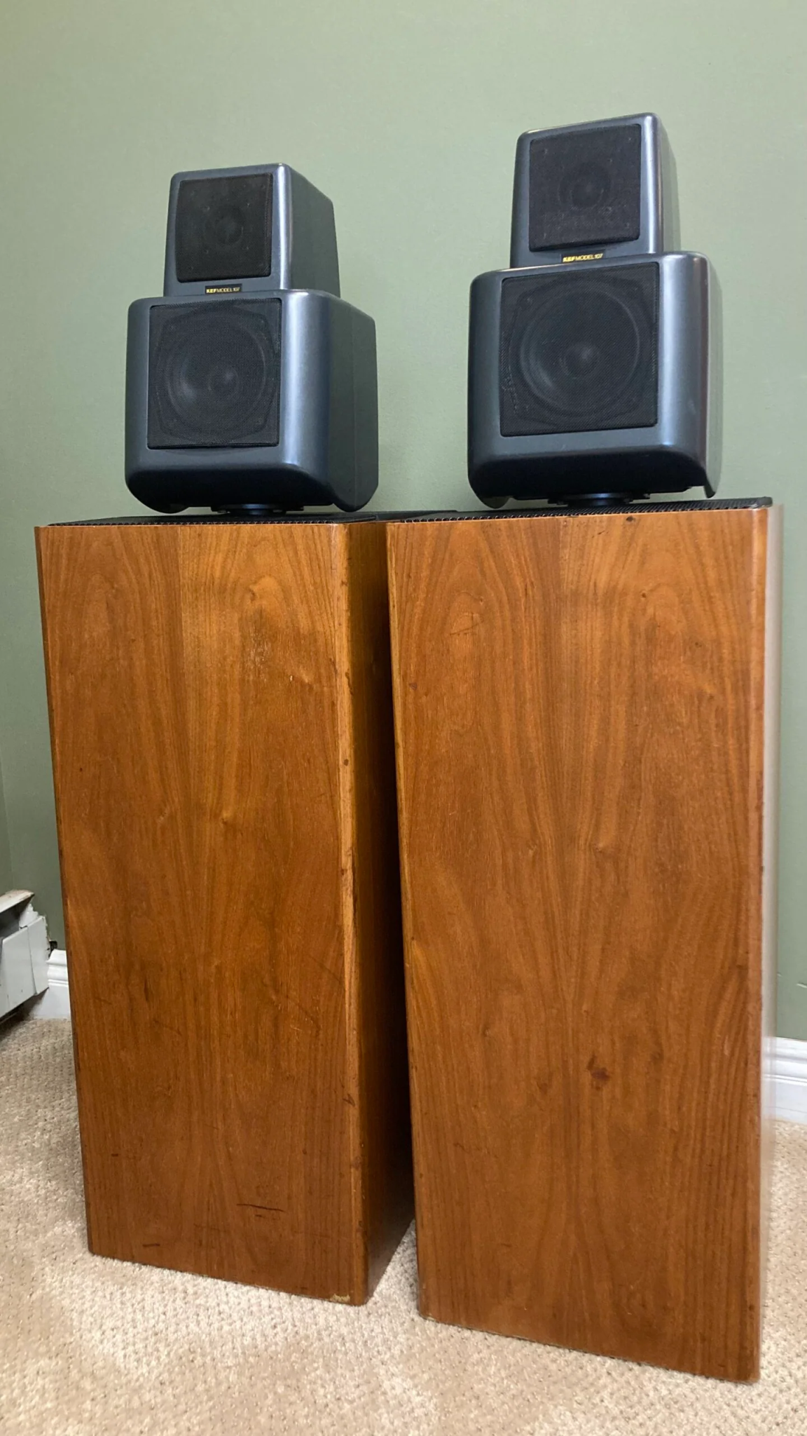

This is a random pic of a pair of Vandersteen, model 2, from the web. Of course, Vandersteen is iconic and earned it. We are not challenging the design, just curious: What's the purpose of the posts, canopy, and sleeves? Aesthetic or acoustic? What's your take? Also, what's you opinions on these speakers?
Entirely Aesthetic.

Without the posts, canopy, and sleeves, it would surely look a lot smaller! Could the two posts in front of the drivers create some sort of problems reflection-wise?
Probably. But I bet it was a fair tradeoff to get a good sound AND an actractive package to sell mass market.Could the two posts in front of the drivers create some sort of problems reflection-wise?

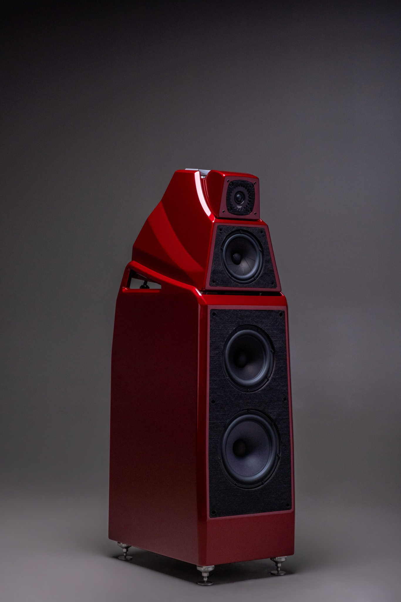

Wilson has a similar design, but without the posts. Narrowest baffle for each driver. But a higher end price point, and MUCH fewer units sold.

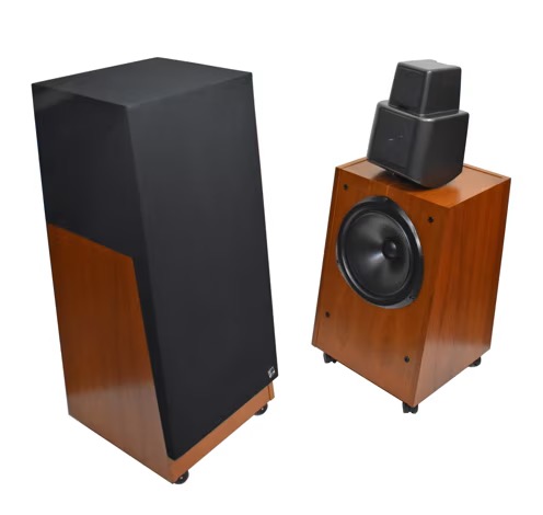

I think this is a clever solution: the 'hard' box is not visible so it can have a shape optimized for acoustics. A complex shape that only needs basic finish.
The external 'box' is acoustically transparent and is optimized for looks. A simple shape with 'good' finish.
Due to easier finish (fabric wrap) and highly optmize-able box shape this can be a good solution for DIY.

May I assume the speakers will work equally well sonically without the posts, canopy and sleeves? Odd looking or not?
Yeah, for sure works better sonically without all that extra structure. Although difference is likely small, especially if you listen relatively far away. But sure, you could leave the stuff out.
Yes. If aesthetics are not a priority, it is relatively easy to design/build a high performance cabinet. But if it has to be good looking as well... well, that is a more difficult challenge...The most difficult part of loudspeaker design is the aesthetics.
The 2c was a good speaker in its day, and it competed with speakers selling for much higher prices. Mr. V kept his prices down by keeping the aesthetics and finish work simple... as @AVWERK and @AlmaAtaKZ mentioned...
Without the posts/top/sleeves, the Vandersteen looked like vintage KEF? With tweeter, mid, woofer in their own compartment and time aligned.
