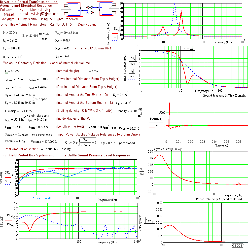

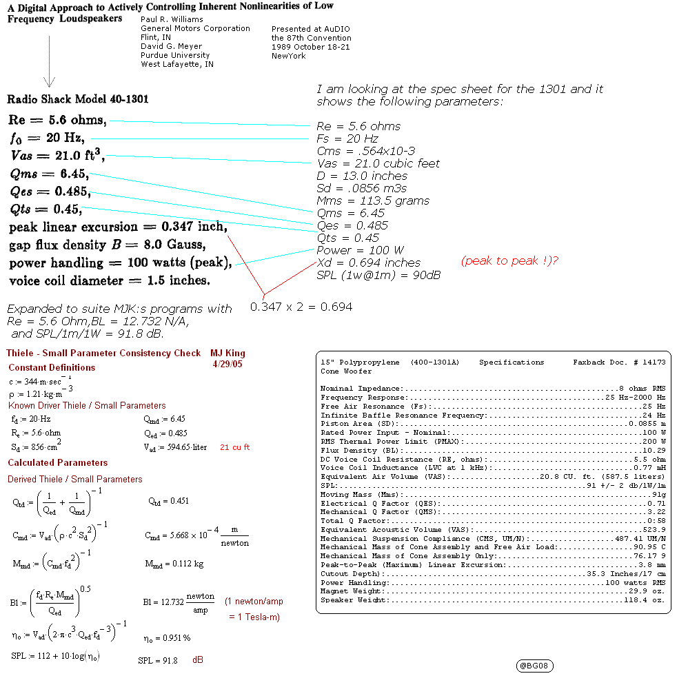

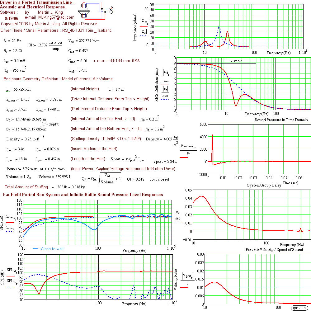

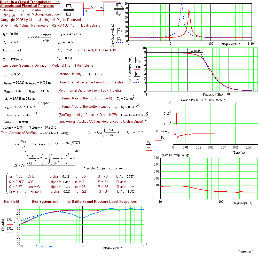

Hi, Some simulations (3) using Radio Shack 40-1301 T/S parameters fond in document:
A Digital Approach to Actively Controlling Inherent Nonlinearities of Low Frequency Loudspeakers
Paul R. Williams General Motors Corporation Flint, Michigan
David G. Meyer School of Electrical Engineering Purdue University, West Lafayette, Indiana
Presented at the 87th AES Convention 1989 October 18-21 NewYork
Re = 5.6 ohms,
fo = 20 Hz,
Vas = 21.0 ft 3,
Qms = 6.45,
Qes = 0.485,
Qts = 0.45,
peak linear excursion = 0.347 inch,
gap flux density B = 8.0 Gauss,
power handling = 100 watts (peak),
voice coll diameter = 1.5 inches.
Expanded to suite MJK:s programs with Re = 5.6 Ohm,BL = 12.732 N/A, and SPL/1m/1W = 91.8 dB.
b
1(3)
Greets!

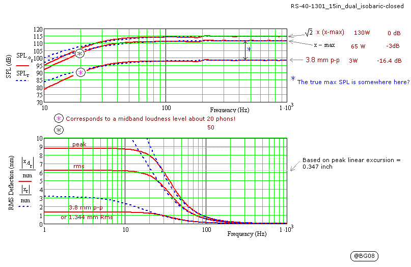

FYI, the factory specs are somewhat different than those published here and RS was notorious for changing vendors/specs without updates, so I recommend designing based on a worst case scenario to ensure you have an adequately large cab: http://support.radioshack.com/support_audio/doc14/14173.htm
Anyway, you imply a ~5 m longest room dimension where a theoretical +12 dB/octave room gain curve begins and while few rooms achieve this over a wide BW, I don't understand why you think it will begin flattening out so quickly by ~30 Hz. If true, then some peaking at Fb is desirable IMO. Regardless, movies today typically have enough < 20 Hz content to justify at least a ~16 Hz Fb.
GM
… the factory specs are somewhat different than those published here…
Ok, Take my simulations with grain of salt i.e. they are probably overestimating the SPL capacity as I used the peak excursion when simulating.
The SPL readings should be lowered with 3 dB, the input power cut in half and excursion reduced by dividing with sqrt(2).
If the Radio Shack specifications is more reliable with: Peak-to-Peak (Maximum) Linear Excursion = 3.8 mm, the SPL curves must be reduced with about 16.4 dB which make the use of these drivers for HT subs very doubtfully and only if JND whispering levels are convenient.
b
1(1)
Right, a worst case is making a very large, low tuned vented cab and still needing enough room gain to keep it linear down low and while it would barely make it to DD/DTS reference levels using all four drivers, it will still be loud enough for most folks.
Still, better IMO to use these as car trunk IB 'subs' as originally intended and get some high Xmax drivers better suited to HT.

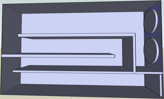

Maybe it's better not to go with bass reflex?
_______________________________
I know this is not the ideal driver for HT, because of the box size needed.
Using 4 is better of course, but still... ±800l ?!?
I do have the 1.7m length space that I can use, one meter high and about 40cm wide or a bit more.
I read a bit about transmission line's today and maybe that would be better, don't know. :xeye:
What if I made a Tline of about 5.5m, tapered smaller towards the end?
I'm not familiar with software for simulating TL, so if anyone can help me out...
(I'll look if I can sketch something with Google sketch-up)

Any thoughts on this TL?
Or is this set of woofers doomed to get thrown out😕
(TL not correct, just a sketch)

If I can jump in here for a second (albeit a few months late)...
We are discussing two different drivers here. the Radioshack 40-1301 was not the same driver as the 40-1301A.
The 1301 (without the A) has an Xmax of .694 inches. Also lower Q values and higher efficiency.
I am looking at the spec sheet for the 1301 and it shows the following parameters:
Re = 5.6 ohms
Fs = 20 Hz
Cms = .564x10-3
Vas = 21.0 cubic feet
D = 13.0 inches
Sd = .0856 m3s
Mms = 113.5 grams
Qms = 6.45
Qes = 0.485
Qts = 0.45
Power = 100 W
Xd = 0.694 inches
SPL (1w@1m) = 90dB
Not a great driver, and somewhat limited in power handling, but certainly better than the 1301A.
I have a pair, and have been planning on building something with them, but they will still require a BIG box.
I suspect I will end up with an isobaric design because of the volume requirements.
