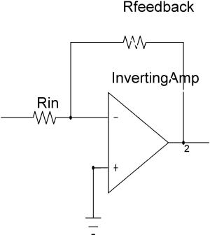

I hear that train a coming......
"Inherent in inverting stages. Not a trainsmash."
Inverting amplifiers have a ground reference, the noninverting input.
Where in the circuit is that exactly........
Any of you guys ever heard of vaporware?
http://www.footballsoftware.com/
Maybe we can have a fantasy amplifier thread. No simulation, specs, measurements, or schematics with part values. a simplefied schematic or vauge desription will be fine.

Fred Dieckmann:
Well I'll be damned...
Can't find it, sorry. Why don't you have another look. Or take a squizz at Nelson Pass' Zen 5, on which part of my circuit is based... it seems to be "missing" the same graound reference hehehehe 🙄
