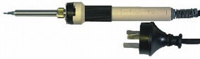

Sorry, forgot to say what it was. Yes, it is the Welleman VTSC-20.
A soldering pen only, so no TC. Its 20W and there are tips down to 0.3mm for it. This one is quite different from Vellemans other
ones, which are thicker and look more like any other brand. As
I said, I don't know much about it except for the tech. specs. but
it looks ergonomically nice. I am tempted to buy it just because
it seems to feel good in the hand - not the least important
aspect of a soldering pen. The price is 237SEK (about $25).
BTW it has ceramic heater. Did anybody know what this means?

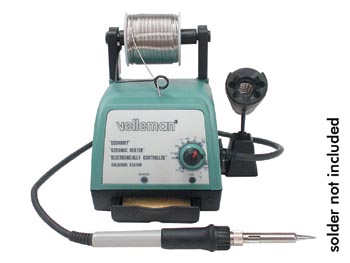

So, since noobody seemed to know anything about the Velleman
soldering equipment, I decided to make myself a self-appointed
test pilot. Talking to one of the companies selling Velleman here
in Sweden confirmed what i suspected, that Velleman buys these
tools from various suppliers in Asia. They also claimed that the
more expensive versions (expensive for Velleman, that is) are
of quite good quality. I decided to try a station that looks
professional and has a slim-type pen. Actually, the pen looks
suspiciously similar to the Hakko ones, so perhaps it is a
disguised Hakko station (or am I just dreaming) . Anyway, it
is 48W TC station with ceramic heater and looks like this.
Sells for 725SEK (about $80).
