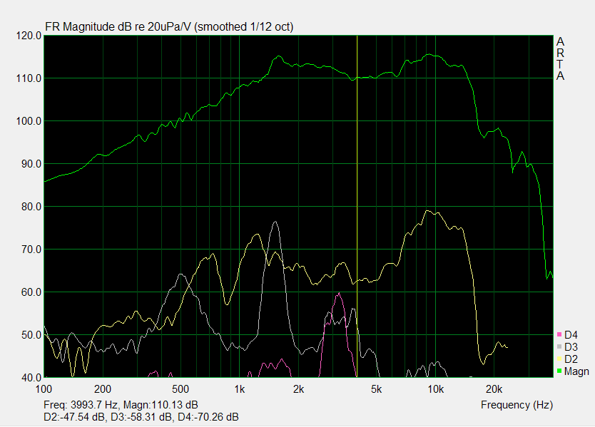

The AMTPRO-4 frequency response makes it less than ideal about 10kHz. I attached a measurement I took on a unit that I own, in free air. It might be possible to EQ the response so that you get a smooth transition between the mid-passband level of (on my plot) 105dB and the near 10kHz response level of 100dB - you might want to EQ out the "hump" around 10kHz or it could sound fatiguing. I would probably try this approach with an active DSP crossover, however, because you might need to combine several EQ bands to get it right.
The AMPPRO-4 also has a rather "tall" diaphragm for a tweeter. The size of the diaphragm is especially a problem in the vertical plane, where the response pattern starts to narrow starting at 4kHz. You can use it as low as 1.5-1.8kHz (it will need a back enclosure). If you add a small dome tweeter (e.g. Ox20?) crossed over at 5-7kHz you will get better overall performance from 5kHz to 20kHz.
On the plus side, the distortion signature is pretty clean and efficiency is high. It's a good driver when used in a way that minimizes some of the response issues.

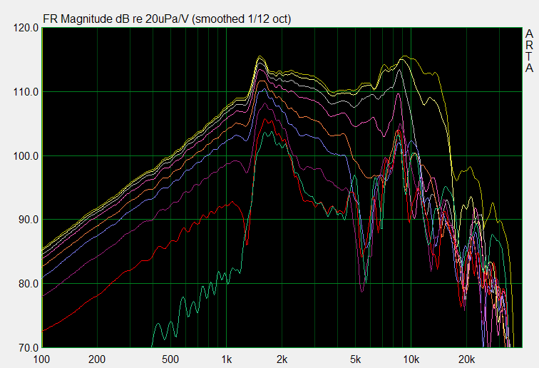

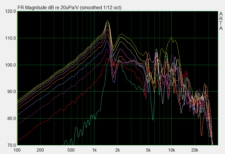

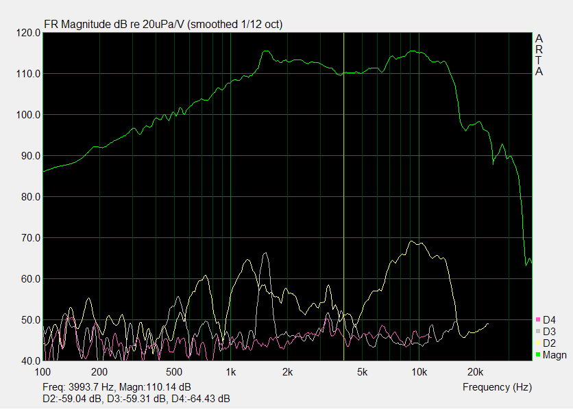

I haven't measured this exact driver, but I have measured the MR13P-4, another Satori driver (5" nominal diameter). I did this while suspending the driver in free air about 2m above the ground in a large room with high ceilings. I could get about 50Hz resolution this way, and was testing for open baffle use. I measured several angles in the horizontal plane, both to the front and rear. I found a narrow resonance at 1.5kHz that showed up in the frequency response differently to the front and rear and produced a big spike in the 3rd order harmonic distortion. I did not measure IMD at this frequency so I am not sure about how that would be affected, but it probably is (that's my guess at least). For the price of the MR13P-4 and hype about the Satori line I was not all that impressed by what I found.
I am attaching some data that you might find interesting. After testing I sold off my pair and went with another driver that did not have the FR irregularities I found, which would probably be hidden if the measurement had lower resolution...
SB Acoustics MR13P-4 0-11-22-33-44-55-67-78-90deg 16in front.PNG46.7 KB · Views: 567
SB Acoustics MR13P-4 0-11-22-33-44-55-67-78-90deg 16in rear.PNG51.6 KB · Views: 584

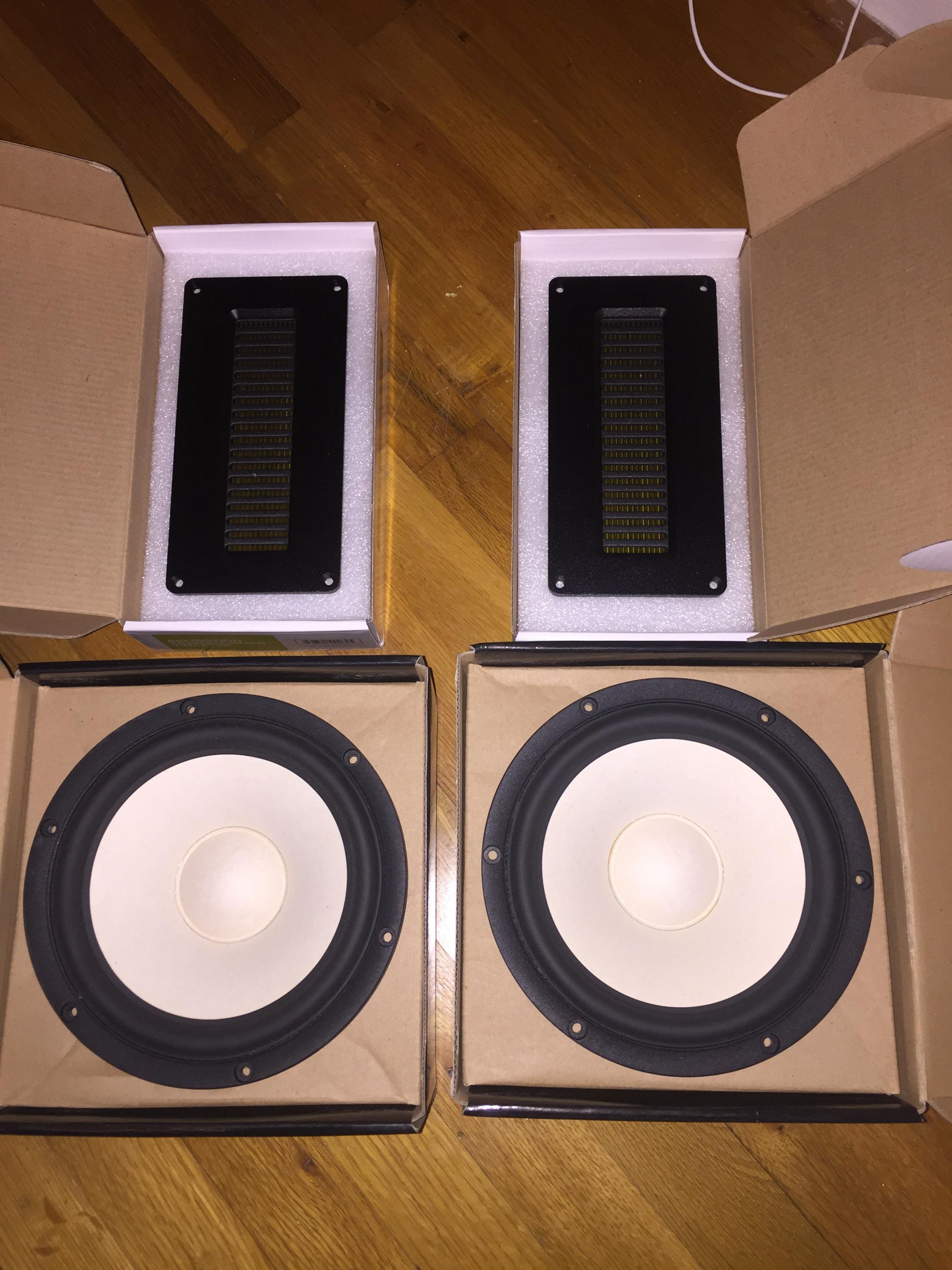

My Satori's arrived yesterday, so I will likely have more questions as I get into my build.
The Satori's arrived yesterday, so I am anxious to start building. I'm afraid the process is going to be drawn out though due to competing priorities.

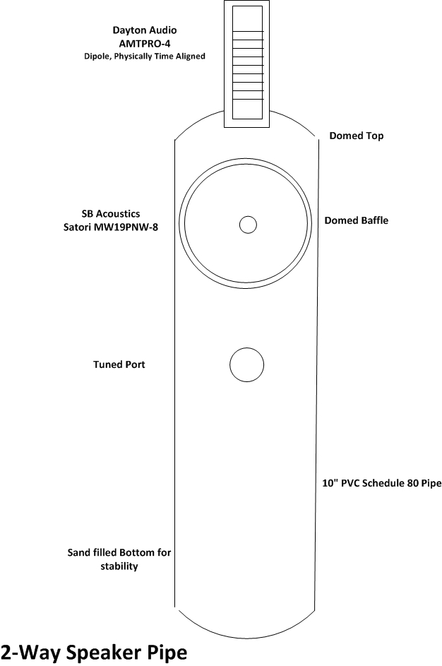

I did start planning my direction today. I'm thinking of going with 10" Schedule 80 PVC pipe for the core of the enclosures. I have already worked with PVC with my current speakers, which are PVC quarter-wave pipes. These would follow the same theme, but would be bass reflex.
I think I might try using the AMTPRO in a dipole configuration. It would be much easier to deal with physically, though I'm not sure if doing so would add to the complexity of the crossover. Time to read up on the trials and tribulations of dipoles.

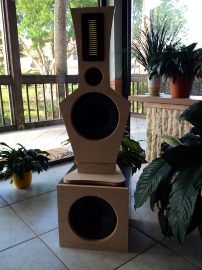

itschris, Excellent construction work on your 2-way cabinet.
How much miniDSP equalization did you use on the AMTPRO-4?
To your ears, how does the AMTPRO-4 compare to a good dome tweeter?

Thanks 🙂 It was constructed inside a college dorm room with hand tools & the PE knock-downs.
I don't have extensive experience with other drivers, but I do regularly listen to the YG Acoustics Hailey 1.2s; I think the AMTs are definitely no slouch, and the quality is in a realm that's different strokes for different folks. They definitely keep pace with the Satori's. I think they're a good step above the RS28A, but my experience is limited beyond that. If I were to go back to the beginning, I don't think I'd change a thing in driver choice. I'm hesitant to give subjective comparisons, but I do think the 3k region is a little heavier/fuller than the Hailey's. The limited vertical dispersion is definitely a plus for me.
WRT equalization, I think it's rather a lot (6db+) and even more near the ~10k peak. As you noted, the SPL curve was challenging; at the crossover point, the AMTs are pretty inefficient and I don't believe there is any attenuation. The polars (non-dipole) looked pretty well behaved to me when I was working on them.
Another interesting point was that in my final measurements I didn't notice much of a drop-off in the top octave. I'm not sure if its because the 3-13k range gets cut so much, or some other factor. At some point I'd like to remeasure without any crossover because I can't find my original files anywhere.
Lastly, the dipole CSD of the AMT wasn't quite as great as when I closed off the back. Unfortunately I never took the time to investigate.
