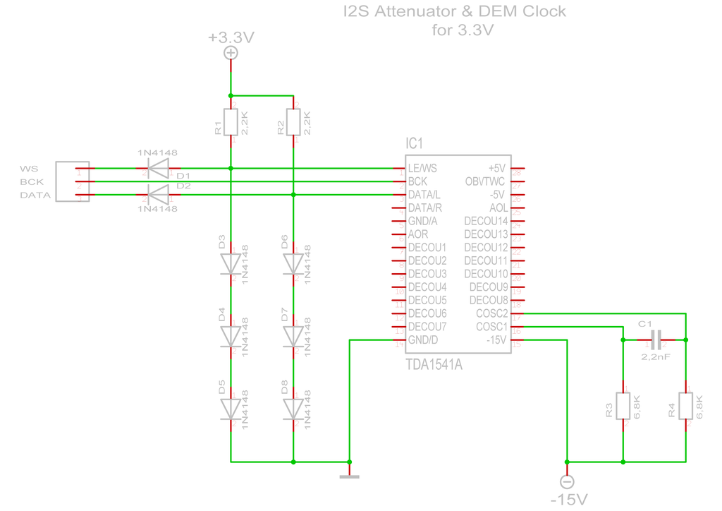

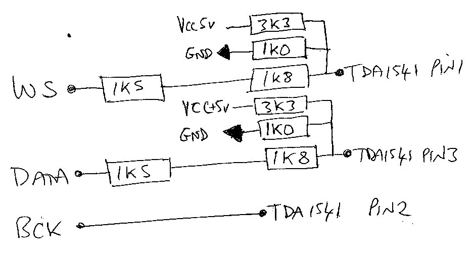

I followed Ecdesigns work from the beginning. And using some of his tweak in my Revox B225 improved the sound with a huge margin.
since you have the tda1541A chip you can adapt them as well.
For an easy step i would do the latest DEM clock mode.
Its only 2 resistor of 6K8 taken from -15V to the DEM cap legs on the chip.
secondly the I2S attenuation brings another big step to the sound.
I made it into the place of my oversampling chip SAA7030.
you design a bit different maybe you cannot eliminate the 7220 completely.
You can use resistors instead of diodes. both works fine. different size resistors for 3V or 5V data lines!!

Danico,
If 2.2 n between pin 16&17, doest it mean you have to leave free the 14 DEM caps (unpopulated) ?
I stayed on the same shematic but with 100 pF at DEM Clock & 0.33 uF for the 14 DEM caps !

Ignore the 2,2nf and just leave the original cap on the dac pins.
or use any of these size for:
235.2 KHz, 350pF
256.58181 KHz, 318pF
282.24 KHz, 300pF
313.6 KHz, 260pF
352.8 KHz, 250pF
403.2 KHz, 203pF
470.4 KHz, 180pF
564.48 KHz, 145pF
705.6 KHz, 122pF
The capacitors need to have tight tolerance (1%).
So the C giving 176.4 kHz fDEM might be around 465 pF.
I used old vishay draloric mk2, but I do love the carbon resistor sounds AB or Beyschlag. I use them in the signal line most of the time. Metal film resistor works good with high freq, but you never know.
Did you tried out already the dem mod? how it sounds for you?

Danico,
Ok. I just realized you asking about the 14 caps around the dac. of course you need them. it was a simplified picture focusing on the dem resistors.
I certainly mistake, because my understanding is John choosed 2.2 nF to avoid the 14 DEM populating... He is so prolix than I mistake myself in all his designs....
I use myself the simple 470 pF and 0.1 uF on all the 14 DEM, after having tried 100 pF and 14 x 0.33 uF John advised after given up the external DEM clock scheme ! difference were subtles to my ears, can not say what the best and chips may vary with production, origin of the factory...
Happy with that, after all with the drift of temperature, etc : you never know if you lock exactly (pF air cap moves because the value is too low)... Some pcm chips are easier as you can trim with high value pot resistor like the ad1862 for instance if I don't mistake.
You can also try a clean -15V with a good regulator... it helps as well 🙂 for the sound !
Hey Eldam,
So now you only changed the 14 decoupling caps and the dem cap. I used silvermica 460pf for tda1540
The external dem clock scheme should give a noticeable change in sound.
Smooth more defined separate instruments.Backround noise small nuances have more detail.
You tried the 2x 6K8 resistor mod or some different dem scheme?
