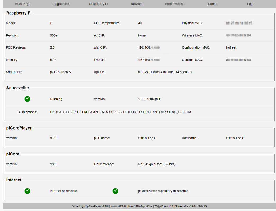

Moode looks pretty nifty.... what if my Pi is only 256MB? What's the latest release that could deal with that?
pcp, lms and squeezelite, huh? that sounds like a lot of work, but I'll take a look at that too!

I may be wrong.... but....
You need to have a Pi1 rev 2.0 with a P5 header to have I2S. Happily, I think that means it's 512MB too. If you've earlier than that, it's USB or audio jack only I think.
It's been a few years though.

So the O/P's board would be 512MB
Your memory serves you well !
P5: 8-pin (2x4) 2.54 mm header expansion (header not fitted), on the bottom of the board, providing: see Low-level peripherals (Model B Revision 2.0 and Model A boards only)
4 GPIOs at 3.3 V
3.3 V, 5 V and GND supply pins
Second I²C interface (3.3 V) (if pins are reconfigured in software)
I²S interface (if pins are reconfigured in software)
Handshake signals for the UART on the P1 header (if pins are reconfigured in software)

Yay! I didn't realize there were 2 revs of the Pi 1 B.
Now I've just gotta buy a couple more SD cards so I can try these other options out. The guy who I inherited the pi and hifiberry from suggested Pi Musicbox so now I've got a couple options to compare it with.
