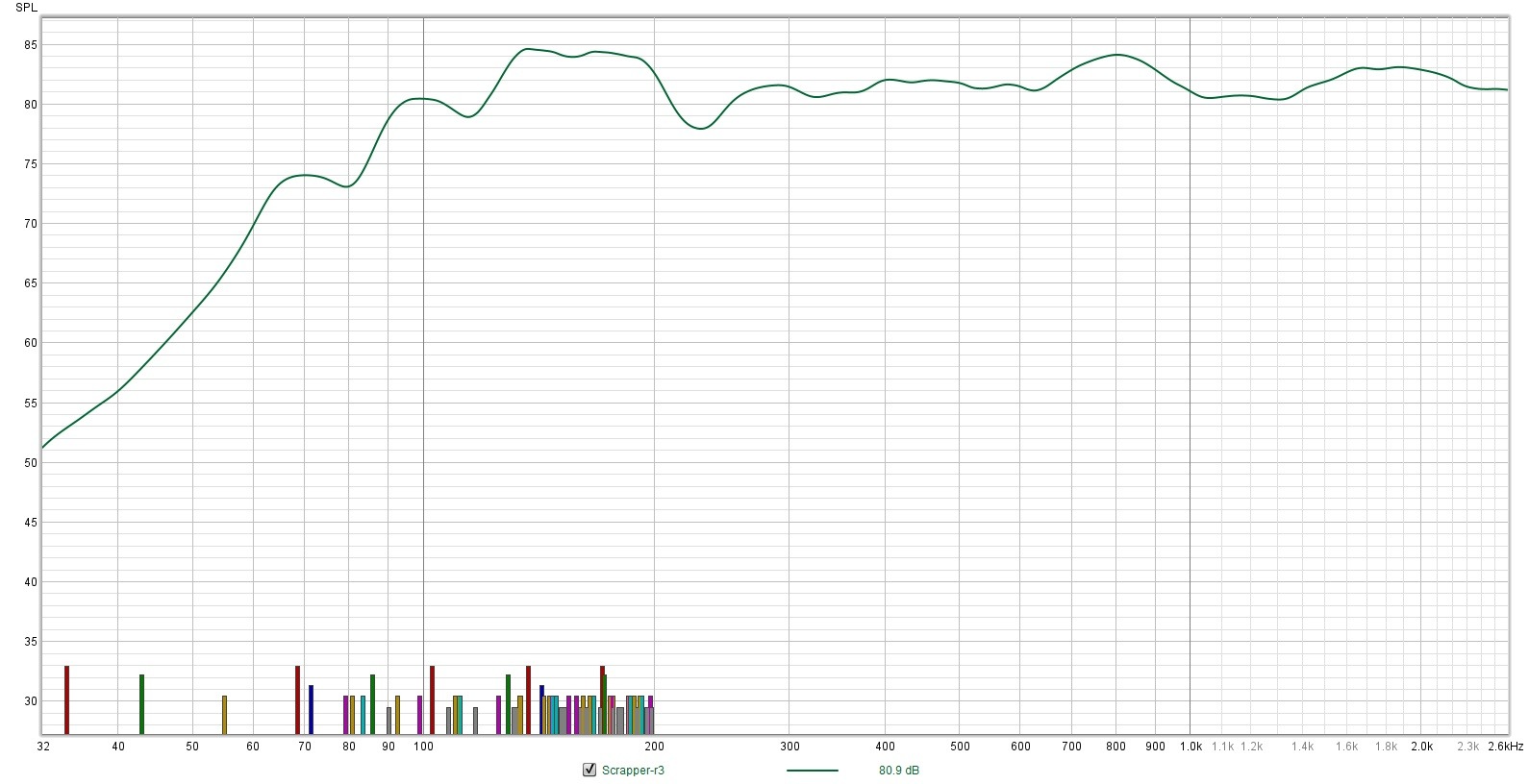

Might be able to use this one in a 2-way; it has a built-in BBC dip.
Does it basically sound alright just playing full-range with no XO?
It sounds fine and I have decided to make a two. Any suggestions for a tweeter? Something in the $50.00 range.

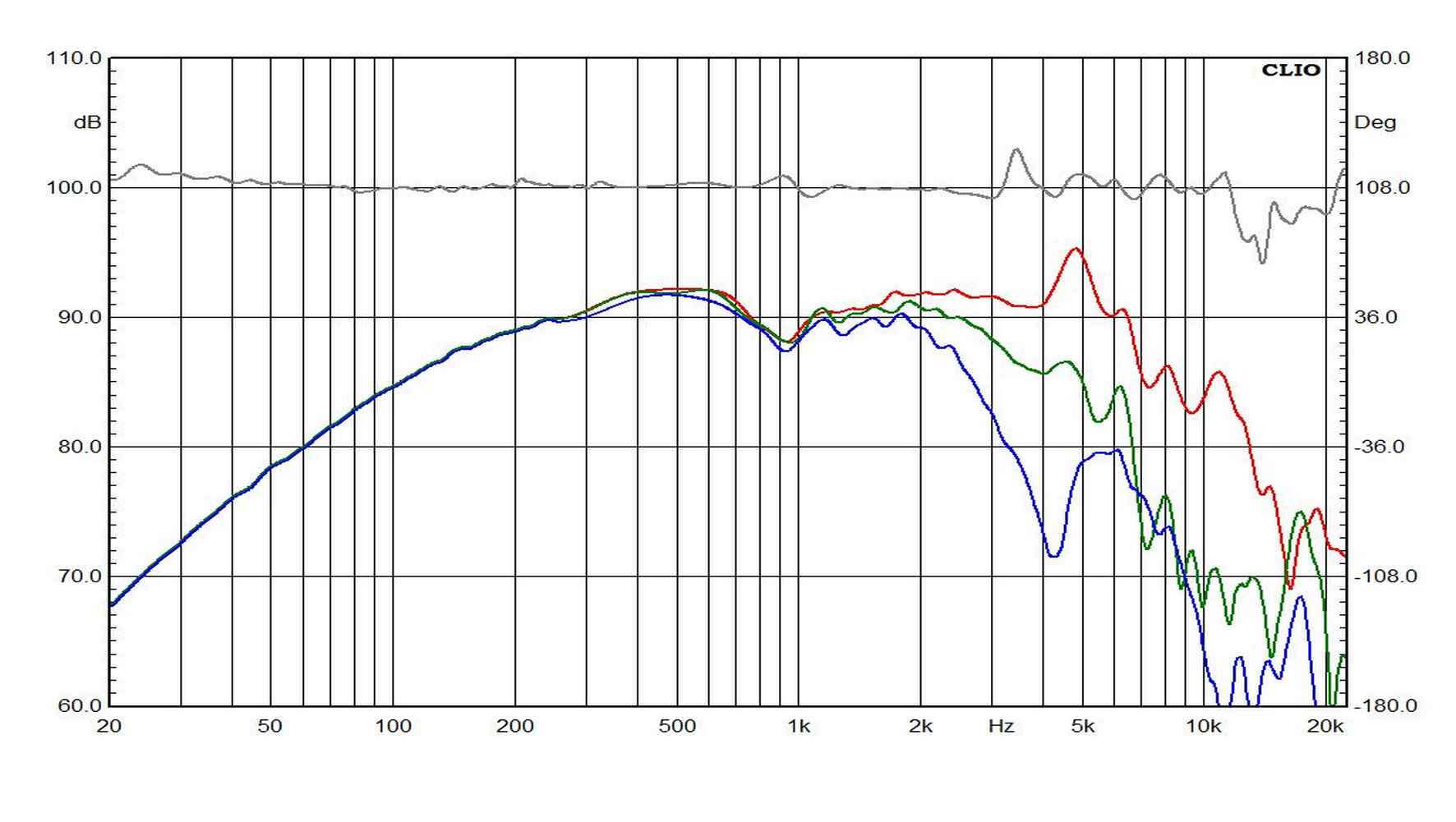

Horn solves acoustic offset, though it will need padding
Tested here https://heissmann-acoustics.de/en/test-scan-speak-discovery-h2606-920000/
He suggests it can go as low as 1.5khz and uses it in a design with an 8" crossed at 1.8khz LR4
https://heissmann-acoustics.de/en/suzie/
Probably a good ballpark that translates to the HM170.

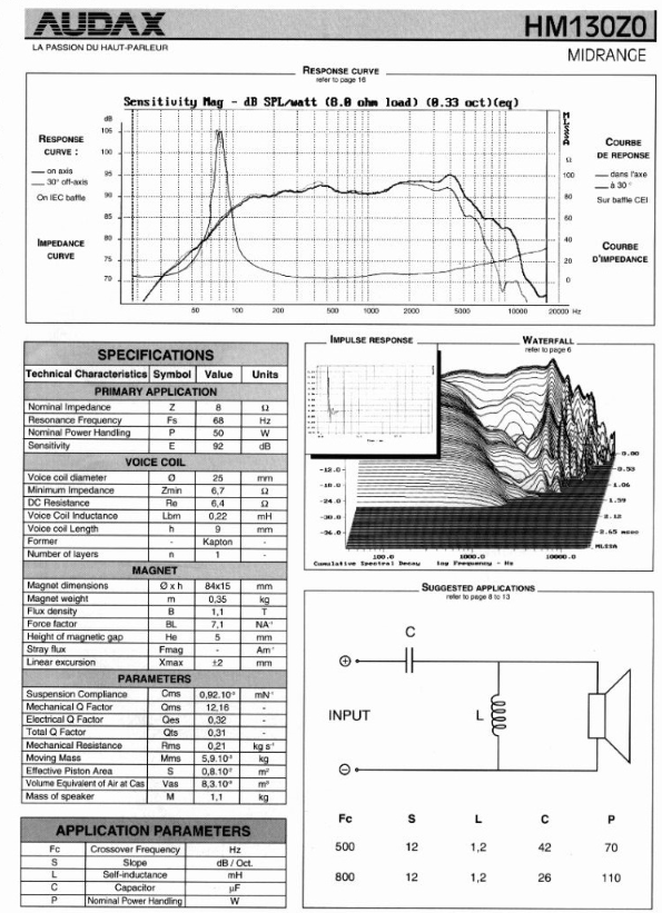

HM130Z0
http://web.archive.org/web/20081111194530/http://www.hautparleur.fr/_audax/kita851a.jpg
http://web.archive.org/web/20081111031959/http://www.hautparleur.fr/_audax/kita851b.jpg
