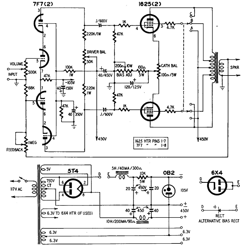

I believe that the MacIntosh Amps used a cathode winding coupled to the output transformer. It was considered to be a major break through because it allows the tube grid currents to keeps the OPT core flux from going to zero. This eliminates crossover distortion.
All of this is explained in MvdV's supplement to his book. The transformers are better designs then have been available for years. If you are interested in cathode coupling they are the only option. That doesn't mean that the MvdV Amp circuit designs are the best possible. He recommends many things I would do differently. This probably means that It should not be a first amp, or if it is, you should be ready to change things. These devices are 1. Expensive and 2. Potentally lethal. MvdV explains that the ul cathode coupled design is limited by it's voltage drive requirements.
I personally would copy an old Mac design using the Plitron transformers and other modern components.

Hi Thomas,
Where might I find this supplement? Is it actually in his book, or elsewhere?
Your idea of (legally) copying a Macintosh design sounds promising. Could you give me any pointers on specific designs? (And then I'd pester you on modifying them?) :angel:

As to an amp you might look at Allen Wright's amp ... with 4 KT88s or 2 509s (i think it was these 5xx somethings anyway-- Allen was talking about 4 tubes for 100 W to drive some new ESLs he'd fallen head ove heels for) you should be able to get 50 W or so.
It uses the cascode differential front end (his twist on stuff HP used in test gear) and a Class A triode wired output stage with a CCS on the cathodes. Allen publically revealed the circuit at the most recent VSAC (the reason why is an interesting story in itself). Allen has only found one other amp using similar tricks -- used in a atomic electric plant (what for i don't know), but he will be the 1st to admit there is little new... he hadn't seen the precursor to his amp pictured (from 1956 Radio Electonics). Take that amp, wire in triode, bias into class A, add CCSs at the bottom of both differential sections, a super reg on the cascode, no feedback, and you have the essence of his amp.
It is available as a kit if you don't want to tackle all the fine tuning he has done over the last 6 or more years.
dave
As I said above, that's an intriguing idea.
I did a little Googling around--is this the sort of thing you had in mind? :yikes: 😉
Just checking--I like your idea, but just wonder if there might be a simpler version.
Thanks again--because of help from folks like you, I am beginning to get some ideas on how to begin what I hope will be a long and fun journey. :usd:
