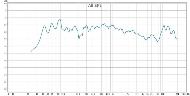

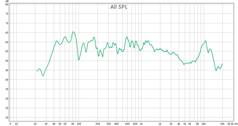

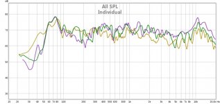

I wonder if anybody has any suggestion on the basis of the attached smoothed (1/12 octave) in room response taken with REW. The first picture plots the on axis response for the right and left speaker (green and purple) at 1m and the joint response at the listening position (ocre). The second picture is the average of the three.
The response looks rather good to me. I am just wondering whether the peak around 80hz suggests to increase the amount of stuffing or whether it is typical.

If you made your measurements in-room, anything below around 150hz cannot be really trusted, room modes play a bigger in this frequency range.
Anyway, try reducing the stuffing and see if you get some of the male vocals back

I certainly found that my Pensil7 build (A7.2) needed somewhat ( 1/3?) less than the suggested amount of stuffing to elicit the tonal balance that worked for my room/system. They're currently running on a Denon HT receiver, XO'd at 110Hz, and I've yet to be interested enough to get someone who cares and has the appropriate gear to take some in-room measures. In any case, the Audyssey calibration / EQ probably helps out in that respect.
Assuming that your enclosures have easy access, I'd play with removing a small portion of the fiber, and teasing out the remaining.

To Hajj: the fact that the peak shows up on both speakers and with the mic in three different positions made me hope that it was not a room mode.

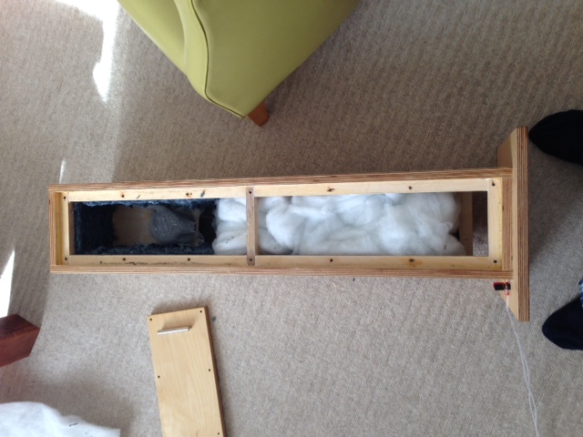

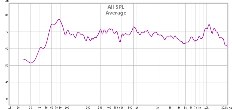

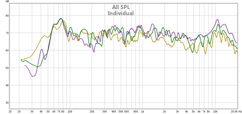

As promised here's my update.
It turns out that the version measured above had 200g of stuffing.
I have teased out the stuffing more as suggested by Chris (see picture) and I have first taken out and then added 50g of it. I have measured and listened. Both 150g (green plot below) and 250g (blue plot below) sound to me and measure better that the original 200g version. I conjecture that the stuffing in that version had not been teased out enough.
Of the two I prefer the version with 250g of stuffing. After some more listening, I might even try 300g next weekend.
