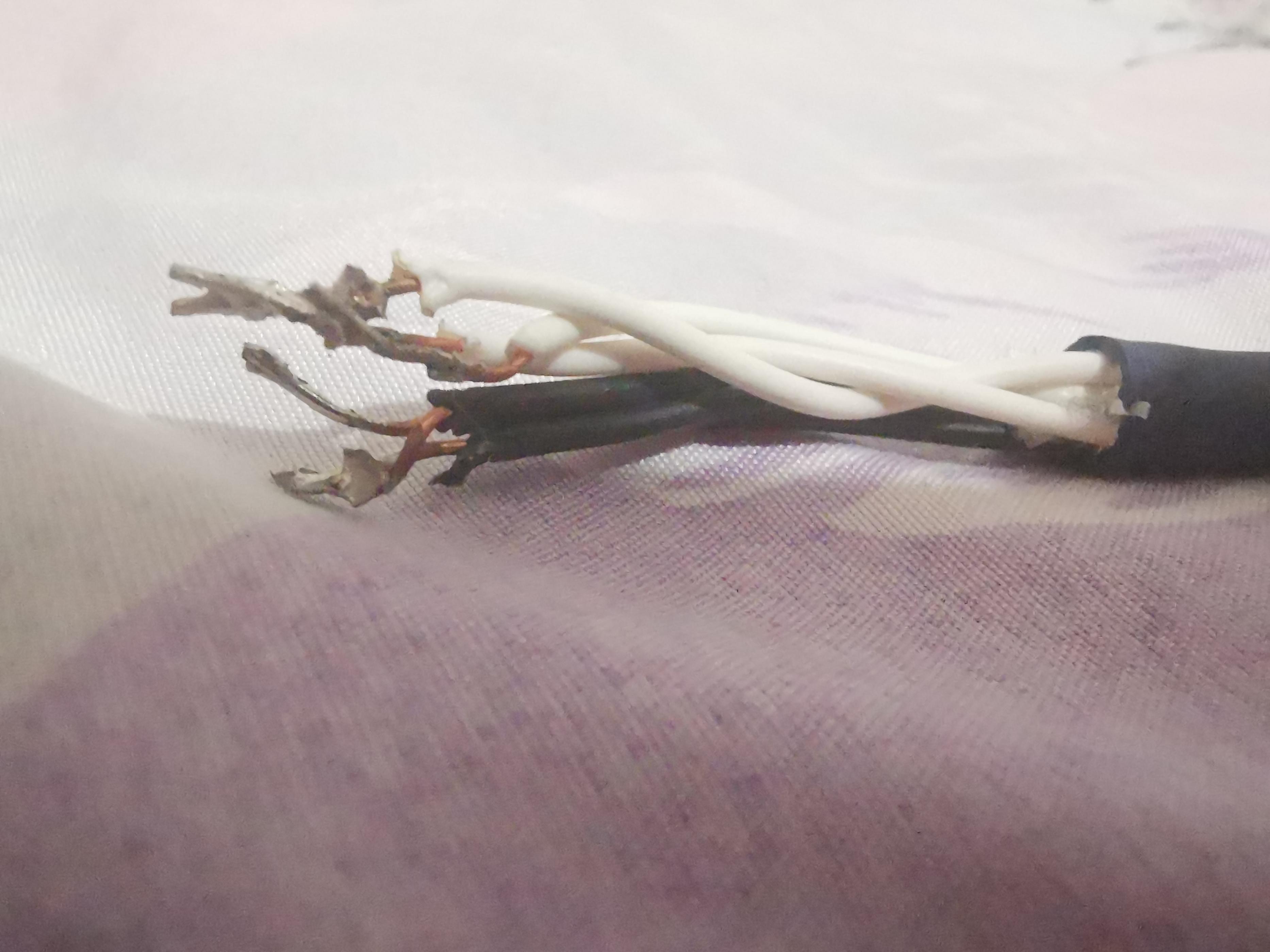

I need your recommendations on internal wire between those two.
Is there a path that I should follow?
For example use the thicker(at least I think is thicker) van den hul for the woofer and the evidence solid core for mid and tweeter?
I find very few info on the evidence solid core wire but it costs double the money, so I guess this is a sign that is superior or something?

The Evidence is not exactly solid core, quote: "Three audio optimized conductors (20 awg) are joined together for positive, and three for negative in order to lower resistance."
I would use the heavier cable for the bass driver, but use the lighter cable for the mid and tweeter to avoid mechanical stress on their terminals.

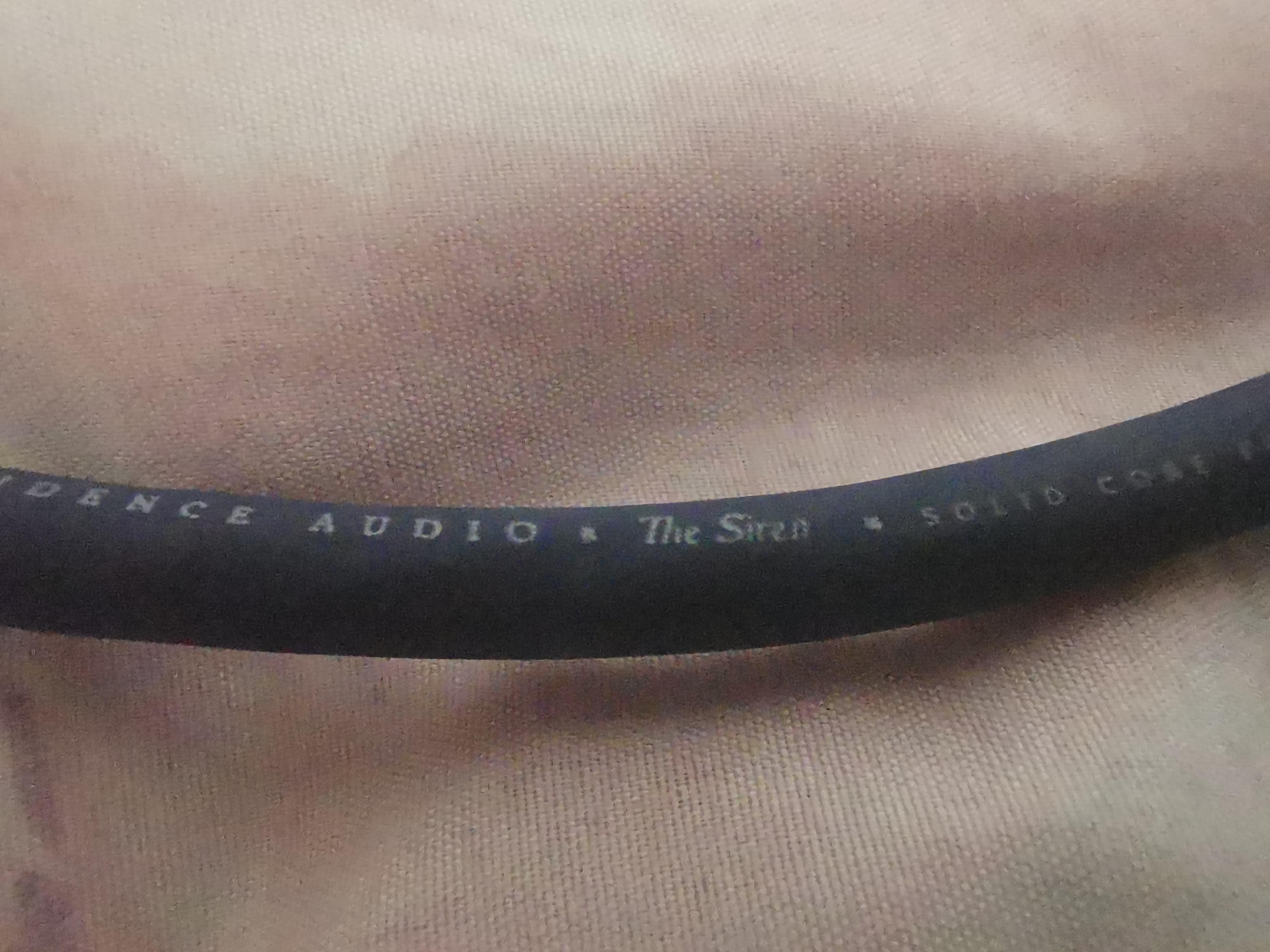

On the side of the evidence cable there is printed solid core for solid sound made in USA. Is seems very solid to me, but three independent solid wires.
Yes, I understand that and my recommendation stands from a mechanical point of view.
I am not of the persuasion that solid core is better than stranded in the electrical sense in the context of a short length of internal speaker cabling. Others will disagree of course! 🙂
