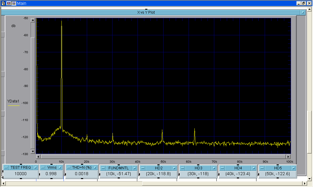

Here is an example of the dynamic range (thanks) output from the HP3562 down to it's apparent noise floor. The input signal was generated by an Krohn Hite 4402 at a level of .998Vrms (as measured by the HP8903A and as close as I could adjust to 1Vrms), nulled to -51db by Dick's Twin _T; the THD+N of the HP8903A reported at .0018% with the 400Hz and 30kHz filters turned on. The spikes at approx. 48kHz and 63kHz are environmental noise, not from the KH4402, but, to my knowledge are a part of the HP8903A THD+N calculation.
Ken

... the THD+N of the HP8903A reported at .0018% with the 400Hz and 30kHz filters turned on. The spikes at approx. 48kHz and 63kHz are environmental noise, not from the KH4402, but, to my knowledge are a part of the HP8903A THD+N calculation.
Ken
You may want to try disengaging the 400 Hz HP filter unless you have a lot of 60 Hz hum causing erroneous results. The 400 Hz filter adds 2 op-amps and many passives into the signal path prior to the notch filter, so any noise and distortion created by those parts becomes part of the measured THD+N. The 30/80 kHz low pass filters are after the notch so they can't cause nearly as much harm.
As you suggest, any noise such as the 48 kHz and 63 kHz spikes will become part of the measured THD+N. By observing the monitor output of the 8903, you can determine how much contribution they make. I use the FFT of my digital scope; your spectrum analyzer is much better.

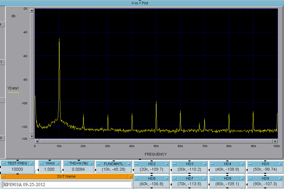

Regarding the settings, I went back and looked (all the settings are built into my VEE script), the 400Hz high pass was turned off and the 80kHz low pass on.
This morning I ran a 10kHz 1Vrms output from the 8903 through the aforementioned setup and got the following results. I would tend to believe that the 50kHz spike is abnormally high due to environmentals.
Ken

Ahhh, I see.
The main diff is lower noise floor in the analyzer, and balanced input... plus the onboard filter switches...
