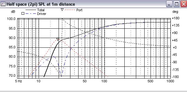

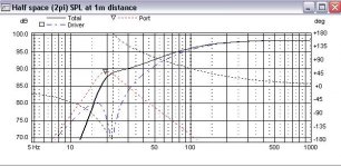

The woofer he is using has Qtc around 0.3 so it is possible to have sufficient gain from BR. Tuning is also low. Resulting in a shelf response that he is EQing flat.
The site seems to have lost all pictures that backed up his article.
Edit:
Here's one sim i made with JBL 2226 in 220L box tuned to 22Hz. Not impossible to EQ flat.
