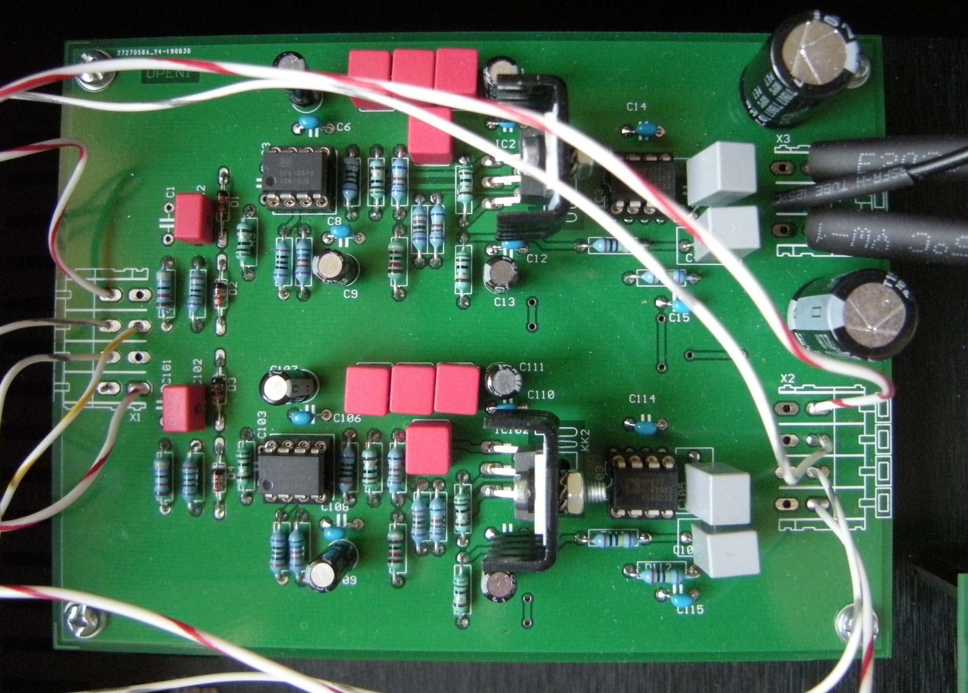

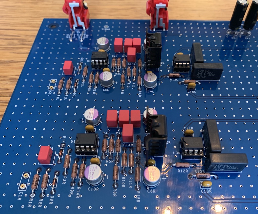

I just built one of these on my own PCB. The sound is very detailed ... best bass I have heard on any phono stage to date! I would describe it as very transparent with no coloration of the sound at all. It is VERY sensitive to proximity of the power supply however. The current PCB has a 3-pin DC power jack so I can use a remote chassis which will be necessary.
It should not be. With the original double-side PCB with top ground plane it is pretty immune to power supply proximity.
I had it sitting on top of an HP dual lab supply with just a silicone pad and it hummed pretty bad! I moved the HP supply below the wooden shelf from the preamp and it got much quieter! It is not in any enclosure yet either, just a PCB with some leads hanging off of it with jumpers to the PS.

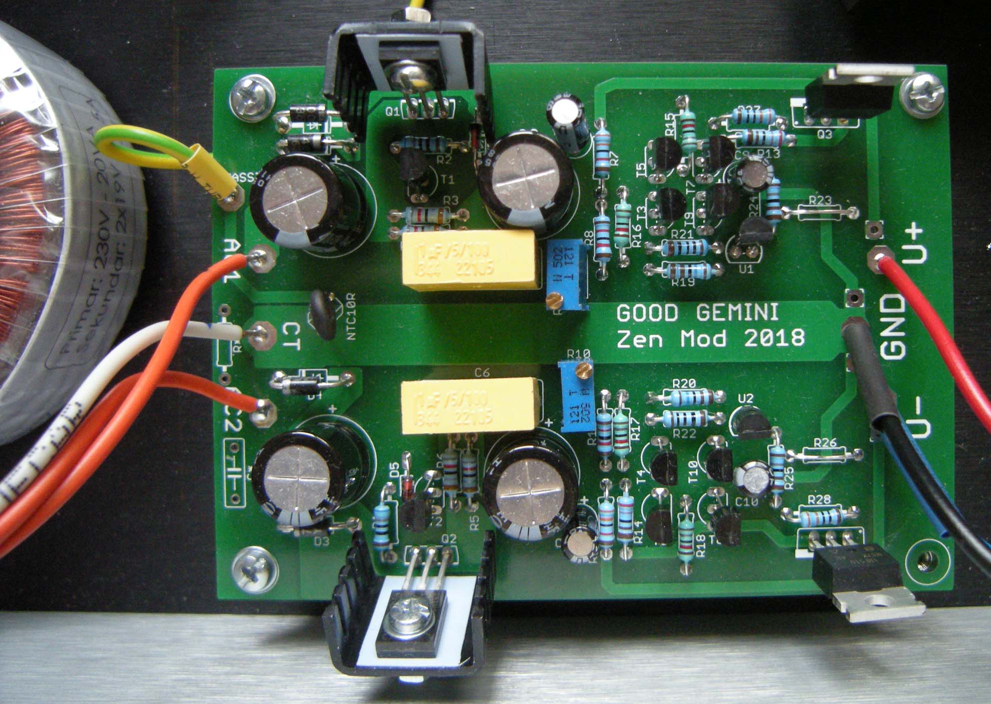

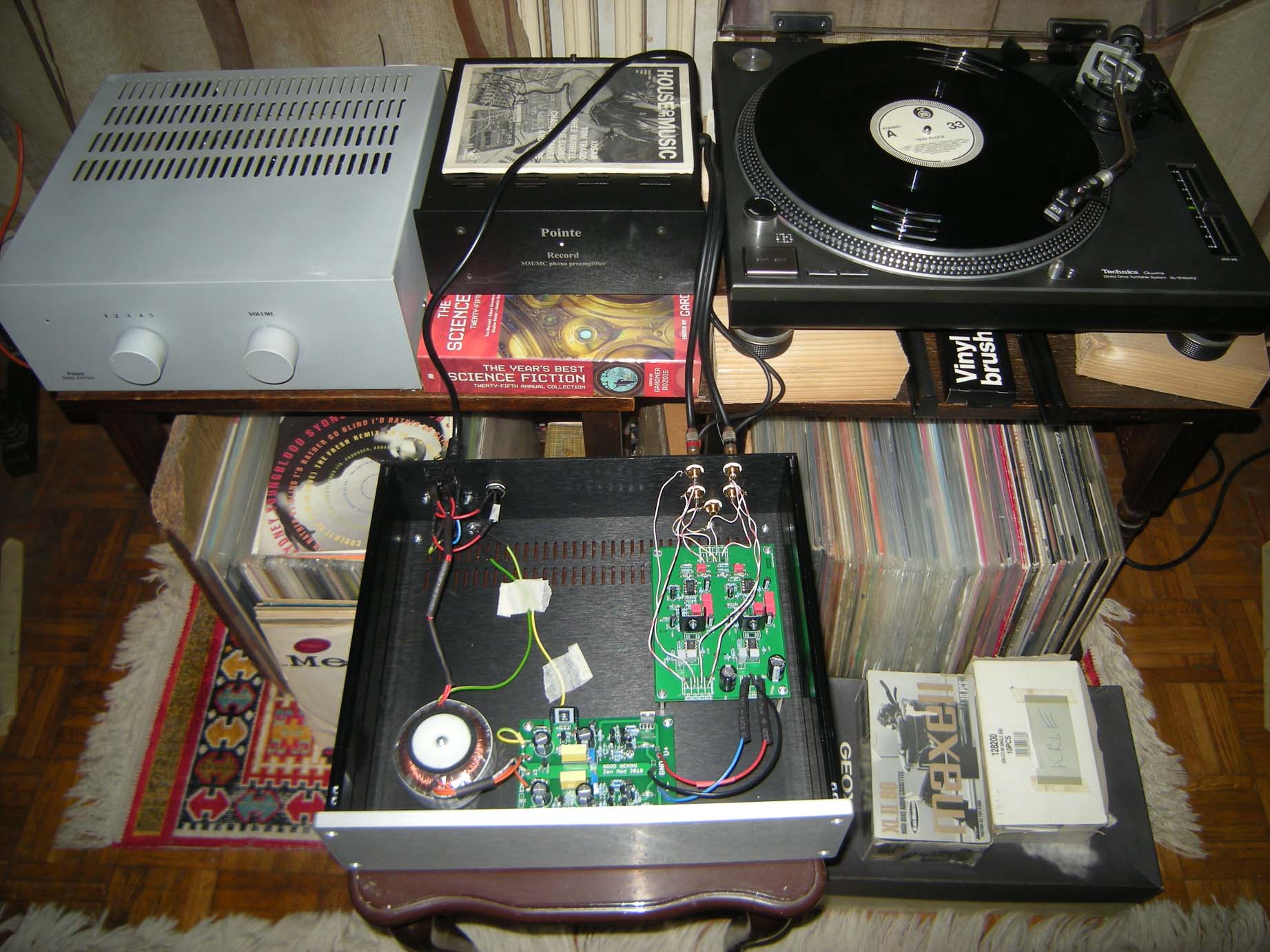

Hello krca45,
Nice work. You made a wise choice in making this phono amp your first project. Can you describe your power supply? I am not familiar with it. I assume it is a shunt regulator.
This phono amp design, in my opinion, is outstanding. As others have stated, the low frequency “weight” is excellent and it easily powers (in my case, 32 ohm) headphones.
Hello
PSU is shunt regulator with mosfet IRF9510 / 510 as shunt element on the output. Uses BC546 / 556 & BD139 / 140 transistors & MMBF5486 smd jefts ( on the downside ).
Good Gemini by Zen Mod, You should be able to find him on various Pass amplifier builds.
Schematic can be found in Iron Pre preamplifier, it is a part of it, Pass section.
Regards, Krca
Some pics of phono & regulator pcbs ( did not twist in-out wires, eventually will do ) - after Gemini regulator, on the phono DC inputs - are resistors ( hidden ), to make RC filter ( with existing C 470uF/50V element ).
