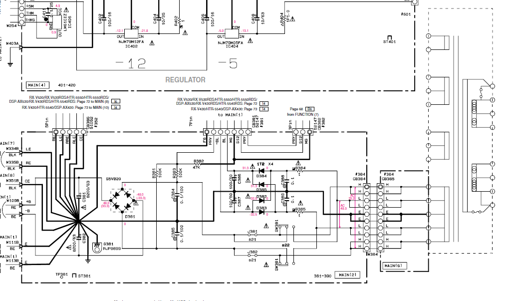

I have a Yamaha RX-530 stereo receiver that has an open power transformer on the primary (the big one). I am hoping that someone might be able to measure the secondary AC voltage going to the power amplifier so that I can find a suitable replacement.
I do have a transformer that is a bit bigger and has a secondary voltage of 26-0-26VAC and another winding with something like 16VAC (for tuner, preamp and lamp). Is this too high of a voltage?

26vac will get you around 40vdc. That would be good for most chipamps.

That is allot more voltage than I expected! 48V cuts pretty close to the max rating of the capacitors. When I look at how big the original transformer is, it really seems undersized for what the amplifier requires. The one I have is a bit bigger even though it has lower voltages, so it will most likely perform better even if there is less output.
Thanks for the info sajti, it is very helpful to know as I can now test the amplifier, the power supply schematic will be useful as well, I might change some values. I will also take some pictures and post them at some point.

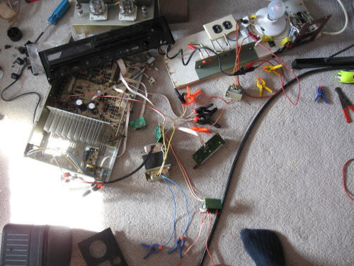

I actually got the receiver to work of the 26V-0-26V transformer and I found a 12V-0-12V for the preamp and tuner section. The entire thing worked without any problems.
I would however like to have the schematic for the Tone control/Final stage of the receiver as I would like to experiment with using a tube in place of the op-amp in the final stage. I have pleanty of spare windings on the power transformers and lots of space to wire a 12AU7 tube to the circuit board when I remove the op-amp.

If you want to "repair" your old transformer it is probably not as bad of a job as you think. The thermal fuses are not real practical to wind in so they place them right under the lead pads. However, you will normally have to desolder the copper shield if you want to re-use it, and there is of course some minor surgery involved to resect the fuse. It would then be entirely your responsibility to make sure the transformer doesn't help introduce you to some local firemen.
